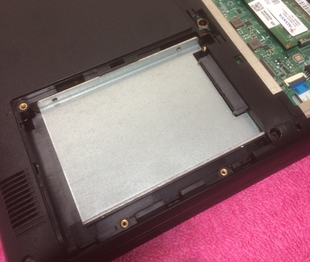

I have an Acer ASPIRE ES1-432 Laptop. Started off with about 29Gb of memory which has been steadily dropping down to around 2Gb. I have since been educated that I in fact only had a 32Gb Flash Drive installed, which I verified by opening up the machine & seeing that there was in fact no additional hard drive installed.
The Flash Drive is now about 27.5Gb used, & the relatively small memory was not a big problem until the Windows updates kept telling me that it needs 8Gb, which I do not have! So I now know that I need to update!  The machine is already basically running a SSD in the Flash Drive & I was impressed with the performance. I therefore prefer to add an SSD, & after some research I believe it will be a Kingston 2.5" SATA III Solid State Drive 120GB.

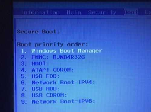

I found out how to access the BIOS....it seems the F2 or Del option doesn't work on Windows 10 so I have to access via the Settings menu (I found this link:
https://www.laptopma...os-windows-10).Tried it a few times to get used to it......all good.

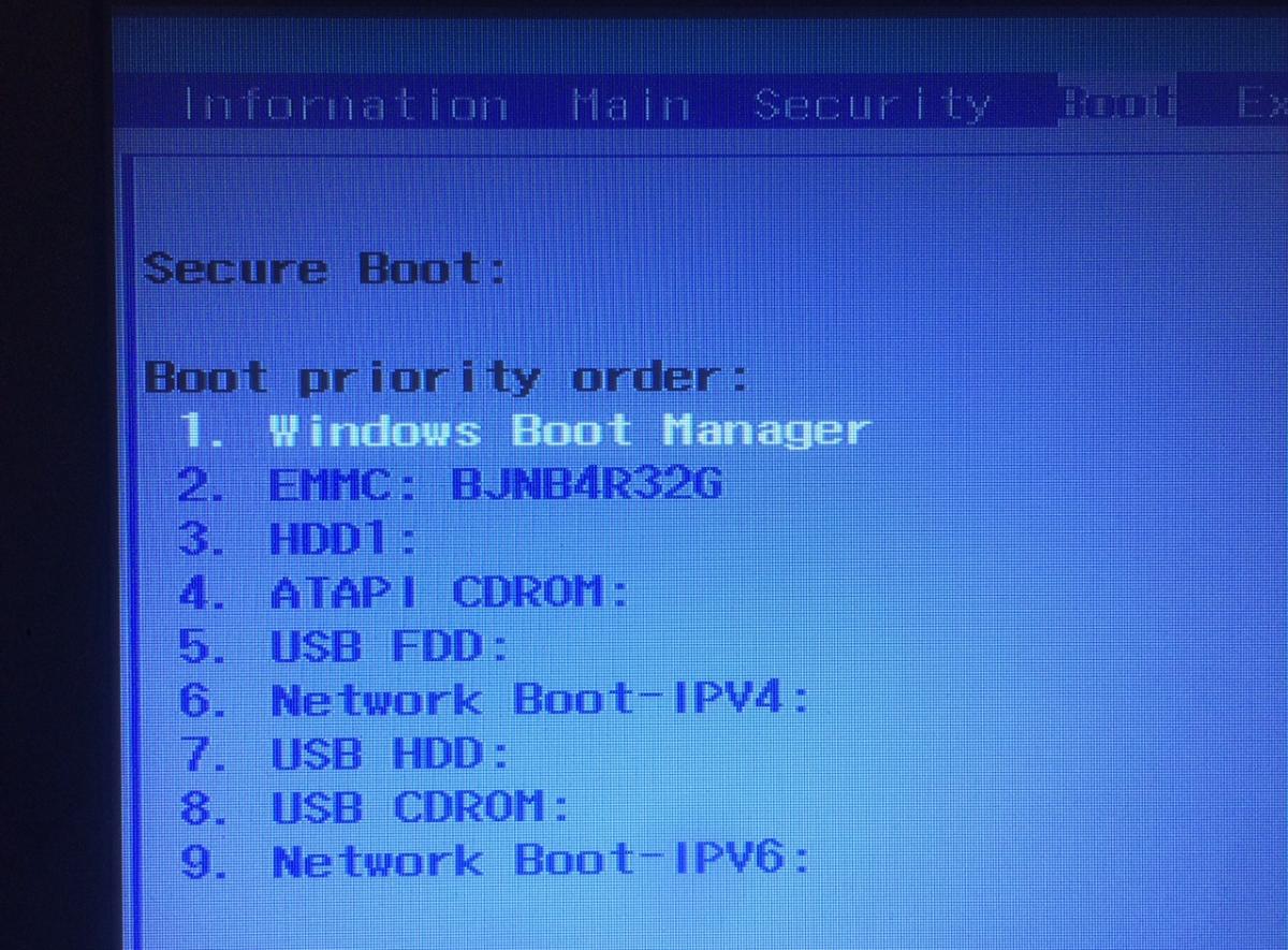

System currently booting from eMMC (my 32Gb 'Flash Drive' I understand) Pic below....
I am assuming the SSD will not have any cloning software on it (but I will see), so I will plan to use the free Cloning software you recommended earlier from EaseUS.
Question: When you say, 'install the cloning software and do the clone (I prefer to use the Rescue disk)', do you mean that the cloning software will nominate the Rescue Disk as an option to be cloned?
Question: Once the SSD is loaded with the 'clone', I will access the BIOS & I assume the machine will have now added the SSD to the list, so I will place it after the "1. Windows Boot Manager". What happens to the former 'eMMC Flash Drive'? Should I be thinking about formatting it to get some additional 32Gb of memory?......or is it just ignored by the machine on boot up?

Yes that is another option when the system works ;)  There is a key for sure but sometimes is difficult to find the exact time to press it because the machine/OS boot very fast.
No the SSD will not have any cloning software ever, some manufactures provides software for free that you must download and install, it is not on the drive.
The Rescue Disk is an option on the software that creates a boot DVD or flash drive containing a "mini Windows" called WinPE and the cloning software that can be used to start the computer when the Operating System doesn't work or you want to do a backup/restore/cloning task without interference of any other software.
https://www.easeus.c...table-disk.html
The image of the BIOS you post seems to indicate that the machine is set to UEFI mode and the boot is looking for the drive that have a valid Windows Boot Manager...
I'm not familiarized with that situation! I think you should try to to the clone and then change the boot order to HDD1 (it should show reference to the installed SSD) if it boot OK then you can use windows to delete all the partitions on the eMMC, create a single partition and use it for storage (for Temp files, etc.) after doing this you can try change the BIOS back to the Windows Boot Manager option to see if the machine starts ok from the SSD.

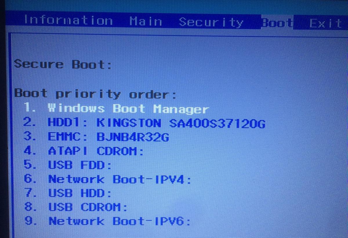

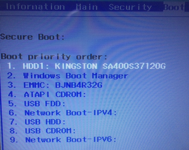

The clone went well & I altered the BIOS setting to have the Kingston SSD before the existing eMMC.......but I am sure the machine is still booting from the old 'C' drive & not the new clone 'B' drive.  Copy of BIOS setting is below :

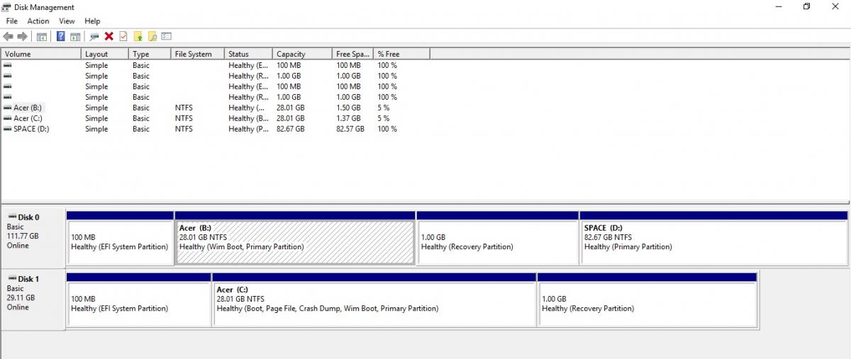

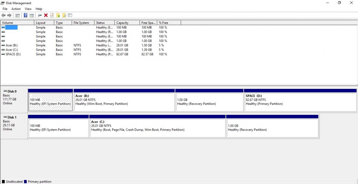

On Disk Manager it shows the SSD with the clone 'B' as slightly different properties from the original 'C' drive. See below:
In addition I notice the old 'C'd rive still has the little Windows icon next to it.......which I assume means it is still the main drive...?!   See below:

On the BIOS Boot priority Order try to put the HDD1 as first boot option instead of Windows Boot Manager. See if the OS starts that way.
Post a new screenshot of the Disk Manager.

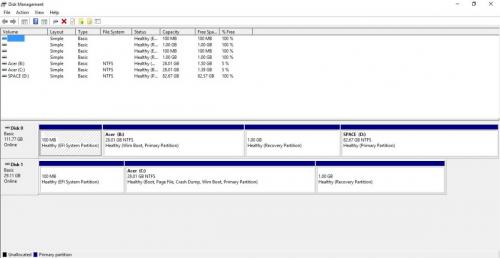

Done & machine starts up still fine, but Disk management & the little Windows icon position against the original 'C' drive are unchanged.

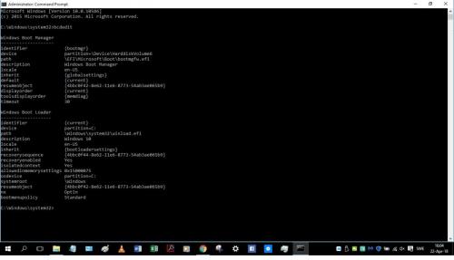

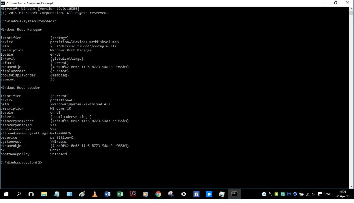

Did some more digging online & realised that I could access the Windows Boot Manager (WBM) file via Command Prompt. Below is what I have currently:
To quote The Vulcan, is it not logical that the WBM text under Windows Boot Loader is telling me that it is booting from the device Partition C......which is my 'C' drive?  Current disk management snapshot below:
So if I modified the WBM to boot from device Partition B (& modify the entry also for os device to Partition B) then that should then make the SSD (Partition B) the bit that runs Windows.......??

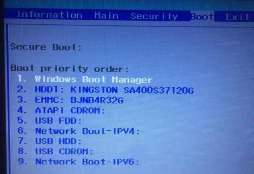

Then I should also reset the BIOS to have Windows Boot Manager is position 1 again, & SSD in position 2........?
Just wanted to run this by you first!........
