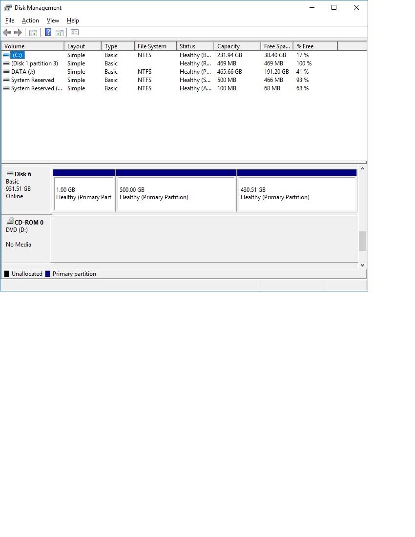

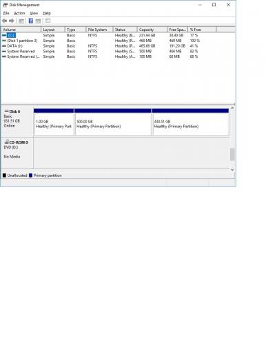

Drive J is my secondary internal HD and disk 7 is an external drive that I can't access.  I am running Windows 10 and am a little lost.

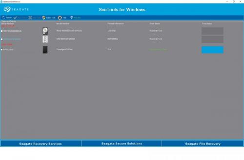

Are you talking about the following Seagate FreeAgent GoFlex USB drive. It looks like it has some bad sectors. Are you able to see the drive but cannot access it? Please test the drive as follows and let me know the results.
Please Download and Run SeaTools for Windows
1.  Once it starts it will scan for all drives connected to your computer.
2.  Select drive you want to test.
3.  Select the Long Generic Test under the Basic Tests menu
4.  When the test is complete you will see the result under Test Status
5.  The test will indicate either Pass or Fail.
6.  Provide the Results in your reply.

Thanks for the repies
The long generic test was 100% PASS
Phil, I was not aware of the antivirus issue.  I will uninstall the avira.
What is all the other stuff in red mean??
  • 24,569 posts
The other stuff in red means that the USB HDD is failing, are you certain that you ran Seatools on the right drive, a 1TB can take a long time to carry out the long test + the WD USB HDD does not have any identification letters either for the entire drive or the partitions that are on it, this in Speccy and in your screenshot of Disk Manager in your previous thread, both do though show that the three partitions on the WD USB HDD are completely empty.

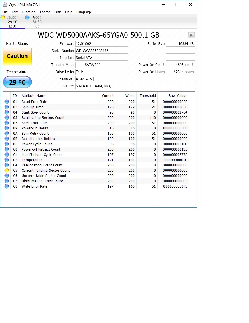

Download and run CrystalDisk info standard edition from here
Run the program, grab any screenshots and attach to your next reply for us.

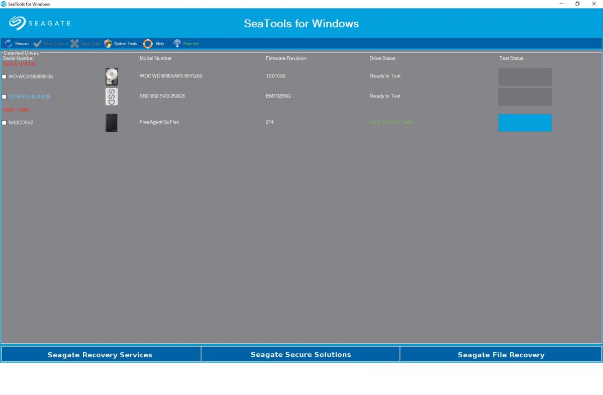

I ran the seatools test again and am attaching the screenshot....it only took 15 seconds which doesn't seem right...

  • 24,569 posts
You are correct, that is definitely not right and I suspect that the test only ran on a very small % of the drive, can you try checking the GoFlex with CrystalDisk and post a screenshot of the results.
You can see for yourself that the WDC WD5000AAKS-65YGA0 drive has issues, as you cannot access the drive through Windows I would suggest that you try using Puppy Linux, the details we can provide once we have taken a look at any results that you may have for checking the GoFlex with CrystalDisk.

As you can see CrystalDisk is also showing issues with this drive. I am not sure what th issue is with Seatools. Please Post the log file as follows: Click on Help > View Log File.

The WD drive is a slave drive and has my old OS as well as programs and docs.  It is drive letter J.....What I want to do is only have my OS on the SSD along with a couple of programs and then put all my other stuff on the other internal drive.  I will order another drive (1Tb) to replace the WD if it is bad.  I am attaching another file which shows disk 6 (goflex usb)  Why is disk J listed under the c drive?

Crystaldisk would not list the usb goflex drive to test it.
I am afraid it is toast, but I don't want to give up on the WD drive.
You appear accepting of the GoFlex being bad, any reason for that as in "do you know something that we don`t know" has it been dropped or banged etc
