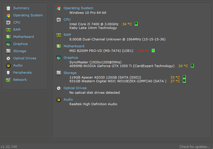

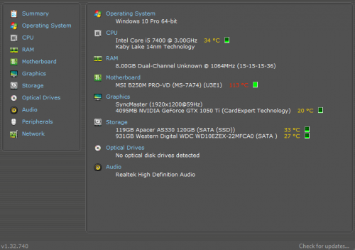

EDIT: I see my motherboard temp is way high? Is that an issue?

The MB temp is off the scales and we do need to check it, sort the dmp files for us and while we look at them you can do some other tests for us.
