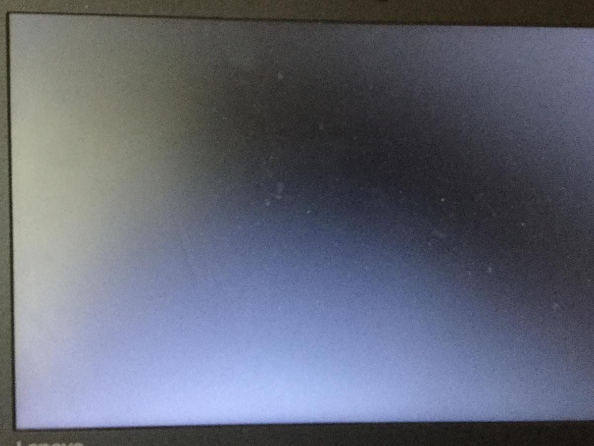

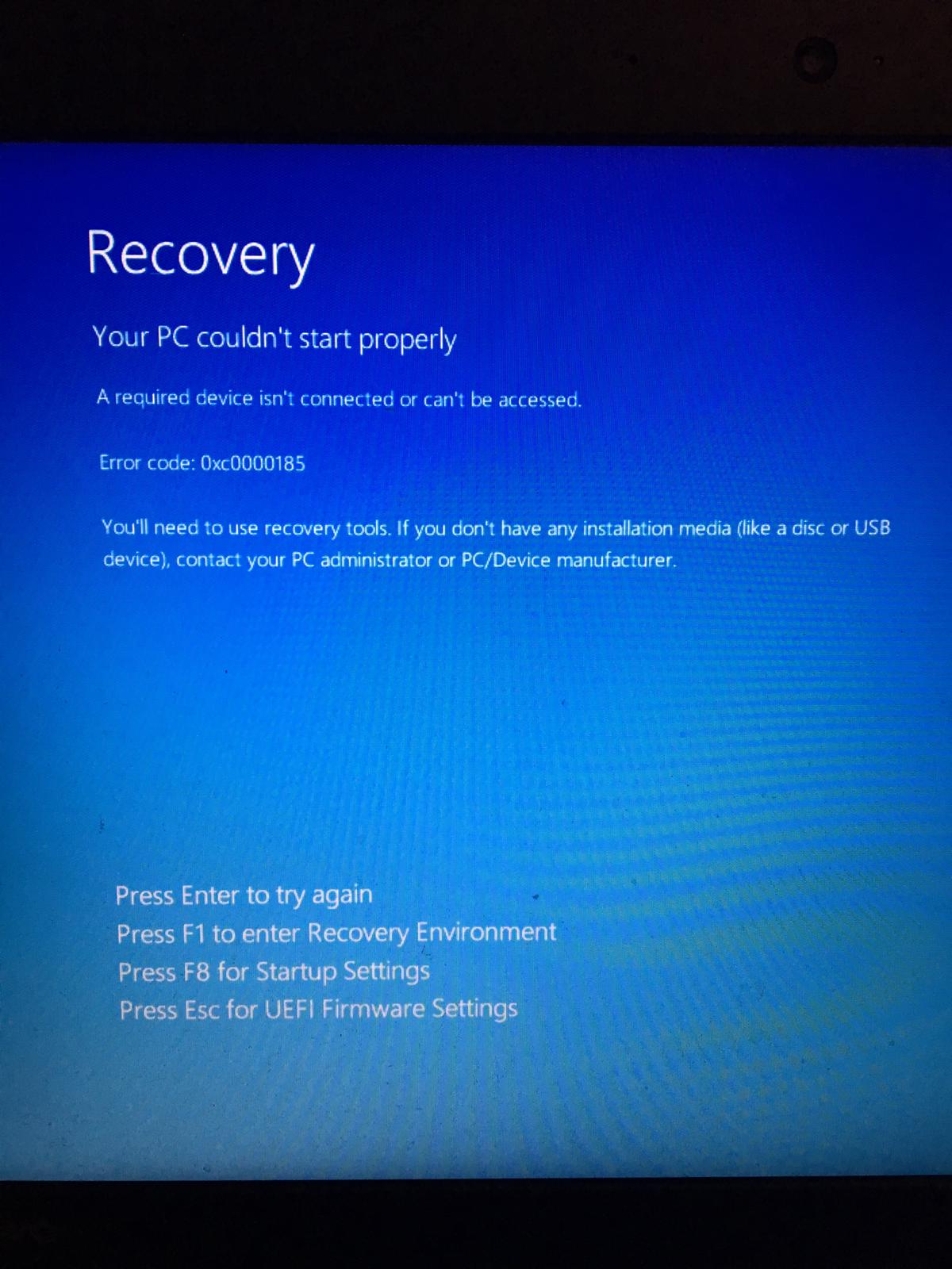

Hi guys, hope someone can help me? My daughter has a Lenovo ideapad 320, a couple of week ago she says it was going laggy so she shut it down using the power button. On reboot it went to recovery mode and booted to the blue screen with 4 options but I couldnt get past this. I eventually went on the Lenovo website and created a usb recovery pen booted to this and reinstalled windows 10. It was working fine until yesterday and it started lagging again this time she tells me she just left it and went back a bit later and turned it off correctly this time. Ive went on this morning intending on useing the usb to reinstall windows again, but I cant get the laptop to recognise the pen its just stuck in a loop booting to automatic repair and if I do by pass this by tapping f12 and select boot from usb hdd it just boots to a black screen! Any advice would be helpful.
Thanks in advance

Hi phillpower2,
I’ve tried this if I choose system recovery it just returns to the original blue screen posted or if I choose boot from usb it just boots to a black screen.
Any other ideas?
Scottb

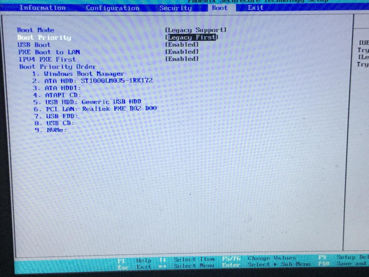

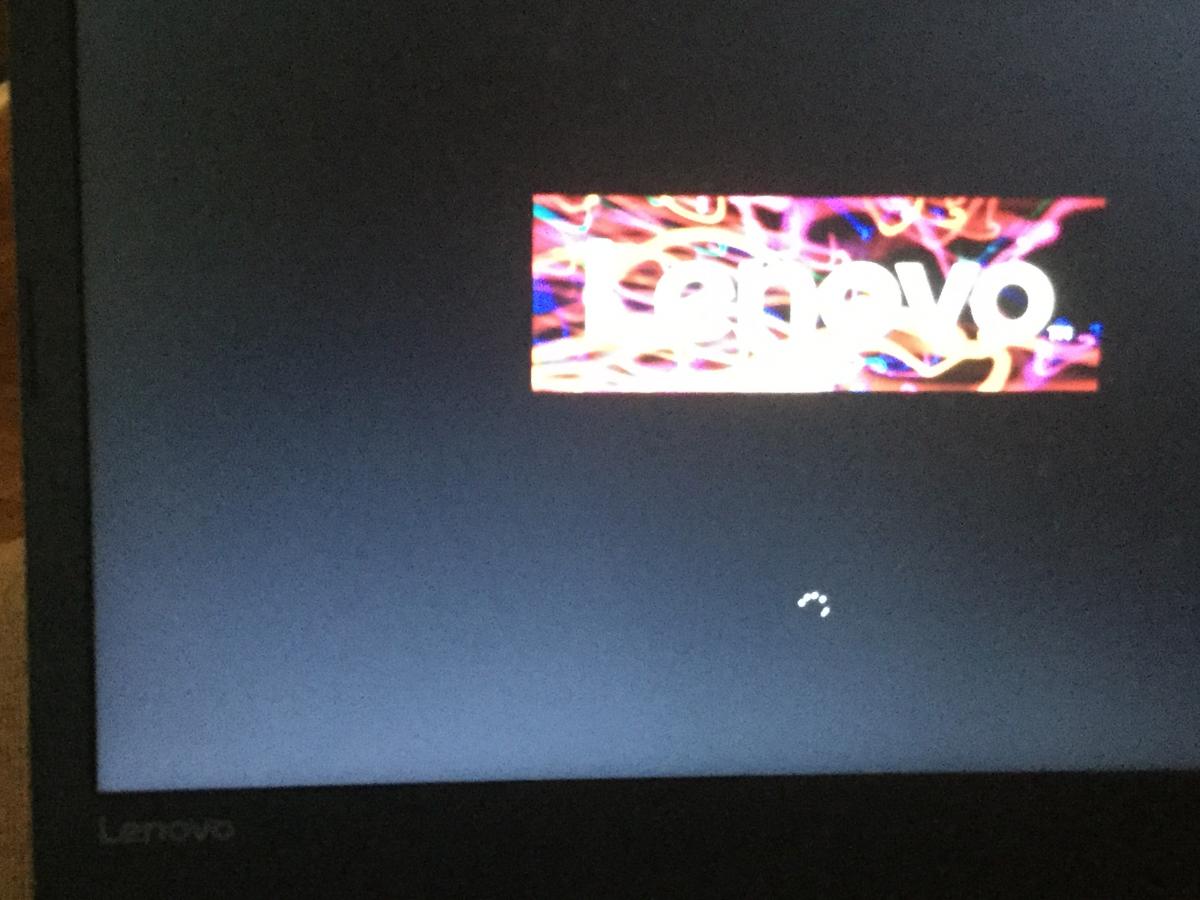

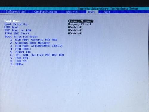

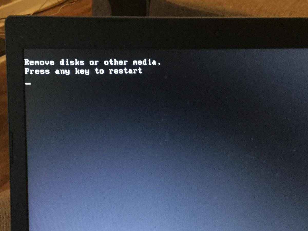

Thanks again for getting back to me. Im not having any joy even changing the bios settings. I dont remember doing this the last time I used the usb as a boot device, Lenovo have the f12 tap on boot up and it gives you a boot menu when the usb device is attached its in the option but just loads to a black screen.
I have done as you suggested in the bios my options were uefi or legacy device, I set it to legacy mode and boot priority legacy first. Saved rebooted but it just tried to load automatic repair page but never loaded just spins about.
I restarted again and tapped the f12 and chose the usb hdd option, now it loaded to a black screen with the message.
Remove disk or other media, press any key to restart.
If I press enter it just restarts and tries to reload the automatic repair page but it never does it just spins about until it shuts itself down. Im not sure what else I can do with it? The bin is becoming a very likely option! Ive attached photos of the messages received.
Thanks again Scottb
  • 25,039 posts
Hello Scott,
The USB device that you are trying to boot from needs to be the first boot device on the list, not the Windows Boot Manager as shown in your list.
Just thinking out loud here, have you tried moving the Seagate hard drive to number one on the list, saving the settings and then restarting the computer.

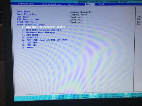

  • 193 posts

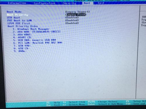

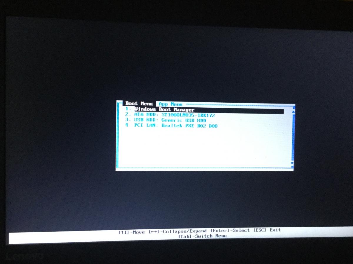

Hi Phillpower2,
I tried moving the usb to first boot and I just got the remove media and press any key to restart message when I tapped enter it just loaded to a black screen.
I also changed the first boot to the st hdd and its just loaded to a black screen with a spinning icon but nothing is happening. Its just restarted trying to load automatic repair again and loaded to the black screen no messages! Is there something that can help check the hardware in the laptop I'm thinking something faulty? Hdd, graphics?

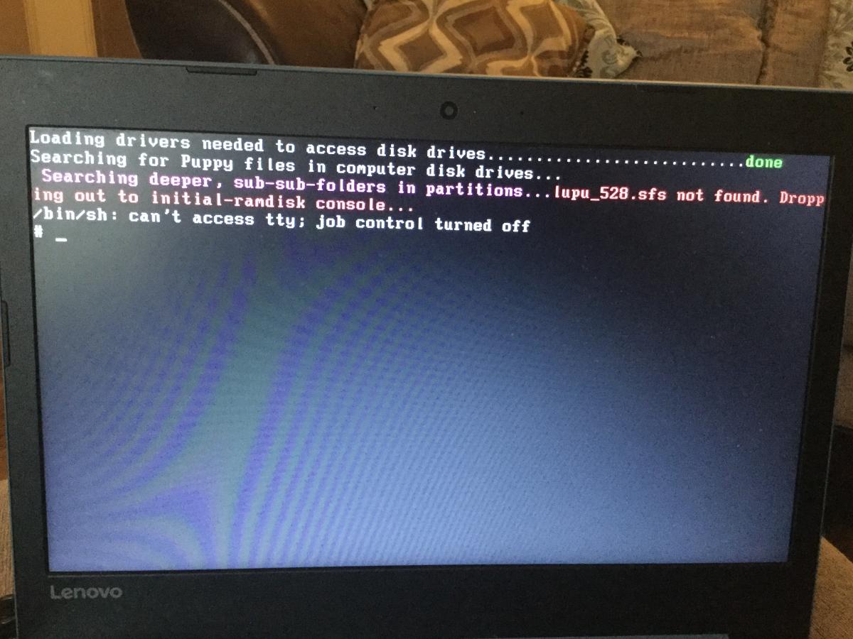

Hi phill,

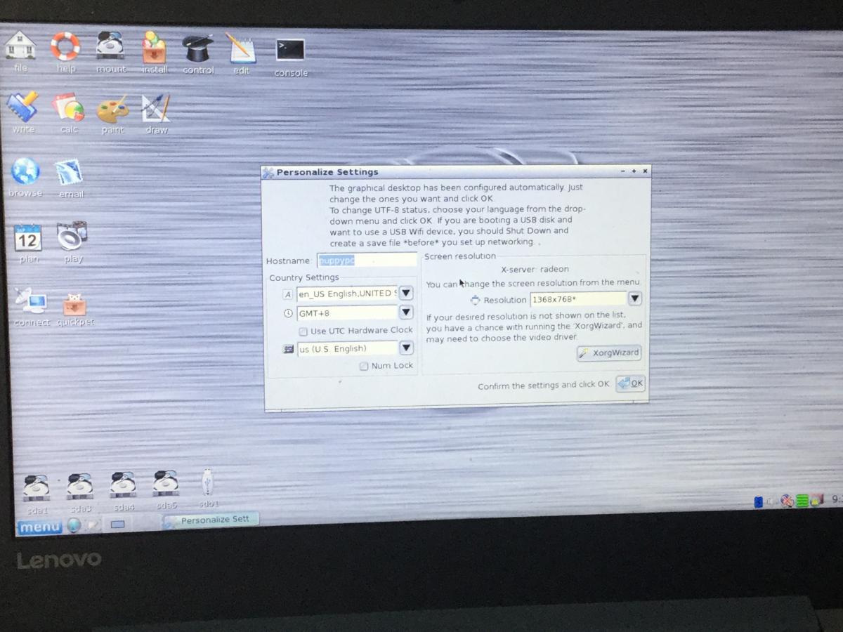

My daughters laptop doesnt have a cd rom drive so I followed the instructions for doing it on a pen and I dont know if Ive done something wrong or what but heres the message Ive got.
Does this mean anything to you?
Scottb
scottb
scottb

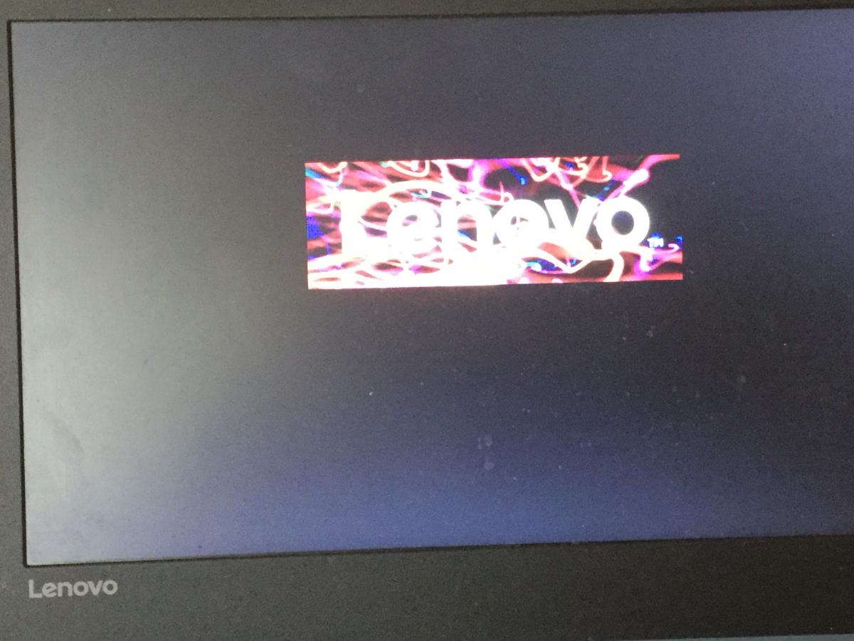

  • 193 posts

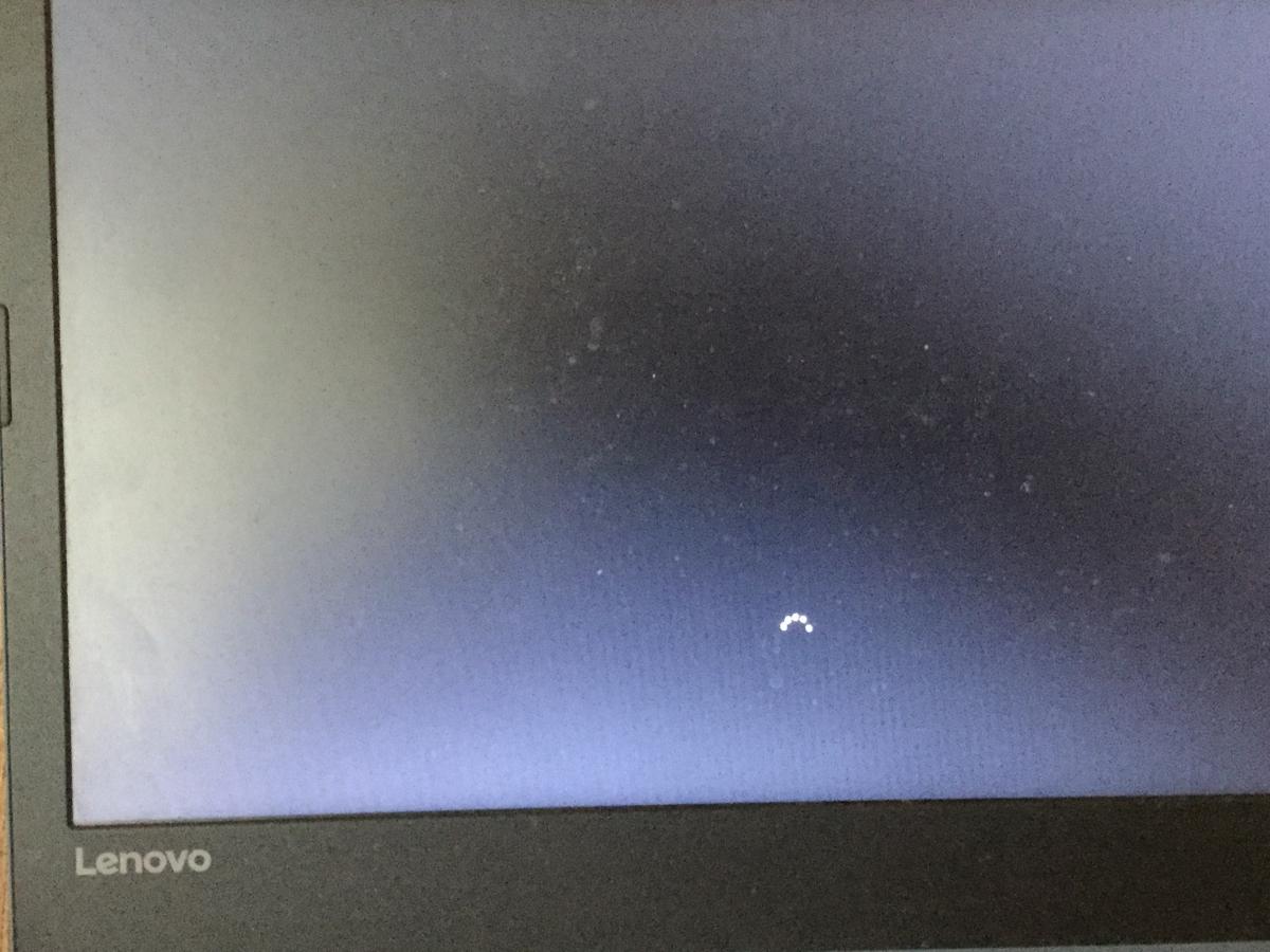

Just another wee update, on looking into the error message. I tried a different USB port and behold it loaded up. Unfortunately its now frozen on this screen the and the pointer/touchpad is non responsive..!! Suppose youve got to laugh!! 😂😂
Scottb
Edited by scottb, 30 January 2019 - 04:19 AM.
  • 25,039 posts
Do you happen to have a USB mouse.

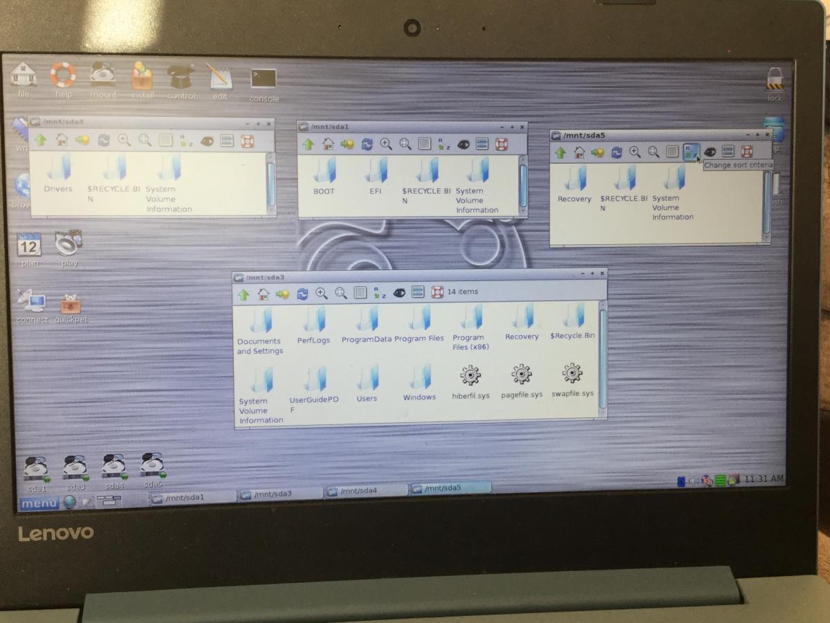

  • 193 posts
Hi phill,
It would appear Ive got a faulty usb connection, Ive had to remove the usb drive with the puppy software on it to connect a usb mouse! The other usb connector was non responsive when I connected the usb mouse to it.
What do you want me to check if I can. Its shown 4 drives. I can access them all as shown in the picture.
Scottb
Edited by scottb, 30 January 2019 - 05:33 AM.
  • 25,039 posts
Hello Scott,
Have you been able to access the personal data on the HDD etc.
Did you make sure that your Windows ISO is good using QEMU Simple Boot
Were you using this same port when trying to boot from your USB thumbdrive, if yes, try booting from the thumbdrive again but this time in the port that you presently have the USB mouse in.

  • 193 posts
Hi phill,
I was able to access documents and settings, but the folder was empty not sure if she had anything in it anyway she used her laptop mostly for playing games online.
I used both the USB ports when using the Lenovo recovery usb pen, the one I know now to be faulty was just trying to load the Lenovo built in system repair screen, the good port just loaded to a black screen if memory serves me correct. I have deleted it just now because I needed the pen for something else. But I have ordered another usb pen scan disk one and still have the files and software to recreate the recovery pen again when its delivered. Ive also read a few things about the reliability of different pens and scan disk seem to be the recommended brand.
Not sure what else I can do until the new usb pen arrives and see if the different brand makes a difference.
So if you want to leave this here for a day or two thats fine with me? Ill can come back once Ive recreated the pen and tried again?
Unless there is any other tests we can do to determine if anything else is faulty that would cause it to corrupt the o/s?
