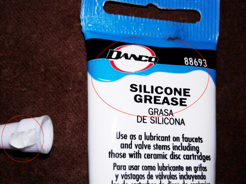

I fixed the hinges on this laptop by adjusting the screws on the hinges with a 5mm wrench and this was the only thing that resolved the issue completely.
  • Youtube will help you to have a general idea of how to dissemble your laptop. Search for your " [Your laptop brand] [Your laptop model] [Dissemble] "
  • Laptops are pieced apart and sold on ebay.com. If you need to see how a small plastic piece fits or comes out ( such as a hinge cover ), go to ebay and search for your laptop [ brand ][ model ] [ part in question ].
Loosening the screws solved the lid from being too tight and this is what will break your laptop. If you still want to apply lubricant, I used silicon grease and it is the best thing I have found. It costs 3 dollars and some cents and I bought it a hardware store ( Lowes ). Wal-mart carried it on-line but wal-mart did not have it physically at the store.
(Pictures of everything attached)
