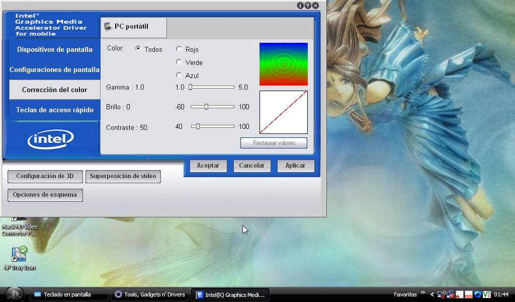

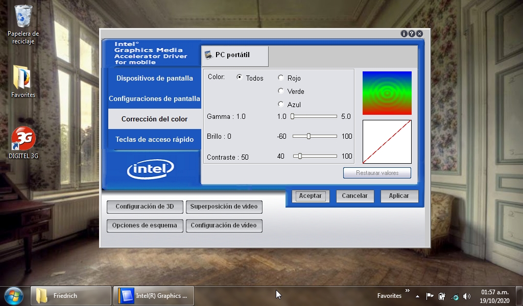

I have 2 of these mini laptops (The other one runs Win7, screen brightness ok), I compared the settings on both PCs and both are the same (See screenshots), but still the laptop with WinXP is darker. Maybe the brightness level is stored somewhere else?

Here's a screenshot of what the settings look like:
Laptop with Windows XP

Laptop with Windows 7 (Professional x86 SP1)

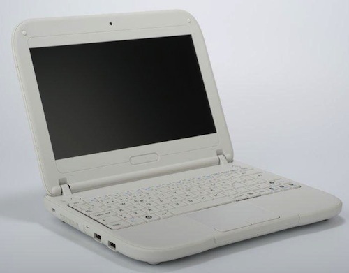

Here you can see how these things look like MG101A3 (Intel® powered classmate pc)
