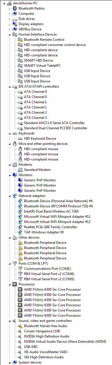

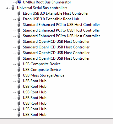

1) There are missing drivers, but it is for blue tooth which I don't use  (attached)
2) I use flash drives all the time and move files around from computer to computer without issue

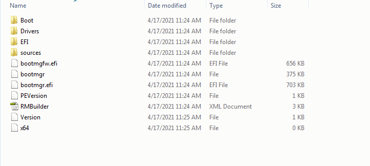

3) Here are the contents of the drive (attached)
4) For the three USB flash drives I tried with MR rescue build on them, each one of them did something different when booting to them.

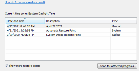

Also, I am back to missing restore points again.  I created one today and it only showed today's, an "automatic" one from yesterday (I don't know where that one came from) and one from Mar 2020.  I think you said it might be deleting the old ones.

This post is for reference about System Restore, please do not attempt any repairs for the Moment. We will sort it out later along with the chkdsk issue.> https://www.ubackup....-windows-7.html

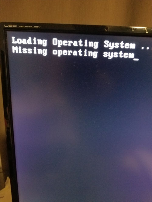

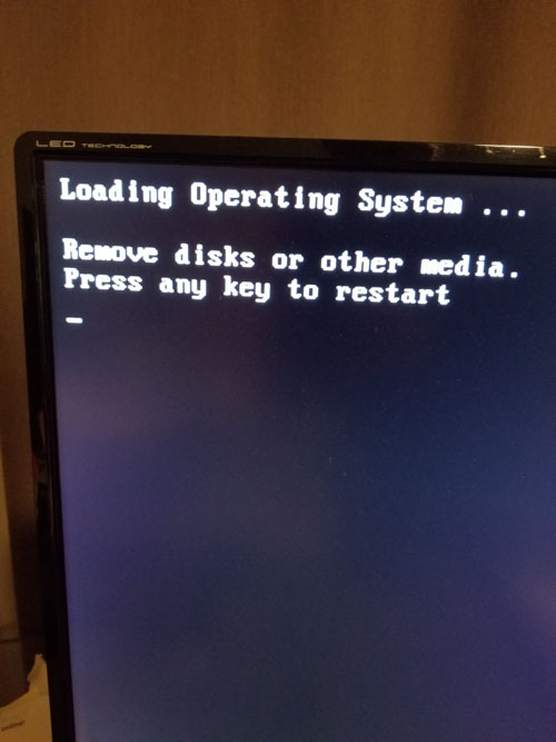

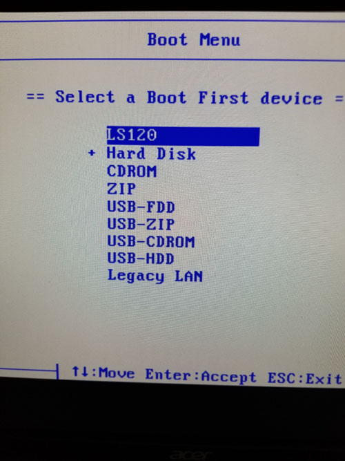

Ok here is the F12 list and using 2 USB's what happened each time.  I think this is what you wanted.
I have tried several of the menu selections for boot and the HDD is the only one that tries to run the USB.
My Bios is set up to boot to win 7 in all of these cases.

Despite you selecting USB-HDD BIOS is still not finding the Boot files on the stick.
Try resetting the BIOS.

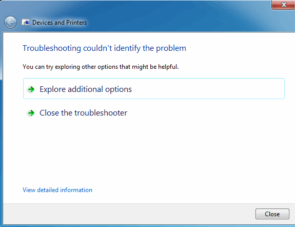

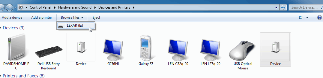

Click start > right menu, select Device and Printers > right click the USB drive select Browse Files;    There should be 11/12 with Boot being the first one??
Click the back arrow at the top > right click the USB again, select Troubleshooter; Any problems?

Ok I've attached 4 pics.
These are pics with the USB connected.
1) boot listing after optimized defaults
2) device manager instead

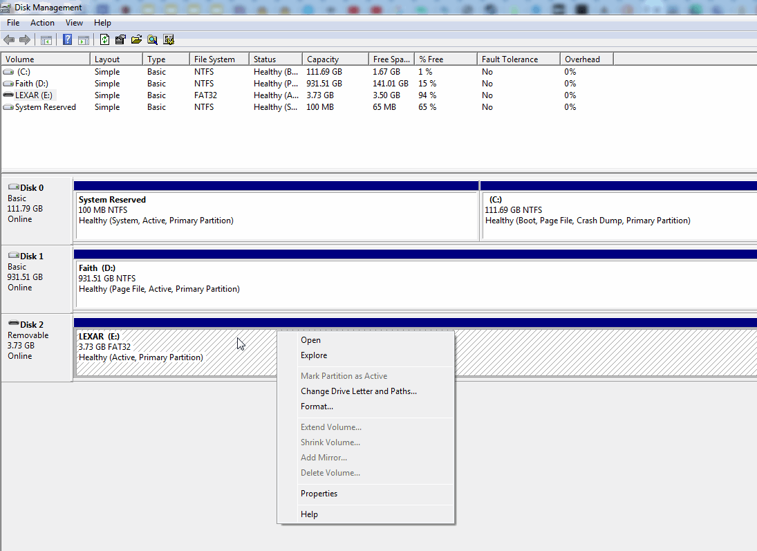

3) partition manager to see the drives.
4) device/printers screen shots - found it, screen shot
5) trouble shoot with it, no problems found.
6) Also did the troubleshoot on the BLUE TOOTH, but it failed, not sure if that has anything to do with it, but I tried the fix anyway.

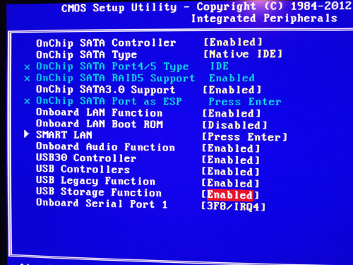

click on Integrated Peripherals, then insure
USB Legacy, Enabled
USB Storage, Enabled.

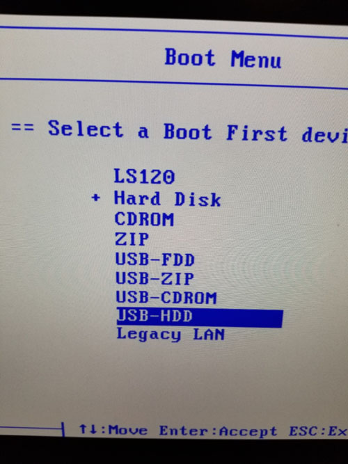

Go to the Boot Menu.
Set the order of device to 1 Disk Drive, 2 USB HDD, 3, CDROM, > Exit Menu > Save and exit.
When back in Windows, plug in the USB, > Restart and press F12, Please take a pic.
If you have HDD+ now showing, click it, another option should open, select the USB and press enter.
If it does not show, click on the USB HDD,   ????
#148
netrate
netrate
  • 197 posts

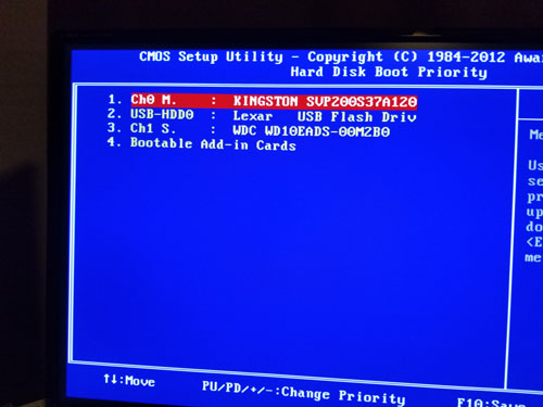

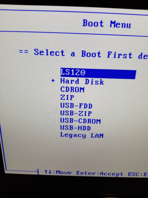

I hope I did it right.  I took pictures. The first is the Enable part
The second is setting up the boot priority ( I know you said CD rom, but that has been disconnected age ago, it is only the Win 7 and a storage drive connected now.
The third is after restart and the f12 menu

iammykyl
iammykyl
    Tech Staff
  • 7,659 posts
That's OK, but no HDD+, perhaps your board does not have this feature.
Firsty, restart > F12 > select USB-HDD > press enter. Does it boot, or do you still get error.
#150
iammykyl
iammykyl
    Tech Staff
  • 7,659 posts
Posting before going to bed.
If Boot to USB still failed.
Go back into BIOS > Make the Lexer USB first and the SSD second, Save and Exit.
Does it Boot into USB, or still error?
