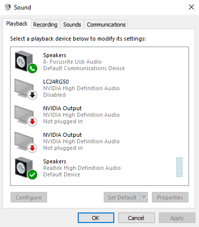

I have this weird issue on my scarlett solo 3rd gen where everytime I do a full reboot (either restart or boot up after shutdown) my focusrite USB audio just doesn't work. It work just fine if I just put my PC to sleep.
I use the scarlett solo for my mic and headset output. When the issue occur I can't switch between audio outputs and my mic won't work, i'll attach a screenshot of my sound window
there's no volume bar on the rightside and I can't click on it.
so far I've tried:
1. Disabling windows auto update,
2. Trying different USB ports,
3. Re-installing USB drivers,
4. Re-installing Focusrite USB Audio drivers.
re-installing focusrite USB Audio drivers fixed it temporarily. But after I restart or shutdown the PC it broke down again (I've re-installed the driver 10 times at this point already).
it's annoying so if anyone can give me some inputs that would be much appreciated

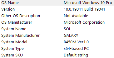

What make and Model number PC is this and what version of Windows?  (I'm guessing Win 10 version 2004 based on some of the errors I see)
Assuming it is Win 10 it would not hurt to run DISM & SFC:
Yes, Im running on a win10 version 2004.

  • 24,538 posts
What make and Model number PC is this?  Also give me the service tag if it has one.
sukucoy
sukucoy
  • 10 posts
I assume this is the answer of the question? I'm not sure.
  • 24,538 posts
Make sure you have the latest BIOS and Chipset  & Audio drivers.  They are available near the bottom of:
https://www.galax.co...otherboard.html

oh and I screenshot some description on the troubleshooter window when the focusrite USB audio stopped working
everything stays plugged in

  • 24,538 posts
DxDiag says:
Description: LC24RG50 (2- NVIDIA High Definition Audio)
 Default Sound Playback: No
 Default Voice Playback: Yes
and
Description: Speakers (10- Focusrite Usb Audio)
 Default Voice Playback: No
and
          Description: Speakers (Realtek High Definition Audio)
 Default Sound Playback: Yes
I don't have multiple sound devices so I can't play with the options but I wonder if it would help to make the Focusrite the Default?  Perhaps Windows is getting confused?
If you search for
control panel
and hit Enter then View by: Large Icons then click on Sound then select Focusrite
there is a Set Default button at the bottom to set the default.  It's greyed out on mine since I only have the one but should be a possibility on yours.
Also there may be something in Settings:
Search for
settings
hit Enter
Select System then Sound
Under Output try selecting Focusrite where it says Choose your Output Device.
You can also click on Manage Sound Devices and it should show you the three devices.  You can click on the nonFocusrite devices and you will see an option to Disable the device.  Perhaps if you disable the others Windows will keep working with Focusrite.
At the bottom of DxDiag is a list of errors.  You have more than I normally see but most don't tell me much.  I do see:
i usually switch between realtek HD (speakers) and focusrite audio (headset). The other was just enabled because i did a BIOS update and havent disabled it when i ran dxdiag
here's a dxdiag run with focusrite as the default
Attached File  DxDiag focusrite default.txt   59.16KB   235 downloads
