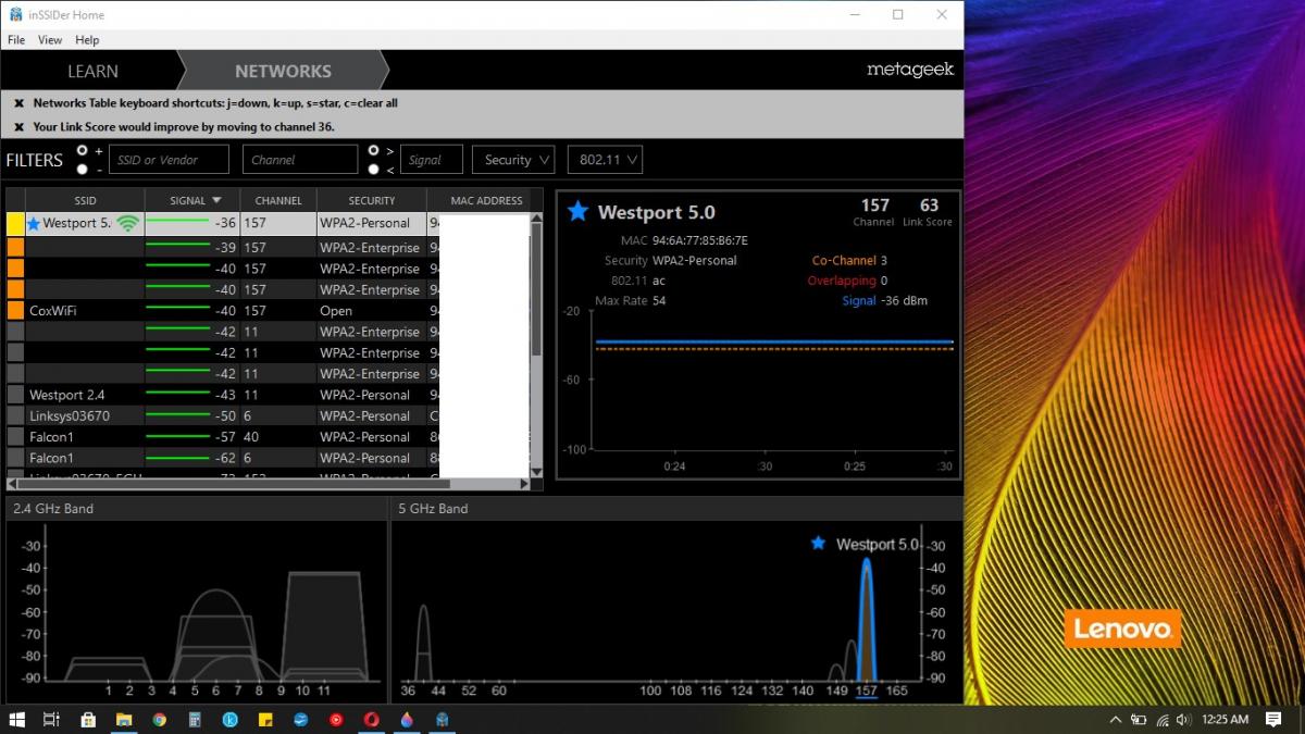

Go to:
https://www.speedtest.net/
hit GO.  Note your download speed when it finishes.
Now connect to Westport 5.0 - should be the same password - and repeat the speedtest.  Any difference?
Oddly enough there is another signal on Channel 157 call CoxWiFi so it may not be any better.   (With so many channels available it is unusual to see competing signals on the new bad.   Perhaps it is from the same router?  It doesn't have any encryption on it so could be used by anyone.)
If you own or control the router it would be wise to log onto it and change the WiFi Channel from Auto to another channel that has no interference.  There is a program called Insidder that will show you the competing signals which will help you pick a better channel.

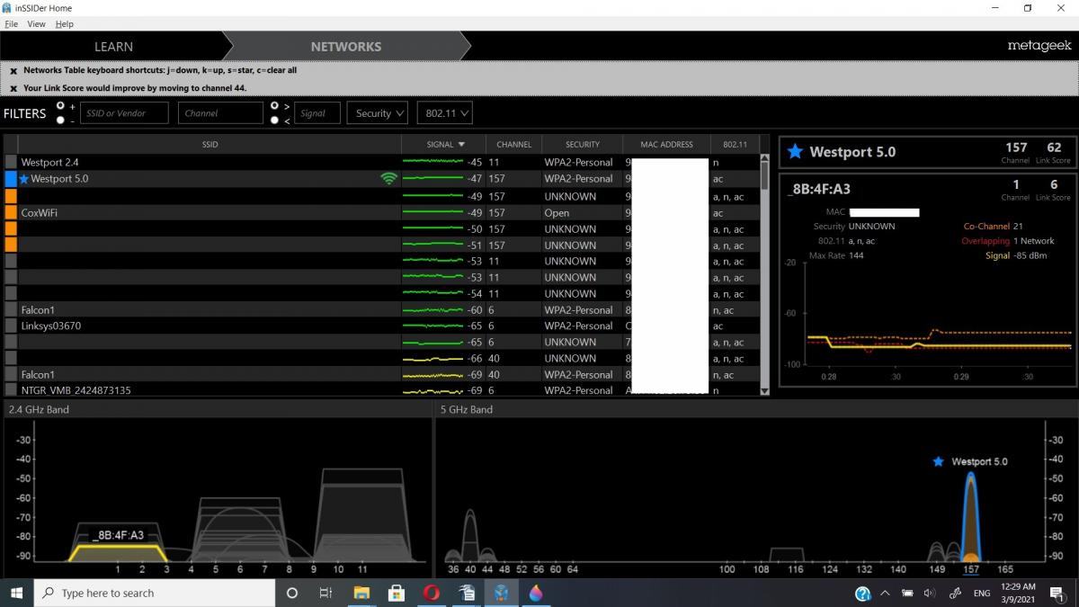

Download inssider
https://www.techspot...6-inssider.html
Double click to install it. Then run it by right click and Run As Admin.
It will show you a graph in the bottom right that has your signal in blue and competing signals in orange and yellow.  It may also recommend a different channel which might have less interference.
Moving to a different channel (by logging on to your router) can drastically improve performance.  If you do not know how tell me the Router's make and model number.  If supplied by your ISP there is usually a password written on a sticker on the back or bottom fo the router.

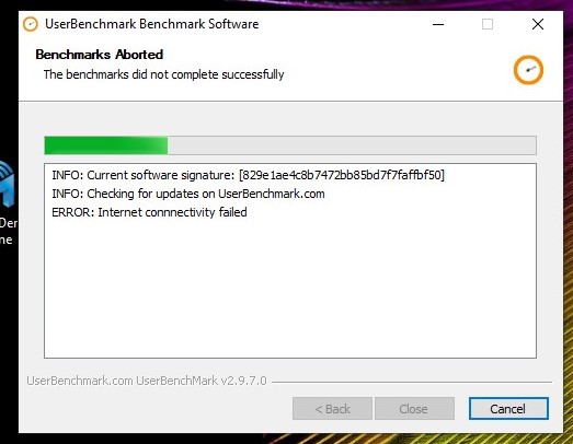

Let's get a benchmark to see how your PC is running:
https://www.userbenchmark.com
Click on Free Download.  Save the file then right click and Run As Admin.  Close all programs and pause your antivirus before starting.
When it finishes it will open a browser.  Copy the URL and paste it into a Reply.

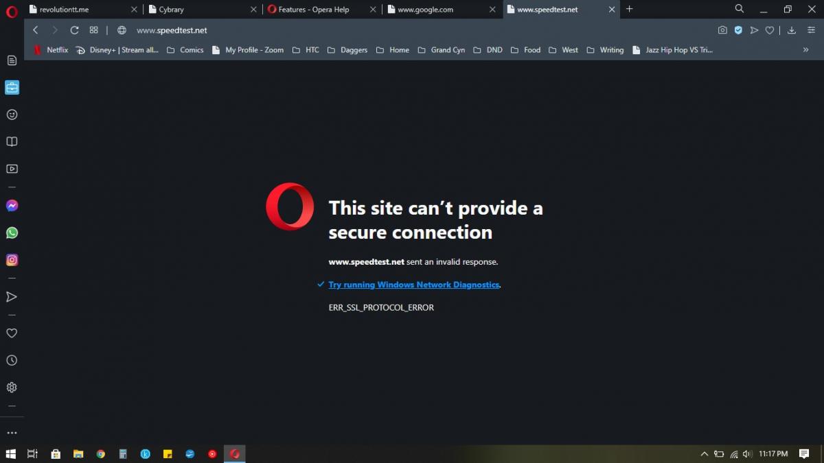

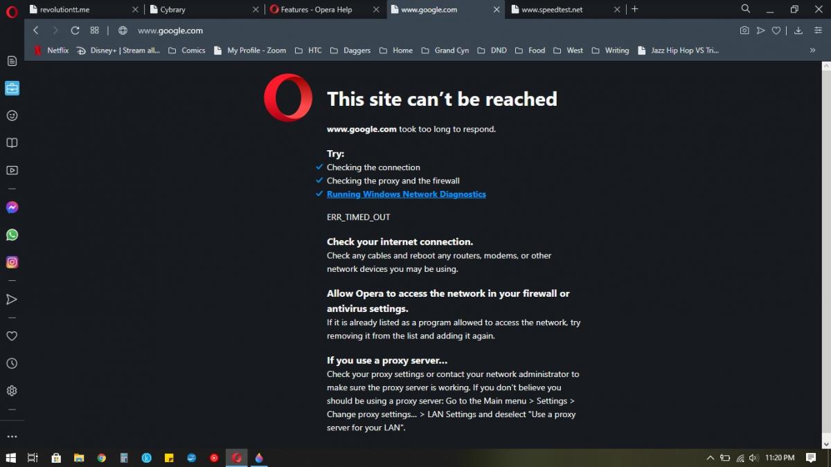

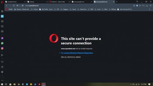

I'll attach some screenshots, I felt that most of what I tried tonight was ineffective, but there was something interesting I noticed when comparing results between the Lenovo and HP.

InSSIDer results seemed fine... until I compared the Lenovo (problem machine) with the HP (replacement). See screenshots InSSIDerLenovo & InSSIDerHP to see what I mean... though I don't know what the differences mean. It seems to me that the Lenovo isn't seeing the whole picture... which makes sense since it claims to be connecting to the internet but isn't actually receiving any info.
And running Benchmark failed, because it couldn't check in with it's own servers to verify update status (See Benchmark1).

  • 24,731 posts
Something wrong with Opera or with your clock.  The speedtest.net site does provide HTTPS connections which are secure.  In contrast geekstogo.com does not.  You need an accurate clock in order to connect with HTTPS so make sure the time and date are correct AND synced to Internet time.
See: https://www.groovypo...et-atomic-time/
Also these days the option to use secure DNS is available on most browsers.  Most will use Secure DNS if they can but will use unsecure if they have to.  I don't have Opera so I don't know for sure what they do.  Perhaps Opera is set to only use Secure DNS and that's why it started working when we manually changed the DNS.  (Changing the network to the 5.0 one is probably considered a new network so defaults back to the original DNS)  Go into Opera's settings and see if you can find out what they do for DNS.
See if it works in Chrome which FRST says you have.  The Secure DNS setting in Chrome is click on the three dots in the upper right then on Settings then on Privacy & Security then Use Secure DNS (off by default)
