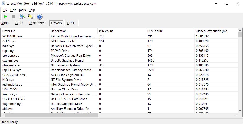

Hari Prahlad
Hari Prahlad
  • 293 posts
CONCLUSION
Your system appears to be having trouble handling real-time audio and other tasks. You are likely to experience buffer underruns appearing as drop outs, clicks or pops. One or more DPC routines that belong to a driver running in your system appear to be executing for too long. One problem may be related to power management, disable CPU throttling settings in Control Panel and BIOS setup. Check for BIOS updates.
LatencyMon has been analyzing your system for  0:00:28  (h:mm:ss) on all processors.
SYSTEM INFORMATION
Computer name:                                        PINKYPC
OS version:                                           Windows 10, 10.0, version 2009, build: 19042 (x64)
Hardware:                                             Aspire E5-573, Acer
CPU:                                                  GenuineIntel Intel® Core™ i3-5005U CPU @ 2.00GHz
Logical processors:                                   4
RAM:                                                  4016 MB total
CPU SPEED
Reported CPU speed:                                   20 MHz
Highest measured interrupt to process latency (µs):   2026.60
Average measured interrupt to process latency (µs):   16.043781
Highest measured interrupt to DPC latency (µs):       2011.40
Average measured interrupt to DPC latency (µs):       4.682977
 REPORTED ISRs
Highest ISR routine execution time (µs):              39.050
Driver with highest ISR routine execution time:       ACPI.sys - ACPI Driver for NT, Microsoft Corporation
Highest reported total ISR routine time (%):          0.004051
Driver with highest ISR total time:                   ntoskrnl.exe - NT Kernel & System, Microsoft Corporation
Total time spent in ISRs (%)                          0.010281
ISR count (execution time <250 µs):                   1247
REPORTED DPCs
Highest DPC routine execution time (µs):              1581.0920
Driver with highest DPC routine execution time:       Wdf01000.sys - Kernel Mode Driver Framework Runtime, Microsoft Corporation
Highest reported total DPC routine time (%):          0.073573
Driver with highest DPC total execution time:         Wdf01000.sys - Kernel Mode Driver Framework Runtime, Microsoft Corporation
Total time spent in DPCs (%)                          0.170047
DPC count (execution time <250 µs):                   10379
DPC count (execution time 500-10000 µs):              186
DPC count (execution time 1000-2000 µs):              2
 REPORTED HARD PAGEFAULTS
Process with highest pagefault count:                 avp.exe
Total number of hard pagefaults                       15
Hard pagefault count of hardest hit process:          4
Number of processes hit:                              6
 PER CPU DATA
CPU 0 Interrupt cycle time (s):                       0.414803
CPU 0 ISR highest execution time (µs):                39.050
CPU 0 ISR total execution time (s):                   0.011402
CPU 0 ISR count:                                      1168
CPU 0 DPC highest execution time (µs):                1581.0920
CPU 0 DPC total execution time (s):                   0.159612
CPU 0 DPC count:                                      9070
CPU 1 Interrupt cycle time (s):                       0.101744
CPU 1 ISR highest execution time (µs):                3.580
CPU 1 ISR total execution time (s):                   0.000160
CPU 1 ISR count:                                      61
CPU 1 DPC highest execution time (µs):                64.380
CPU 1 DPC total execution time (s):                   0.003065
CPU 1 DPC count:                                      255
CPU 2 Interrupt cycle time (s):                       0.156270
CPU 2 ISR highest execution time (µs):                4.6350
CPU 2 ISR total execution time (s):                   0.000026
CPU 2 ISR count:                                      11
CPU 2 DPC highest execution time (µs):                356.1550
CPU 2 DPC total execution time (s):                   0.025470
CPU 2 DPC count:                                      993
CPU 3 Interrupt cycle time (s):                       0.065565
CPU 3 ISR highest execution time (µs):                2.8750
CPU 3 ISR total execution time (s):                   0.000016
CPU 3 ISR count:                                      7
CPU 3 DPC highest execution time (µs):                62.9150
CPU 3 DPC total execution time (s):                   0.003788
CPU 3 DPC count:                                      249

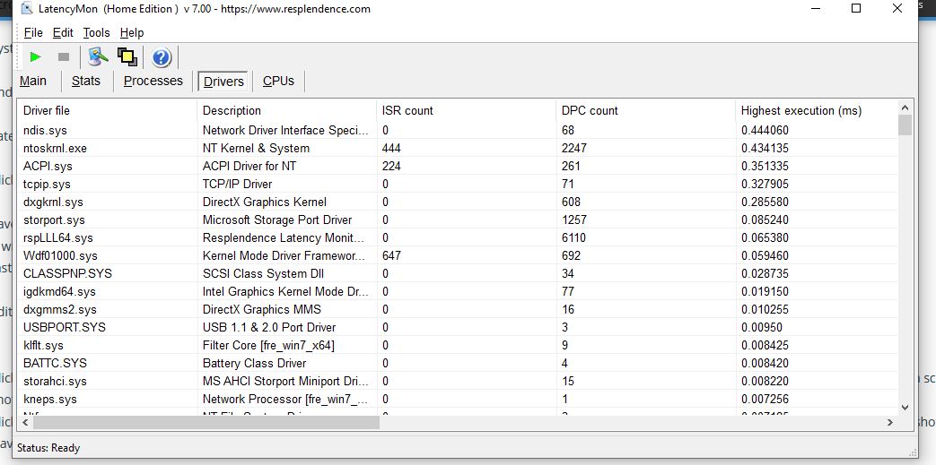

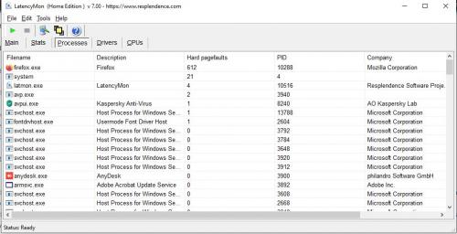

Hari Prahlad
Hari Prahlad
  • 293 posts
CONCLUSION
SYSTEM INFORMATION
RAM:                                                  4016 MB total
CPU SPEED
 REPORTED ISRs
REPORTED DPCs
 PER CPU DATA
CPU 1 ISR count:                                      61
CPU 2 ISR count:                                      11
CPU 3 ISR count:                                      7
  • 24,483 posts
Wdf01000.sys indicates a problem with a USB connected device.  Try unplugging all USB connected devices and rerun Latency Monitor.  Is it happier with your system?  Look for a new driver for any device connected by USB from the maker's support site.

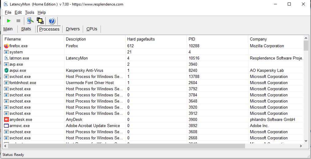

Hi RKinner
Offline, dongle removed results attached.
  • 24,483 posts
The dongle is making Lat Mon unhappy.  Does the sound work better without the dongle?
There doesn't seem to be a driver for the dongle.  The support website says Windows uses its own driver.  Perhaps if we offload the network it will help:

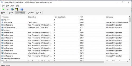

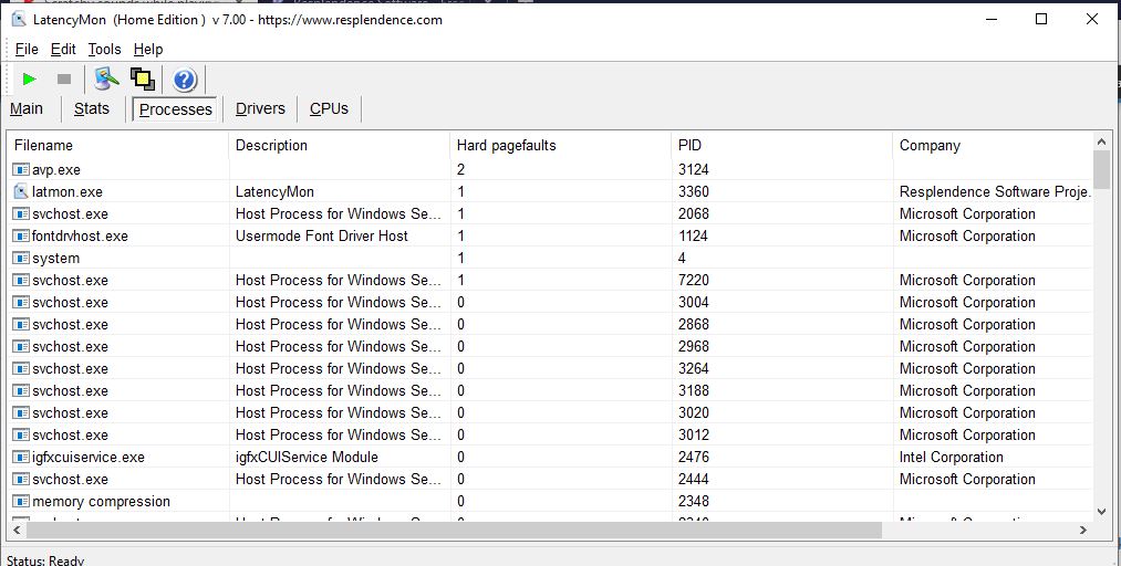

Rerun Latency Monitor and post the summary.  (with the Dongle but with Firefox closed)
Hari Prahlad
Hari Prahlad
  • 293 posts
Sure, Boss. I'll take a screenshot of your instructions and do it right away.
Hari Prahlad
Hari Prahlad
  • 293 posts
1. Scratchy sound persists even when the dongle is removed and I'm not on Firefox but still online according to the taskbar icon.
2. Did all the disabling as instructed and downloaded OOSU.  Ran it.
3. Ran Lat Mon and got the summary.
Please see relevant attachments.
