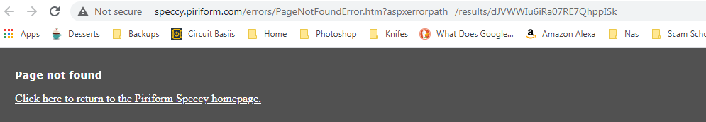

http://speccy.piriform.com/results/dJVWWIu6iRa07RE7QhppISk

Something went wrong pic attached
http://speccy.pirifo...Acb27n7tSXoC1k7

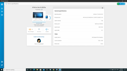

This is  my system information.
OS Name Microsoft Windows 10 Home
Version 10.0.19042 Build 19042
Other OS Description Not Available
OS Manufacturer Microsoft Corporation
System Name DESKTOP-HR1OHSF
System Manufacturer HP
System Model HP All-in-One 24-f0xx
System Type x64-based PC
System SKU 3JV30AA#ABG
Processor AMD A6-9225 RADEON R4, 5 COMPUTE CORES 2C+3G, 2600 Mhz, 2 Core(s), 2 Logical Processor(s)
BIOS Version/Date AMI F.51, 25/05/2020
SMBIOS Version 3.0
Embedded Controller Version 6.14
BIOS Mode UEFI
BaseBoard Manufacturer HP
BaseBoard Product 8430
BaseBoard Version 1000
Platform Role Desktop
Secure Boot State On
PCR7 Configuration Elevation Required to View
Windows Directory C:\WINDOWS
System Directory C:\WINDOWS\system32
Boot Device \Device\HarddiskVolume1
Locale United States
Hardware Abstraction Layer Version = "10.0.19041.964"
User Name DESKTOP-HR1OHSF\ericf
Time Zone W. Australia Standard Time
Installed Physical Memory (RAM) 4.00 GB
Total Physical Memory 3.87 GB
Available Physical Memory 1.19 GB
Total Virtual Memory 7.00 GB
Available Virtual Memory 2.24 GB
Page File Space 3.13 GB
Page File C:\pagefile.sys
Kernel DMA Protection Off
Virtualization-based security Not enabled
Device Encryption Support Elevation Required to View
Hyper-V - VM Monitor Mode Extensions Yes
Hyper-V - Second Level Address Translation Extensions Yes
Hyper-V - Virtualization Enabled in Firmware No
Hyper-V - Data Execution Protection Yes

Ok you can up the ram
Based on this here https://support.hp.c...ument/c05929092
  • DDR4 SODIMM (260-pin) socket
  • Supports the following:
    • PC4-17000 (DDR4-2133)
  • Supports 2 GB, 4 GB, 8 GB DDR4 SODIMMs
