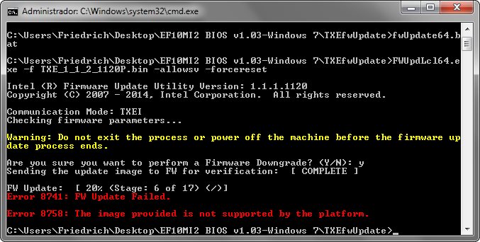

Well, the process worked, I downgraded my BIOS successfully. But still can’t use headphones. Then I tried to downgrade the firmware to the version that came in the v1.03 ZIP, and got this error:
Error 8758: The image provided is not supported by the platform.
Then I tried via EFI shell and I got the same error.
