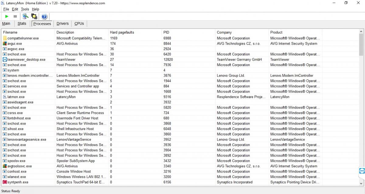

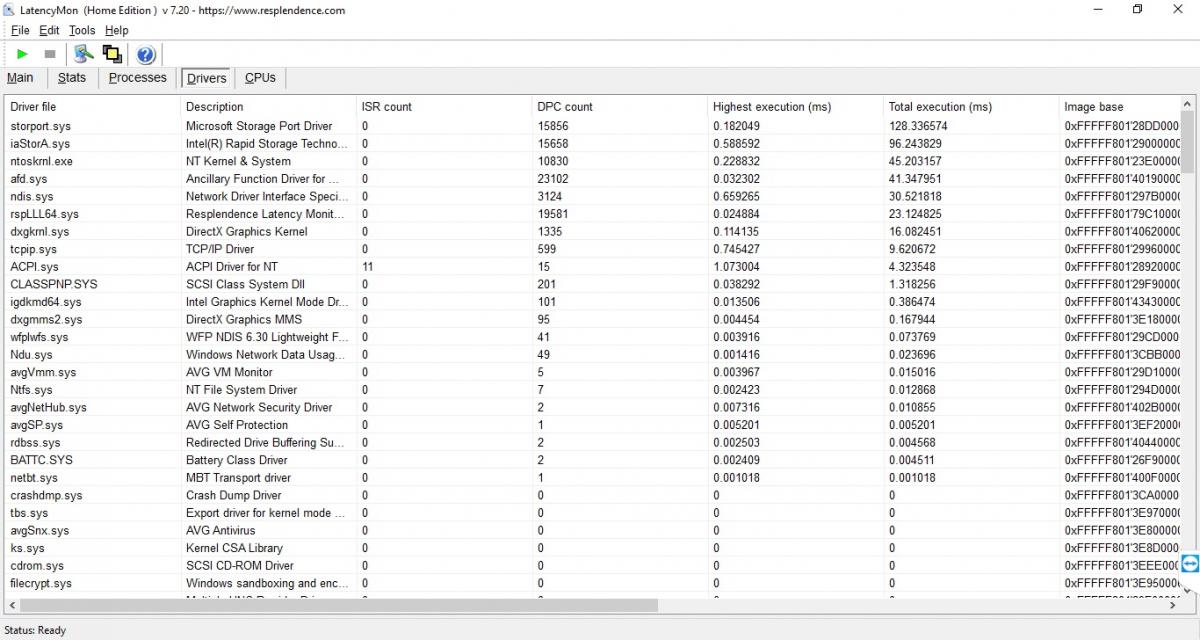

I received a Lenovo Model 80TV Laptop to check it for issues. The laptop is extremely slow to load, shutdown, restart, etc. After a while, the laptop is somewhat usable, but sluggish. The owner noted taking it to Geek Squad (Problem #1 !) for concerns about his Antivirus program expiring, despite having a receipt showing his payment for time longer than provided.
The program was Webroot, or some Suite of variant of it. Also, I noticed that Geek Squad had installed Google Chrome, and Microsoft 365, on the day the owner took it for the concerns about his premature Antivirus expiration.
Preliminary troubleshooting was conducted by me. I scanned the HDD drive for errors, and ran an in-house restart disk fix. It processed the restart, disk check/fix and rebooted. There was no change to behavior. The HDD has plenty of space. I ran the disk cleanup tool and attempted to erase 9 Gb of items noted in the tool. The process hung and I aborted it. I also uninstalled Google Chrome and 365, since they were not asked for by the owner, and I had suspected they may have been botched installs by Geek Squad. Both programs were uninstalled, along with Spotify, and Webroot.
Multiple restarts, and an impromptu windows 'updating/making changes - do not restart' occurring, which lasted for hours, did not seem to do the trick.
The laptop, when started in safe mode, boots up with no issue, fast, and shows no signs of any symptoms.
Lastly, I checked startup, and there was nothing out of the ordinary, where I though there might be something hosing the laptop on start up.
With my only remaining options being initiating a recovery, or reimage, I wanted to see if the nice folks at Geeks to Go could take a look at it.

Download, Save and Install it.  Tell it you do not need CCLEANER.    Run Speccy.  When it finishes (the little icon in the bottom left will stop moving),
Latency Monitor:
Go to
Scroll down to
System Monitoring Tools
and then find
Instead click on the green arrowhead (looks like a Play button).   Let it run for about 20 seconds.  Then hit the red box to stop it.

Jamazz
Jamazz
  • 90 posts
Total execution & hard pagefaults  SS

  • 24,625 posts
I see you have added AVG and Teamviewer to the PC.  Please do not add software while we are working on it.  Hard to paint a moving train.  You should probably uninstall McAfee Safe Connect.  Appears to be a VPN program and VPNs always slow down things.
Bring up the FRST program and put
browser.dll
in the Search Box and then hit Search Files
Windows is complaining that the file is missing and unfortunately SFC and DISM did not replace it.
Latency Monitor is showing a problem with ACPI.sys.  That's a critical windows file so probably not at fault.  I think it talks to the BIOS so you should try updating the BIOS.  Your current BIOS is dated 2016.  The latest on the Lenovo site for a random Model 80TV
is
3JCN31WW 06 Sep 2018
May not be your exact model so make sure you give them the exact part number or serial number or whatever they ask for.
