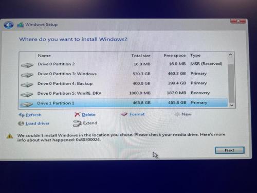

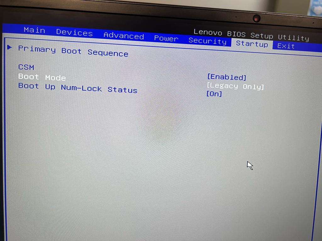

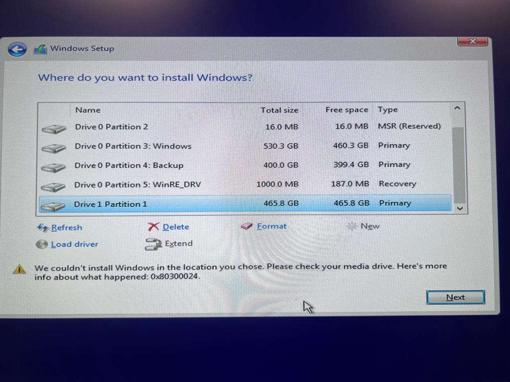

Using Boot mode Legacy only its showing this error;
How to solve this?

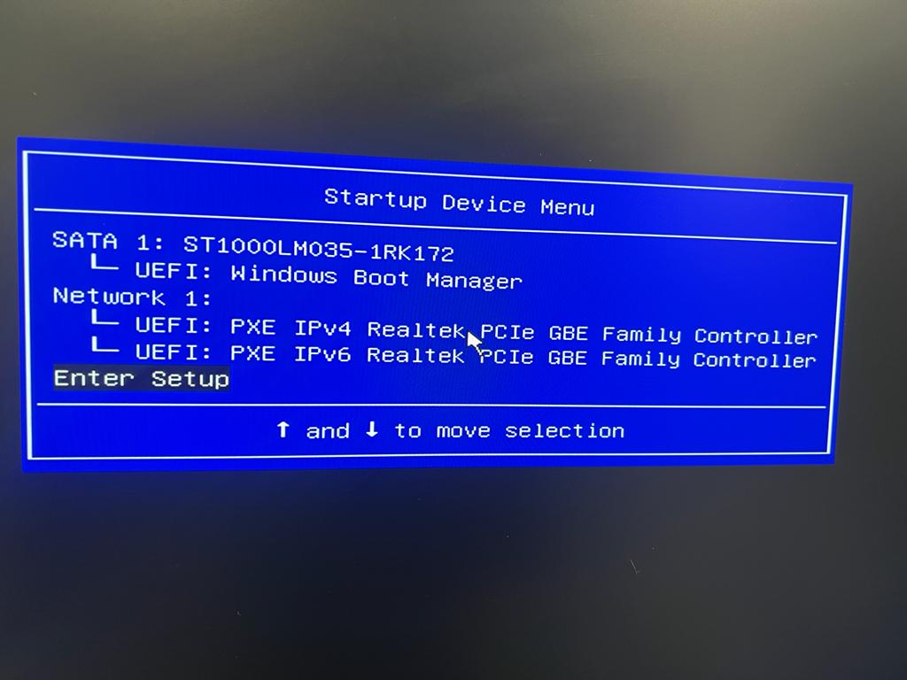

When I use Boot mode UEFI only, it wont start with my bootable USB drive (My usb windows installer)

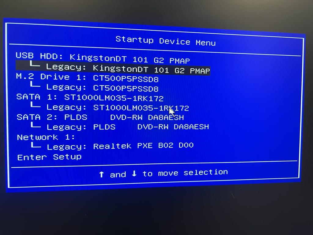

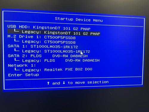

If I put Boot mode Legacy only it will boot on my usb drive
But then again, if I selected Legacy, I will end up with the error showing on the 2nd screen shot.

Your USB drive was formatted with an MBR so is Legacy.  Doesn't your PC BIOS have an option for AUTO?  This would would boot either Legacy or UEFI and is the recommended setting.
Your error is often caused by 1.  Too many hard drives  Try unplugging the extra drives.  2.  Bad drive.  Since you have Windows installed on one drive, boot to that drive and use Disk Management (shows as  Create and Format Hard drive partitions when Search finds it).  In the bottom window find your M.2.  Right click on the Disk (not on the volume.)  Ideally you want this drive GPT but since you already have two working I would compare the working units and make this one look the same.
There should be an option Convert to GPT.  If it's gray then the drive is already GPT (UEFI).  If not gray then you can click on it and change it.
Now look in the Volume box to the right of the Disk box and it should say NTFS.  If not right click on the Volume box and Format (choose NTFS) and make sure that works.  Windows will normally format a blank drive for you but this way you are sure that it works.
This one solved my problem. I made a Bootable USB drive in GPT format. Then I converted my M2 which is in MBR format to GPT.
