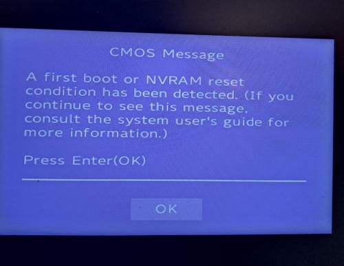

Yes, the problem came out of nowhere. I started the computer one morning, on the boat, and got the message in the attachment.
The computer is four years old and I figured the CMOS battery had died. I couldn't get a replacement here in the Dominican Republic, so continued to use the computer for a month until I could get to the City for a battery replacement.
The new CMOS battery didn't help. The computer will not start on the main battery. Plugged in, I get "CMOS Message" on start-up and then the OS wants to check the disc before continuing. After that, it works fine on the battery but I've had a few "crashes" since the problem started. Time and date are correct.

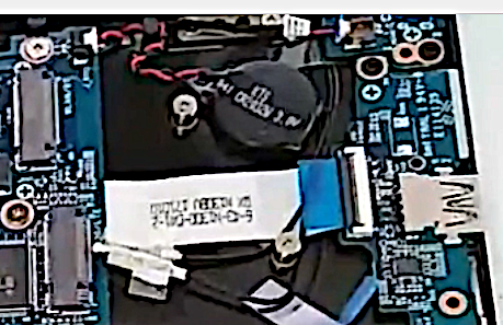

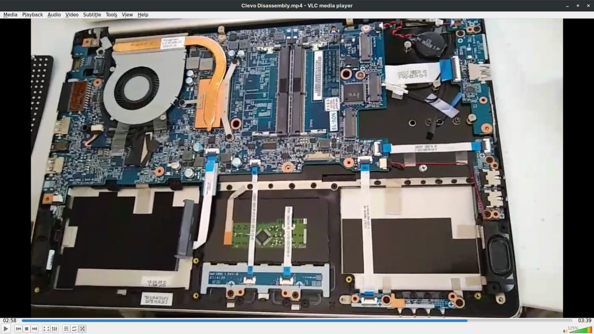

Here is a photo downloaded from a website video showing the CMOS in the upper right. This is not my computer, but the same make and model and I send it with the intent of a speedy reply. I can photograph my own computer when I get it apart.
I have 32 gigs of RAM installed.
Thanks again,
Bry
b. cripps
b. cripps
  • 42 posts

Strange, see pic of the MB from the Clevo user manual here
No matter, just add removing the CMOS battery overnight as well.
