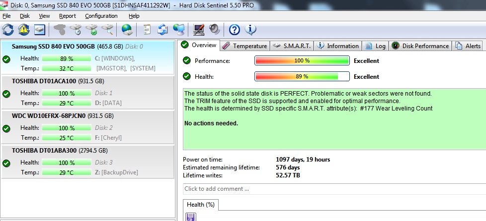

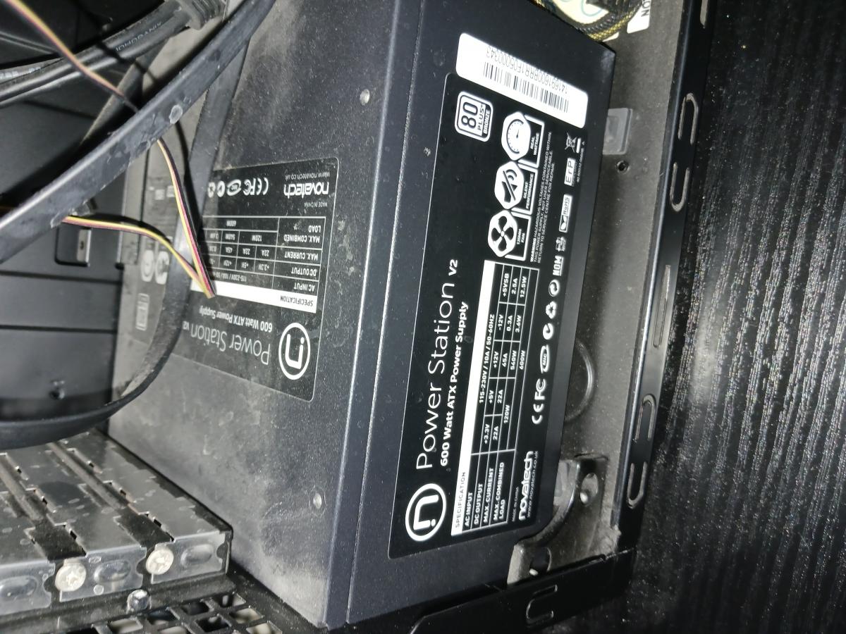

Edit to add: You have a lot of storage devices hooked up there, can you post the brand and model name or number of the PSU so that we can check that it is good and new enough to support all of your hardware.

  • 14 posts
Windows is corrupt so at the least you may need need Windows 7 media so that you can do a repair installation, do you have a Windows 7 DVD.
While we look at the Speccy report, one thing I will suggest is that you change the Windows Power Plan to Balanced, Ultra and High Performance are a form of overclocking that is known to cause stability and overheating issues, it is particularly bad if you have an old/weak PSU.
Hi thanks for helping. Sadly this was pre installed so now DVD.
I've added a photo to my original post of the PSU

  • 25,108 posts
Not the best of PSUs even when new but it is most unlikely to be the cause or your registry corruption, please follow the above of SleepyDude.
