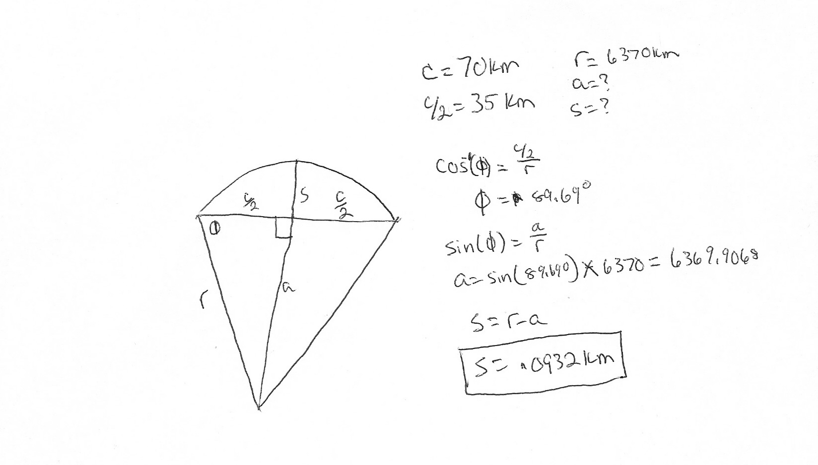

  • 1,260 posts
sorry i was in radian mode and forgot to subtract r
.0932km
here's my work

I know I'm a week late, but did you solve the math problem already? Shouldn't the answer be .0962 meters?
The distance from the center of the earth to any point on the surface has to be constant at 6370m, meaning the distance to either endpoint of the rope as well as to the point that bisects the arc above the rope are all 6370m. Assuming this, it's just a matter of the pythagorean theorem and some subtraction, right?
Bisecting the rope creates a right triangle with the following dimesnions:
Hypotenuse © = 6370 m
Side (a) = 35 m
Remaining side (b) = the distance from center of earth to rope.
sqrt(b) = 6370*6370 - 35*35
b = 6369.903845
radius of earth (6370) - length of side b (6369.903845) = .096155 meters
