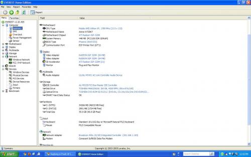

AMBorgeson
AMBorgeson
  • 7 posts
mmm, your instructions seem to be for an older version, they don't apply after clicking on report, there is no 'quick report summary', i selected hardware report. so here's what I believe you were looking for.
Version EVEREST v2.20.405
Report Type Report Wizard

Network Adapter Broadcom 440x 10/100 Integrated Controller (192.168.1.105)

--------[ Sensor ]------------------------------------------------------------------------------------------------------
Sensor Properties:
Sensor Type HDD
Temperatures:
CPU 59 °C (138 °F)
TOSHIBA MK6025GAS 48 °C (118 °F)
--------[ CPU ]---------------------------------------------------------------------------------------------------------
CPU Properties:
CPU Type Mobile AMD Athlon XP, 1789 MHz (13.5 x 133)
CPU Alias Barton
CPU Stepping A2
Instruction Set x86, MMX, 3DNow!, SSE
L1 Code Cache 64 KB
L1 Data Cache 64 KB
L2 Cache 512 KB (On-Die, Full-Speed)
CPU Manufacturer:
Company Name Advanced Micro Devices, Inc.
Product Information http://www.amd.com/u...,30_118,00.html
CPU Utilization:
CPU #1 0 %
--------[ CPUID ]-------------------------------------------------------------------------------------------------------
CPUID Properties:
CPUID Manufacturer AuthenticAMD
CPUID CPU Name Mobile AMD Athlon™ XP 2400+
CPUID Revision 000006A0h
Extended CPUID Revision 000007A0h
Platform ID CBh (Socket A)
IA CPU Serial Number Unknown
HTT / CMP Units 0 / 0
Instruction Set:
64-bit x86 Extension (AMD64, EM64T) Not Supported
Alternate Instruction Set Not Supported
AMD 3DNow! Supported
AMD 3DNow! Professional Supported
AMD Enhanced 3DNow! Supported
AMD Extended MMX Supported
Cyrix Extended MMX Not Supported
IA-64 Not Supported
IA MMX Supported
IA SSE Supported
IA SSE 2 Not Supported
IA SSE 3 Not Supported
CLFLUSH Instruction Not Supported
CMPXCHG8B Instruction Supported
CMPXCHG16B Instruction Not Supported
Conditional Move Instruction Supported
MONITOR / MWAIT Instruction Not Supported
RDTSCP Instruction Not Supported
SYSCALL / SYSRET Instruction Supported
SYSENTER / SYSEXIT Instruction Supported
VIA FEMMS Instruction Not Supported
Security Features:
Advanced Cryptography Engine (ACE) Not Supported
Data Execution Prevention (DEP, NX, EDB) Not Supported
Hardware Random Number Generator (RNG) Not Supported
Montgomery Multiplier & Hash Engine Not Supported
Processor Serial Number (PSN) Not Supported
Power Management Features:
Automatic Clock Control Not Supported
Enhanced Halt State (C1E) Not Supported
Enhanced SpeedStep Technology (EIST, ESS) Not Supported
Frequency ID Control Supported
LongRun Not Supported
LongRun Table Interface Not Supported
PowerSaver 1.0 Not Supported
PowerSaver 2.0 Not Supported
PowerSaver 3.0 Not Supported
Processor Duty Cycle Control Not Supported
Software Thermal Control Not Supported
Temperature Sensing Diode Supported
Thermal Monitor 1 Not Supported
Thermal Monitor 2 Not Supported
Thermal Monitoring Not Supported
Thermal Trip Not Supported
Voltage ID Control Supported
CPUID Features:
36-bit Page Size Extension Supported
Address Region Registers (ARR) Not Supported
CPL Qualified Debug Store Not Supported
Debug Trace Store Not Supported
Debugging Extension Supported
Fast Save & Restore Supported
Hyper-Threading Technology (HTT) Not Supported
L1 Context ID Not Supported
Local APIC On Chip Not Supported
Machine Check Architecture (MCA) Supported
Machine Check Exception (MCE) Supported
Memory Configuration Registers (MCR) Not Supported
Memory Type Range Registers (MTRR) Supported
Model Specific Registers (MSR) Supported
Page Attribute Table (PAT) Supported
Page Global Extension Supported
Page Size Extension (PSE) Supported
Pending Break Event Not Supported
Physical Address Extension (PAE) Supported
Secure Virtual Machine Extensions (Pacifica) Not Supported
Self-Snoop Not Supported
Time Stamp Counter (TSC) Supported
Virtual Machine Extensions (Vanderpool) Not Supported
Virtual Mode Extension Supported
CPUID Registers (CPU #1):
CPUID 00000000 00000001-68747541-444D4163-69746E65
CPUID 00000001 000006A0-00000000-00000000-0383F9FF
CPUID 80000000 80000008-68747541-444D4163-69746E65
CPUID 80000001 000007A0-00000000-00000000-C1CBF9FF
CPUID 80000002 69626F4D-4120656C-4120444D-6F6C6874
CPUID 80000003 6D74286E-50582029-30343220-00002B30
CPUID 80000004 00000000-00000000-00000000-00000000
CPUID 80000005 0408FF08-FF20FF10-40020140-40020140
CPUID 80000006 00000000-41004100-02008140-00000000
CPUID 80000007 00000000-00000000-00000000-00000007
CPUID 80000008 00002022-00000000-00000000-00000000
MSR Registers:
MSR C0010015 0000-0000-0603-1000
MSR C0010042 000B-0B0B-0015-0615
--------[ Motherboard ]-------------------------------------------------------------------------------------------------
Motherboard Properties:
Motherboard ID <DMI>
Motherboard Name Arima W720K7
Front Side Bus Properties:
Bus Type DEC Alpha EV6
Bus Width 64-bit
Real Clock 133 MHz (DDR)
Effective Clock 265 MHz
Bandwidth 2120 MB/s
--------[ Memory ]------------------------------------------------------------------------------------------------------
Physical Memory:
Total 447 MB
Used 398 MB
Free 48 MB
Utilization 89 %
Swap Space:
Total 1054 MB
Used 480 MB
Free 573 MB
Utilization 46 %
Virtual Memory:
Total 1502 MB
Used 879 MB
Free 622 MB
Utilization 59 %
Physical Address Extension (PAE):
Supported by Operating System Yes
Supported by CPU Yes
Active No
Problems & Suggestions:
Suggestion Install more system memory to improve applications performance.
--------[ SPD ]---------------------------------------------------------------------------------------------------------
[ DIMM1: Samsung M4 70L3224DT0-CB0 ]
Memory Module Properties:
Module Name Samsung M4 70L3224DT0-CB0
Serial Number 410E8936h
Module Size 256 MB (2 ranks, 4 banks)
Module Type Unbuffered
Memory Type DDR SDRAM
Memory Speed PC2100 (133 MHz)
Module Width 64 bit
Module Voltage SSTL 2.5
Error Detection Method None
Refresh Rate Reduced (7.8 us), Self-Refresh
Memory Timings:
@ 133 MHz 2.5-3-3-6 (CL-RCD-RP-RAS)
@ 100 MHz 2.0-2-2-5 (CL-RCD-RP-RAS)
Memory Module Features:
Early RAS# Precharge Not Supported
Auto-Precharge Not Supported
Precharge All Not Supported
Write1/Read Burst Not Supported
Buffered Address/Control Inputs Not Supported
Registered Address/Control Inputs Not Supported
On-Card PLL (Clock) Not Supported
Buffered DQMB Inputs Not Supported
Registered DQMB Inputs Not Supported
Differential Clock Input Supported
Redundant Row Address Not Supported
Memory Module Manufacturer:
Company Name Samsung
Product Information http://www.samsung.c.../DRAM/index.htm
[ DIMM2: Samsung M4 70L3224DT0-CB0 ]
Serial Number 41058950h
Module Width 64 bit
Memory Timings:
--------[ Chipset ]-----------------------------------------------------------------------------------------------------
[ North Bridge: ATI Radeon IGP-320M ]
North Bridge Properties:
North Bridge ATI Radeon IGP-320M
Memory Timings:
CAS Latency (CL) 2.5T
RAS To CAS Delay (tRCD) 3T
RAS Precharge (tRP) 3T
Memory Slots:
DRAM Slot #1 256 MB (PC2100 DDR SDRAM)
DRAM Slot #2 256 MB (PC2100 DDR SDRAM)
Integrated Graphics Controller:
Graphics Controller Type ATI U1
Graphics Controller Status Enabled
Graphics Frame Buffer Size 64 MB
AGP Controller:
AGP Version 2.00
AGP Status Enabled
AGP Device ATI Radeon IGP-320M (U1)
AGP Aperture Size 64 MB
Supported AGP Speeds 1x, 2x, 4x
Fast-Write Supported, Disabled
Side Band Addressing Supported, Disabled
Chipset Manufacturer:
Company Name ATI Technologies Inc.
Product Information http://www.ati.com/p...integrated.html
Driver Download http://www.ati.com/support/driver.html
[ South Bridge: ULi/ALi M1533/1535/1543 ]
South Bridge Properties:
South Bridge ULi/ALi M1533/1535/1543
Revision 00
AC'97 Audio Controller:
Audio Controller Type ULi/ALi M5451
Codec Name Analog Devices AD1981B(L)
Codec ID 41445374h
S/PDIF Output Supported
--------[ BIOS ]--------------------------------------------------------------------------------------------------------
BIOS Properties:
BIOS Type Phoenix
System BIOS Date 09/07/03
Video BIOS Date 03/09/05
BIOS Manufacturer:
Company Name Phoenix Technologies Ltd.
Product Information http://www.phoenix.c...cts/default.htm
BIOS Upgrades http://www.esupport....fm?refererid=40
Suggestion Are you looking for a BIOS Upgrade? Contact eSupport Today!
Suggestion System BIOS is more than 2 years old. Update it if necessary.
Suggestion Video BIOS is more than 2 years old. Update it if necessary.
--------[ Windows Video ]-----------------------------------------------------------------------------------------------
[ RADEON IGP 320M ]
Video Adapter Properties:
Device Description RADEON IGP 320M
Adapter String RADEON IGP 320M
BIOS String BK5.0.0 VR001.000.007.007.018.000.001.001 c
Chip Type Mobility Radeon 9200 (0x4336)
DAC Type Internal DAC(350MHz)
Installed Drivers ati2dvag (6.14.10.6351)
Memory Size 64 MB
Video Adapter Manufacturer:
Product Information http://www.ati.com/products/gamer.html
[ RADEON IGP 320M ]
Memory Size 64 MB
--------[ PCI / AGP Video ]---------------------------------------------------------------------------------------------
ATI Radeon IGP-320M (U1) Video Adapter
ATI Radeon IGP-320M (U1) 3D Accelerator
--------[ Desktop ]-----------------------------------------------------------------------------------------------------
Desktop Properties:
Device Technology Raster Display
Resolution 1280 x 800
Color Depth 32-bit
Color Planes 1
Font Resolution 96 dpi
Pixel Width / Height 36 / 36
Pixel Diagonal 51
Vertical Refresh Rate 60 Hz
Desktop Wallpaper C:\WINDOWS\web\wallpaper\Bliss.bmp
Desktop Effects:
Combo-Box Animation Enabled
Drop Shadow Effect Enabled
Flat Menu Effect Enabled
Font Smoothing Enabled
Full Window Dragging Enabled
Gradient Window Title Bars Enabled
Hide Menu Access Keys Enabled
Hot Tracking Effect Enabled
Icon Title Wrapping Enabled
List-Box Smooth Scrolling Enabled
Menu Animation Enabled
Menu Fade Effect Enabled
Minimize/Restore Animation Enabled
Mouse Cursor Shadow Enabled
Selection Fade Effect Enabled
ShowSounds Accessibility Feature Disabled
ToolTip Animation Enabled
ToolTip Fade Effect Enabled
Windows Plus! Extension Disabled
--------[ Multi-Monitor ]-----------------------------------------------------------------------------------------------
\\.\DISPLAY1 Yes (0,0) (1280,800)
--------[ PCI / PnP Audio ]---------------------------------------------------------------------------------------------
ULi/ALi M5451 AC-Link Controller Audio Device PCI
--------[ Windows Storage ]---------------------------------------------------------------------------------------------
[ TOSHIBA MK6025GAS ]
Device Properties:
Driver Description TOSHIBA MK6025GAS
Driver Date 7/1/2001
Driver Version 5.1.2535.0
Driver Provider Microsoft
INF File disk.inf
Disk Device Physical Info:
Manufacturer Toshiba
Hard Disk Name MK-6025GAS
Form Factor 2.5"
Formatted Capacity 60 GB
Disks 2
Recording Surfaces 4
Physical Dimensions 100 x 69.85 x 9.5 mm
Max. Weight 98 g
Average Rotational Latency 7.14 ms
Rotational Speed 4200 RPM
Max. Internal Data Rate 347.1 Mbit/s
Average Seek 12 ms
Track-To-Track Seek 2 ms
Full Seek 22 ms
Interface Ultra-ATA/100
Buffer-to-Host Data Rate 100 MB/s
Buffer Size 8 MB
Spin-Up Time 4 sec
Device Manufacturer:
Company Name Toshiba Corp., Storage Device Division
Product Information http://www.toshiba.c...ducts/hdd.shtml
[ TOSHIBA DVD-ROM SD-R2312 ]
Device Properties:
Driver Description TOSHIBA DVD-ROM SD-R2312
INF File cdrom.inf
Optical Drive Properties:
Device Type DVD-ROM/CD-RW
Interface ATAPI
Writing Speeds:
CD-R 24x
CD-RW 10x
Reading Speeds:
DVD-ROM 8x
CD-ROM 24x

--------[ Windows Network ]---------------------------------------------------------------------------------------------
[ Broadcom 440x 10/100 Integrated Controller ]
Network Adapter Properties:
Interface Type Ethernet
Hardware Address 00-03-25-0B-C0-C7
Connection Name Local Area Connection
Connection Speed 100 Mbps
MTU 1500 bytes
DHCP Lease Obtained 12/30/2009 10:11:49 AM
DHCP Lease Expires 12/31/2009 10:11:49 AM
Bytes Received 7013772 (6.7 MB)
Bytes Sent 466301 (455.4 KB)
Network Adapter Addresses:
IP / Subnet Mask 192.168.1.105 / 255.255.255.0
Gateway 192.168.1.1
DHCP 192.168.1.1
DNS 76.14.0.8
DNS 76.14.0.9
Network Adapter Manufacturer:
Company Name Broadcom Corporation
Product Information http://www.broadcom.com/products
Driver Download http://www.broadcom....loaddrivers.php

Network adapters:
1394 Net Adapter 5.1.2535.0
Broadcom 440x 10/100 Integrated Controller 3.51.0.0
Broadcom 440x 10/100 Integrated Controller - Packet Scheduler Miniport5.1.2535.0

[ Network adapters / 1394 Net Adapter ]
Device Properties:
Driver Description 1394 Net Adapter
INF File net1394.inf
Hardware ID V1394\NIC1394
[ Network adapters / Broadcom 440x 10/100 Integrated Controller ]
Device Properties:
Driver Description Broadcom 440x 10/100 Integrated Controller
Driver Date 12/17/2002
Driver Version 3.51.0.0
Driver Provider Broadcom
INF File oem0.inf
Hardware ID PCI\VEN_14E4&DEV_4401&SUBSYS_2029161F&REV_01
Location Information PCI bus 0, device 14, function 0
PCI Device Broadcom NetXtreme BCM4401-A1 Integrated Fast Ethernet Controller
Device Resources:
IRQ 11
Memory D0006000-D0007FFF
INF File machine.inf
Hardware ID root\update
[ System devices / Microsoft ACPI-Compliant Embedded Controller ]
Device Properties:
Driver Description Microsoft ACPI-Compliant Embedded Controller
INF File acpi.inf
Hardware ID ACPI\PNP0C09
PnP Device Embedded Controller Device
Device Resources:
Port 0062-0062
Port 0066-0066
[ System devices / Microsoft ACPI-Compliant System ]
Device Properties:
Driver Description Microsoft ACPI-Compliant System
INF File acpi.inf
Hardware ID ACPI_HAL\PNP0C08
PnP Device ACPI Driver/BIOS
Device Resources:
IRQ 09
[ System devices / Microsoft Composite Battery ]
Device Properties:
Driver Description Microsoft Composite Battery
INF File acpi.inf
Hardware ID COMPOSITE_BATTERY
[ System devices / Microsoft System Management BIOS Driver ]
Device Properties:
Driver Description Microsoft System Management BIOS Driver
Driver Version 5.1.2600.2180
Hardware ID root\mssmbios
[ System devices / Motherboard resources ]
Device Properties:
Driver Description Motherboard resources
Hardware ID ACPI\PNP0C02
PnP Device Motherboard Resources
Device Resources:
Port 0073-0073
Port 0080-0080
Port 0092-0092
Port 00B0-00B0
Port 00B1-00B3
Port 0200-0207
Port 03F2-03F5
Port 03F7-03F7
Port 040B-040B
Port 0480-048F
Port 04D0-04D1
Port 04D6-04D6
Port 8000-807F
Port F500-F503
[ System devices / Numeric data processor ]
Device Properties:
Driver Description Numeric data processor
Hardware ID ACPI\PNP0C04
PnP Device Numeric Data Processor
Device Resources:
IRQ 13
Port 00F0-00FE
[ System devices / PCI bus ]
Device Properties:
Driver Description PCI bus
Hardware ID ACPI\PNP0A03
PnP Device PCI Bus
Device Resources:
Memory 000A0000-000CEFFF
Memory 1C000000-FFF7FFFF
Port 0000-0CF7
Port 0D00-FFFF
[ System devices / PCI standard host CPU bridge ]
Device Properties:
Driver Description PCI standard host CPU bridge
Hardware ID PCI\VEN_1002&DEV_CAB0&SUBSYS_00000000&REV_13
Location Information PCI bus 0, device 0, function 0
PCI Device ATI Radeon IGP-320M Host-PCI Bridge
[ System devices / PCI standard PCI-to-PCI bridge ]
Device Properties:
Driver Description PCI standard PCI-to-PCI bridge
Hardware ID PCI\VEN_1002&DEV_700F&SUBSYS_00000000&REV_01
Location Information PCI bus 0, device 1, function 0
PCI Device ATI Radeon IGP-320M AGP Controller
Device Resources:
Memory 000A0000-000BFFFF
Memory D0100000-D01FFFFF
Memory E0000000-EFFFFFFF
Port 03B0-03BB
Port 03C0-03DF
Port 9000-9FFF
[ System devices / Plug and Play Software Device Enumerator ]
Device Properties:
Driver Description Plug and Play Software Device Enumerator
Hardware ID root\swenum
[ System devices / Printer Port Logical Interface ]
Device Properties:
Driver Description Printer Port Logical Interface
Hardware ID LPTENUM\MicrosoftRawPort958A
Location Information LPT1
[ System devices / Programmable interrupt controller ]
Device Properties:
Driver Description Programmable interrupt controller
Hardware ID ACPI\PNP0000
PnP Device Programmable Interrupt Controller
Device Resources:
Port 0020-0021
Port 00A0-00A1
[ System devices / System board ]
Device Properties:
Driver Description System board
Hardware ID ACPI\PNP0C01
PnP Device System Board Extension
Device Resources:
Memory 00000000-0009FFFF
Memory 000C0000-000CFFFF
Memory 000DC000-000DFFFF
Memory 000E0000-000FFFFF
Memory 00100000-1BFFFFFF
Memory D0400000-D0400FFF
Memory E8400000-E8400FFF
Memory F0400000-F0400FFF
Memory F4400000-F4400FFF
Memory FFF80000-FFFFFFFF
[ System devices / System CMOS/real time clock ]
Device Properties:
Driver Description System CMOS/real time clock
Hardware ID ACPI\PNP0B00
PnP Device Real-Time Clock
Device Resources:
IRQ 08
Port 0070-0071
[ System devices / System speaker ]
Device Properties:
Driver Description System speaker
Hardware ID ACPI\PNP0800
PnP Device PC Speaker
Device Resources:
Port 0061-0061
[ System devices / System timer ]
Device Properties:
Driver Description System timer
Hardware ID ACPI\PNP0100
PnP Device System Timer
Device Resources:
IRQ 00
Port 0040-0043
[ System devices / Terminal Server Keyboard Driver ]
Device Properties:
Driver Description Terminal Server Keyboard Driver
Hardware ID ROOT\RDP_KBD
[ System devices / Terminal Server Mouse Driver ]
Device Properties:
Driver Description Terminal Server Mouse Driver
Hardware ID ROOT\RDP_MOU
[ System devices / Volume Manager ]
Device Properties:
Driver Description Volume Manager
Hardware ID ROOT\FTDISK
[ Universal Serial Bus controllers / NEC PCI to USB Open Host Controller ]
Device Properties:
Driver Description NEC PCI to USB Open Host Controller
INF File usbport.inf
Hardware ID PCI\VEN_1033&DEV_0035&SUBSYS_2029161F&REV_43
Location Information PCI bus 0, device 13, function 0
PCI Device NEC uPD720101 USB OpenHCI Controller
Device Resources:
IRQ 11
Memory D000A000-D000AFFF
Device Properties:
Location Information PCI bus 0, device 13, function 1
Device Resources:
IRQ 11
Memory D000B000-D000BFFF
[ Universal Serial Bus controllers / Standard Enhanced PCI to USB Host Controller ]
Device Properties:
Driver Description Standard Enhanced PCI to USB Host Controller
Driver Date 6/1/2002
Driver Version 5.1.2600.0
Hardware ID PCI\VEN_1033&DEV_00E0&SUBSYS_2029161F&REV_04
Location Information PCI bus 0, device 13, function 2
PCI Device NEC uPD720101 USB 2.0 Enhanced Host Controller (v1.0)
Device Resources:
IRQ 11
Memory D000C800-D000C8FF
[ Universal Serial Bus controllers / USB Root Hub ]
Device Properties:
Driver Description USB Root Hub
Hardware ID USB\ROOT_HUB20&VID1033&PID00E0&REV0004
Device Properties:
Hardware ID USB\ROOT_HUB&VID1033&PID0035&REV0043
Device Properties:
[ Unknown / Network Controller ]
Device Properties:
Driver Description Network Controller
Hardware ID PCI\VEN_14E4&DEV_4320&SUBSYS_7050144F&REV_03
Location Information PCI bus 0, device 12, function 0
PCI Device Broadcom 802.11g Wireless Network Adapter
Device Resources:
IRQ 10
Memory D0004000-D0005FFF
--------[ Physical Devices ]--------------------------------------------------------------------------------------------
PCI Devices:
Bus 1, Device 5, Function 0 ATI Radeon IGP-320M (U1) Video Adapter
Bus 0, Device 1, Function 0 ATI Radeon IGP-320M AGP Controller
Bus 0, Device 0, Function 0 ATI Radeon IGP-320M Host-PCI Bridge
Bus 0, Device 12, Function 0 Broadcom 802.11g Wireless Network Adapter
Bus 0, Device 14, Function 0 Broadcom NetXtreme BCM4401-A1 Integrated Fast Ethernet Controller
Bus 0, Device 13, Function 2 NEC uPD720101 USB 2.0 Enhanced Host Controller (v1.0)
Bus 0, Device 13, Function 0 NEC uPD720101 USB OpenHCI Controller
Bus 0, Device 13, Function 1 NEC uPD720101 USB OpenHCI Controller
Bus 0, Device 10, Function 0 Texas Instruments PCI-4410 PC Card CardBus Controller
Bus 0, Device 10, Function 1 Texas Instruments PCI4410A OHCI-Lynx IEEE1394 FireWire Controller
Bus 0, Device 7, Function 0 ULi/ALi M1533 PCI-ISA Bridge
Bus 0, Device 16, Function 0 ULi/ALi M5229 IDE Controller
Bus 0, Device 8, Function 0 ULi/ALi M5451 AC-Link Controller Audio Device
Bus 0, Device 9, Function 0 ULi/ALi M5457 AC'97 Modem Controller
Bus 0, Device 17, Function 0 ULi/ALi M7101 Power Management Controller
PnP Devices:
PNP0303 101/102-Key or MS Natural Keyboard
PNP0C08 ACPI Driver/BIOS
FIXEDBUTTON ACPI Fixed Feature Button
THERMALZONE ACPI Thermal Zone
PNP0C0A Control Method Battery
PNP0200 DMA Controller
PNP0401 ECP Parallel Port
PNP0C09 Embedded Controller Device
PNP0A05 Generic ACPI Bus
PNP0C0D Lid
ACPI0003 Microsoft AC Adapter
AUTHENTICAMD_-_X86_FAMILY_6_MODEL_10 Mobile AMD Athlon™ XP 2400+
PNP0C02 Motherboard Resources
PNP0C04 Numeric Data Processor
PNP0800 PC Speaker
PNP0A03 PCI Bus
PNP0C0C Power Button
PNP0000 Programmable Interrupt Controller
PNP0B00 Real-Time Clock
PNP0C0E Sleep Button
SYN0002 Synaptics PS/2 Port TouchPad
PNP0C01 System Board Extension
PNP0100 System Timer
LPT PnP Devices:
MICROSOFTRAWPORT Printer Port Logical Interface
Ports:
LPT1 ECP Printer Port (LPT1)
--------[ PCI Devices ]-------------------------------------------------------------------------------------------------
[ ATI Radeon IGP-320M (U1) Video Adapter ]
Device Properties:
Device Description ATI Radeon IGP-320M (U1) Video Adapter
Bus Type AGP 4x
Bus / Device / Function 1 / 5 / 0
Device ID 1002-4336
Subsystem ID 161F-2029
Device Class 0300 (VGA Display Controller)
Revision 00
Fast Back-to-Back Transactions Supported, Enabled
Device Features:
66 MHz Operation Supported
Bus Mastering Enabled
AGP Properties:
AGP Version 2.00
AGP Status Disabled
Fast-Write Not Supported
Side Band Addressing Supported, Enabled
[ ATI Radeon IGP-320M AGP Controller ]
Device Properties:
Device Description ATI Radeon IGP-320M AGP Controller
Bus Type PCI
Bus / Device / Function 0 / 1 / 0
Device ID 1002-700F
Subsystem ID 0000-0000
Device Class 0604 (PCI/PCI Bridge)
Revision 01
Fast Back-to-Back Transactions Not Supported
Device Features:
[ ATI Radeon IGP-320M Host-PCI Bridge ]
Device Properties:
Device Description ATI Radeon IGP-320M Host-PCI Bridge
Bus Type PCI
Bus / Device / Function 0 / 0 / 0
Device ID 1002-CAB0
Device Class 0600 (Host/PCI Bridge)
Revision 13
Device Features:
AGP Properties:
AGP Version 2.00
AGP Status Enabled
[ Broadcom 802.11g Wireless Network Adapter ]
Device Properties:
Device Description Broadcom 802.11g Wireless Network Adapter
Bus Type PCI
Bus / Device / Function 0 / 12 / 0
Device ID 14E4-4320
Subsystem ID 144F-7050
Device Class 0280 (Network Controller)
Revision 03
Device Features:
66 MHz Operation Not Supported
Bus Mastering Disabled
[ Broadcom NetXtreme BCM4401-A1 Integrated Fast Ethernet Controller ]
Device Properties:
Device Description Broadcom NetXtreme BCM4401-A1 Integrated Fast Ethernet Controller
Bus Type PCI
Bus / Device / Function 0 / 14 / 0
Device ID 14E4-4401
Device Class 0200 (Ethernet Controller)
Revision 01
Device Features:
[ NEC uPD720101 USB 2.0 Enhanced Host Controller (v1.0) ]
Device Properties:
Device Description NEC uPD720101 USB 2.0 Enhanced Host Controller (v1.0)
Bus Type PCI
Bus / Device / Function 0 / 13 / 2
Device ID 1033-00E0
Device Class 0C03 (USB Controller)
Revision 04
Device Features:
[ NEC uPD720101 USB OpenHCI Controller ]
Device Properties:
Device Description NEC uPD720101 USB OpenHCI Controller
Bus Type PCI
Bus / Device / Function 0 / 13 / 0
Device ID 1033-0035
Revision 43
Device Features:
Device Properties:
Bus Type PCI
Bus / Device / Function 0 / 13 / 1
Device ID 1033-0035
Revision 43
Device Features:
[ Texas Instruments PCI-4410 PC Card CardBus Controller ]
Device Properties:
Device Description Texas Instruments PCI-4410 PC Card CardBus Controller
Bus Type PCI
Bus / Device / Function 0 / 10 / 0
Device ID 104C-AC41
Subsystem ID FE00-0000
Device Class 0607 (PCI/CardBus Bridge)
Revision 02
Device Features:
[ Texas Instruments PCI4410A OHCI-Lynx IEEE1394 FireWire Controller ]
Device Properties:
Device Description Texas Instruments PCI4410A OHCI-Lynx IEEE1394 FireWire Controller
Bus Type PCI
Bus / Device / Function 0 / 10 / 1
Device ID 104C-8017
Device Class 0C00 (Firewire Controller)
Revision 02
Device Features:
[ ULi/ALi M1533 PCI-ISA Bridge ]
Device Properties:
Device Description ULi/ALi M1533 PCI-ISA Bridge
Bus Type PCI
Bus / Device / Function 0 / 7 / 0
Device ID 10B9-1533
Subsystem ID 10B9-1533
Device Class 0601 (PCI/ISA Bridge)
Revision 00
Device Features:
[ ULi/ALi M5229 IDE Controller ]
Device Properties:
Device Description ULi/ALi M5229 IDE Controller
Bus Type PCI
Bus / Device / Function 0 / 16 / 0
Device ID 10B9-5229
Device Class 0101 (IDE Controller)
Revision C4
Fast Back-to-Back Transactions Supported, Disabled
Device Features:
[ ULi/ALi M5451 AC-Link Controller Audio Device ]
Device Properties:
Device Description ULi/ALi M5451 AC-Link Controller Audio Device
Bus Type PCI
Bus / Device / Function 0 / 8 / 0
Device ID 10B9-5451
Device Class 0401 (Audio Device)
Revision 02
Device Features:
[ ULi/ALi M5457 AC'97 Modem Controller ]
Device Properties:
Device Description ULi/ALi M5457 AC'97 Modem Controller
Bus Type PCI
Bus / Device / Function 0 / 9 / 0
Device ID 10B9-5457
Subsystem ID 161F-2027
Device Class 0703 (Communications Controller)
Revision 00
Device Features:
[ ULi/ALi M7101 Power Management Controller ]
Device Properties:
Device Description ULi/ALi M7101 Power Management Controller
Bus Type PCI
Bus / Device / Function 0 / 17 / 0
Device ID 10B9-7101
Device Class 0680 (Bridge Device)
Revision 00
Device Features:
--------[ Device Resources ]--------------------------------------------------------------------------------------------
DMA 01 Exclusive ECP Printer Port (LPT1)
DMA 04 Exclusive Direct memory access controller
IRQ 00 Exclusive System timer
IRQ 01 Exclusive Standard 101/102-Key or Microsoft Natural PS/2 Keyboard
IRQ 05 Shared Conexant SoftK56 Data Fax Modem
IRQ 05 Shared Texas Instruments PCI-4410 CardBus Controller
IRQ 05 Shared RADEON IGP 320M
IRQ 05 Shared Texas Instruments OHCI Compliant IEEE 1394 Host Controller
IRQ 08 Exclusive System CMOS/real time clock
IRQ 09 Shared Microsoft ACPI-Compliant System
IRQ 10 Shared Network Controller
IRQ 11 Shared Broadcom 440x 10/100 Integrated Controller
IRQ 11 Shared ALi Audio Accelerator WDM driver
IRQ 11 Shared NEC PCI to USB Open Host Controller
IRQ 11 Shared Standard Enhanced PCI to USB Host Controller
IRQ 12 Exclusive PS/2 Compatible Mouse
IRQ 13 Exclusive Numeric data processor
IRQ 14 Exclusive Primary IDE Channel
IRQ 15 Exclusive Secondary IDE Channel
Memory 00000000-0009FFFF Exclusive System board
Memory 000A0000-000BFFFF Shared RADEON IGP 320M
Memory 000A0000-000BFFFF Undetermined PCI standard PCI-to-PCI bridge
Memory 000A0000-000CEFFF Shared PCI bus
Memory 000C0000-000CFFFF Exclusive System board
Memory 000DC000-000DFFFF Exclusive System board
Memory 000E0000-000FFFFF Exclusive System board
Memory 00100000-1BFFFFFF Exclusive System board
Memory 1C000000-FFF7FFFF Shared PCI bus
Memory D0000000-D0003FFF Exclusive Texas Instruments OHCI Compliant IEEE 1394 Host Controller
Memory D0004000-D0005FFF Undetermined Network Controller
Memory D0006000-D0007FFF Exclusive Broadcom 440x 10/100 Integrated Controller
Memory D0008000-D0008FFF Exclusive ALi Audio Accelerator WDM driver
Memory D0009000-D0009FFF Exclusive Conexant SoftK56 Data Fax Modem
Memory D000A000-D000AFFF Exclusive NEC PCI to USB Open Host Controller
Memory D000B000-D000BFFF Exclusive NEC PCI to USB Open Host Controller
Memory D000C000-D000C7FF Exclusive Texas Instruments OHCI Compliant IEEE 1394 Host Controller
Memory D000C800-D000C8FF Exclusive Standard Enhanced PCI to USB Host Controller
Memory D0100000-D010FFFF Exclusive RADEON IGP 320M
Memory D0100000-D01FFFFF Exclusive PCI standard PCI-to-PCI bridge
Memory D0400000-D0400FFF Exclusive System board
Memory E0000000-EFFFFFFF Exclusive PCI standard PCI-to-PCI bridge
Memory E0000000-EFFFFFFF Exclusive RADEON IGP 320M
Memory E8400000-E8400FFF Exclusive System board
Memory F0400000-F0400FFF Exclusive System board
Memory F4400000-F4400FFF Exclusive System board
Memory FBBFE000-FFBFDFFF Undetermined Texas Instruments PCI-4410 CardBus Controller
Memory FFBFE000-FFBFEFFF Exclusive Texas Instruments PCI-4410 CardBus Controller
Memory FFEFE000-FFEFEFFF Exclusive Texas Instruments PCI-4410 CardBus Controller
Memory FFEFF000-FFEFFFFF Exclusive Texas Instruments PCI-4410 CardBus Controller
Memory FFF80000-FFFFFFFF Exclusive System board
Port 0000-000F Exclusive Direct memory access controller
Port 0000-0CF7 Shared PCI bus
Port 0020-0021 Exclusive Programmable interrupt controller
Port 0040-0043 Exclusive System timer
Port 0060-0060 Exclusive Standard 101/102-Key or Microsoft Natural PS/2 Keyboard
Port 0061-0061 Exclusive System speaker
Port 0062-0062 Exclusive Microsoft ACPI-Compliant Embedded Controller
Port 0064-0064 Exclusive Standard 101/102-Key or Microsoft Natural PS/2 Keyboard
Port 0066-0066 Exclusive Microsoft ACPI-Compliant Embedded Controller
Port 0070-0071 Exclusive System CMOS/real time clock
Port 0073-0073 Exclusive Motherboard resources
Port 0080-0080 Exclusive Motherboard resources
Port 0081-008F Exclusive Direct memory access controller
Port 0092-0092 Exclusive Motherboard resources
Port 00A0-00A1 Exclusive Programmable interrupt controller
Port 00B0-00B0 Exclusive Motherboard resources
Port 00B1-00B3 Exclusive Motherboard resources
Port 00C0-00DF Exclusive Direct memory access controller
Port 00F0-00FE Exclusive Numeric data processor
Port 0170-0177 Exclusive Secondary IDE Channel
Port 01F0-01F7 Exclusive Primary IDE Channel
Port 0200-0207 Exclusive Motherboard resources
Port 0274-0277 Exclusive ISAPNP Read Data Port
Port 0279-0279 Exclusive ISAPNP Read Data Port
Port 0376-0376 Exclusive Secondary IDE Channel
Port 0378-037F Exclusive ECP Printer Port (LPT1)
Port 03B0-03BB Shared RADEON IGP 320M
Port 03B0-03BB Undetermined PCI standard PCI-to-PCI bridge
Port 03C0-03DF Shared RADEON IGP 320M
Port 03C0-03DF Undetermined PCI standard PCI-to-PCI bridge
Port 03F2-03F5 Exclusive Motherboard resources
Port 03F6-03F6 Exclusive Primary IDE Channel
Port 03F7-03F7 Exclusive Motherboard resources
Port 040B-040B Exclusive Motherboard resources
Port 0480-048F Exclusive Motherboard resources
Port 04D0-04D1 Exclusive Motherboard resources
Port 04D6-04D6 Exclusive Motherboard resources
Port 0778-077F Exclusive ECP Printer Port (LPT1)
Port 0A79-0A79 Exclusive ISAPNP Read Data Port
Port 0D00-FFFF Shared PCI bus
Port 8000-807F Exclusive Motherboard resources
Port 8080-808F Exclusive ALi M5229 PCI Bus Master IDE Controller
Port 8400-84FF Exclusive ALi Audio Accelerator WDM driver
Port 8800-88FF Exclusive Conexant SoftK56 Data Fax Modem
Port 9000-90FF Exclusive RADEON IGP 320M
Port 9000-9FFF Exclusive PCI standard PCI-to-PCI bridge
Port F500-F503 Exclusive Motherboard resources
Port FD00-FDFF Exclusive Texas Instruments PCI-4410 CardBus Controller
Port FE00-FEFF Exclusive Texas Instruments PCI-4410 CardBus Controller

Sorry about Everest. Evidently they upgraded the program. I will have to look at the changes.
Anyways....
The main board is arima W720K7
Some searching shows it is the same board as in a couple other models.
The eMachines M5309 uses the Arima W720-K7 motherboard the same as the M5310
Go to HERE and get the chipset driver.
The other drivers should work also if needed because the boards are the same.
Once it is up and running, burn the drivers to a CD for future use.
