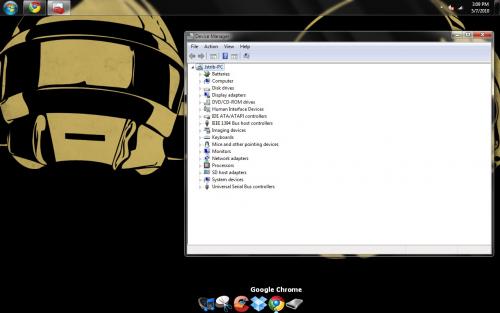

I have went to the bios and the the audio was already enabled, and also @james there is no volume option in my control panel. The whole game controller option is missing.
  • (for Windows XP users)
  • Please click Start and click Run
    (for Windows Vista and 7 users)
  • Please click Start and select the white text box.
  • Type: devmgmt.msc and hit Enter
  • Look for any entries with a Yellow Exclamation Mark or Red X's
Attach it to your next reply

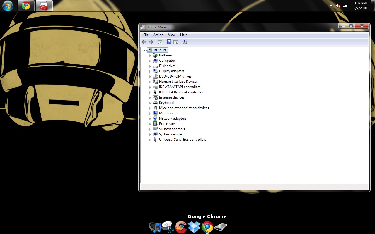

Windows_screen_shot.jpg Here is my screen shot
You have no audio installed at all. Is there audio built onboard on the motherboard?
Do you have a drivers disk that came with the system or the motherboard?
jstribtpt
jstribtpt
  • 20 posts
I originally had sound on the laptop, it just stoped workign one day, and no, the laptop didn't come with any disk drivers.
You may have a failed sound chip then. If that is the case then you would need to purchase a external soundcard for the laptop.
