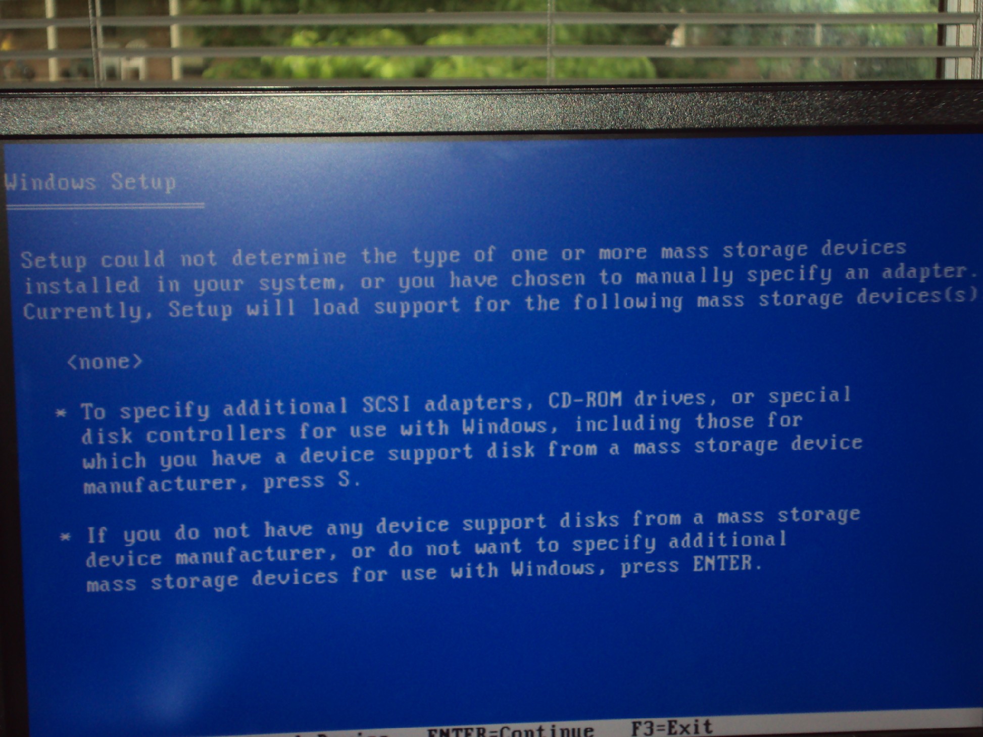

Windows XP does not support SATA drives natively and needs a third-party SATA driver present before the drive can be detected. When you run XP Setup you should see a message at the foot of the screen saying something like "Press F6 to install third party driver". The SATA driver is supplied by the motherboard manufacturer if it's an on-board SATA controller (usually the SATA driver is part of the chipset driver package). If you didn't get a driver CD with the motherboard, check the ECS website support area for the GF8200A here:

When I try this (F6) I get this screen: What do I do next? :)
Edited by hms1018, 23 June 2010 - 08:24 AM.
hms1018
hms1018
  • 15 posts
I tried pressing S, but I have no FDD, and to press enter tells me can't finish setup. now what?
