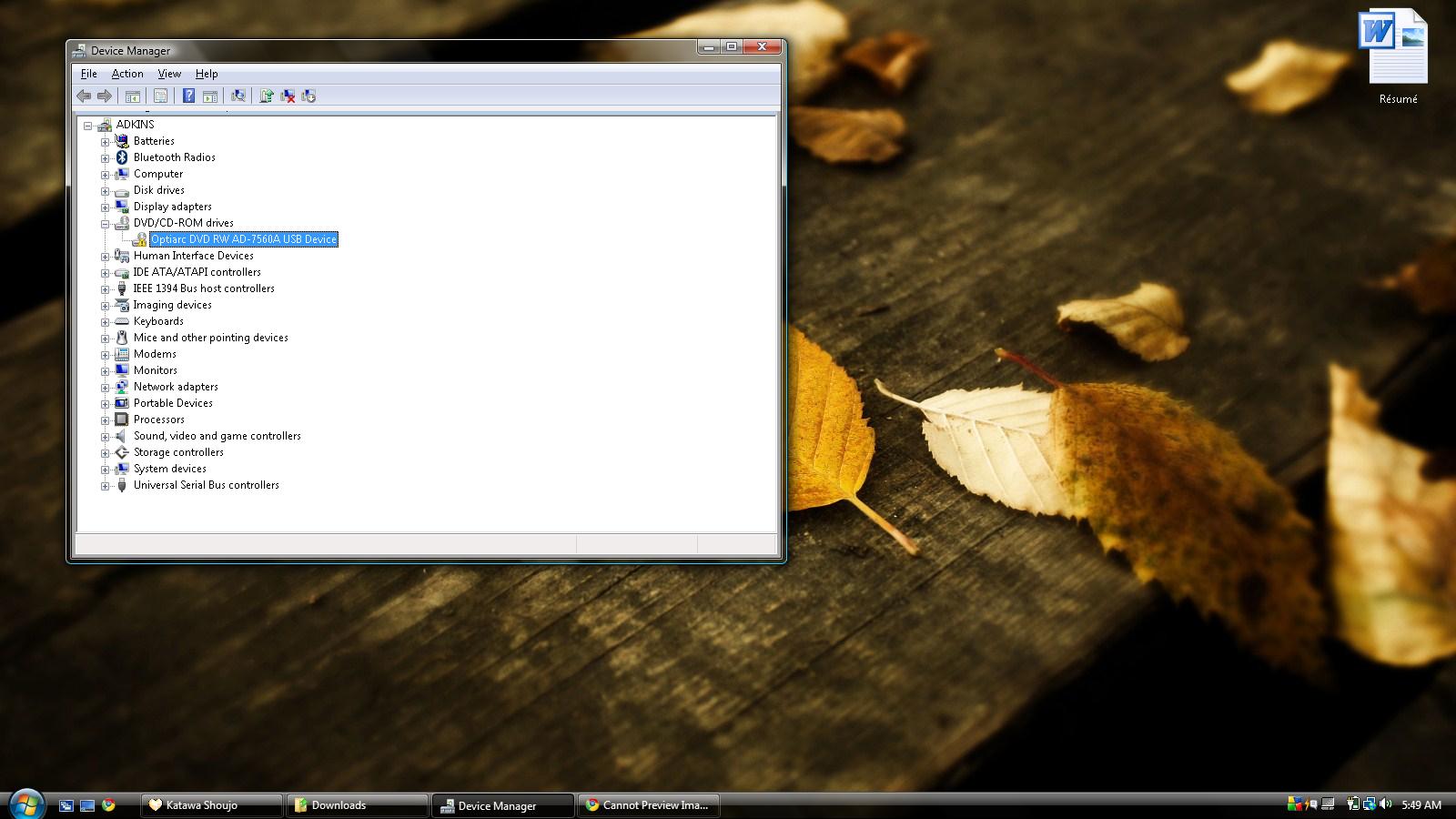

Okay, so I have been on Sony's support and they said this was a Windows related issue and wouldn't help me. I try to install the driver from the site and it says something about not being administrator (which I am) and that the driver I'm trying to install isn't recognizing the hardware.
Here is a photo.
Any solutions?
Not sure what the issue is other then it is seeing your optical drive as a USB drive. Is it a USB drive?
Have you tried a different USB port?
The optical drives do not need a driver in the newer OS's like XP, Vista and Windows 7. They are included in the OS installation.
The only software needed is the media reading software that you would use like Windows Media, PowerDvd or such.
Is the drive seen in My Computer?
Can you explain better what the issue is?

So no it is not showing in My Computer
One of these may help:
1. Uninstall the drive through Device Manager.
Restart computer. The drive will be automatically reinstalled.
or...
2. http://support.microsoft.com/kb/314060
Restart computer.

#2 was the first thing I tried, and it worked.
Thanks so much!
