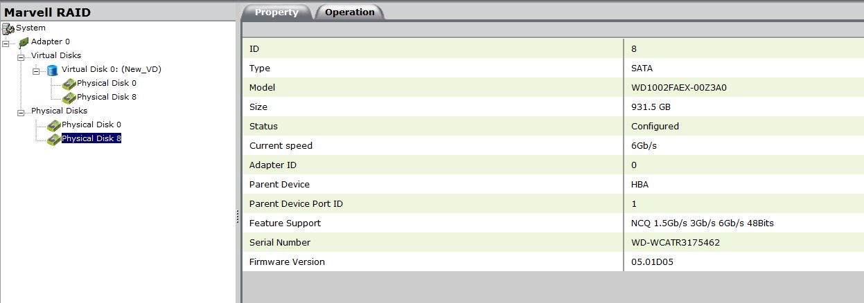

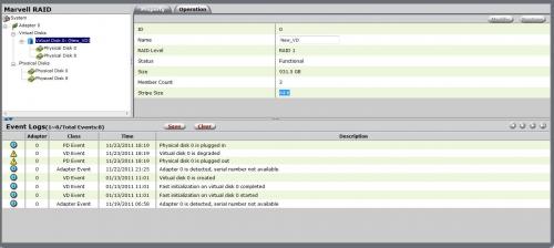

Now that my system is running again. I was able to find and install a MARVELL RAID utility which I installed. Here are the status screens showing the physical and virtual drives:
VIRTUAL DRIVES:
PHYSICAL DRIVES:

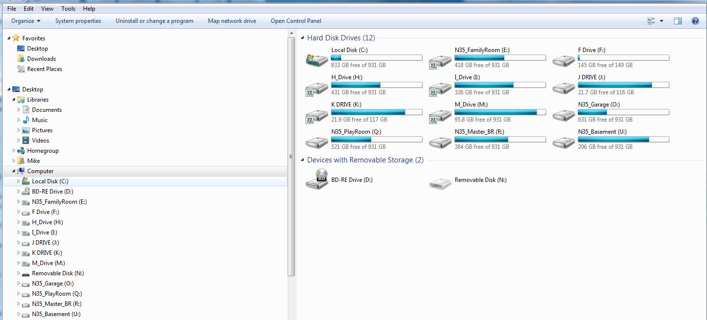

I am going to have to see a screenshot of what you see when you click on my computer...it should look similar to mine...
#80
MSC2
MSC2
  • 82 posts
OK, here's the screenshot. The N35 drives, are network connected drives in media players.

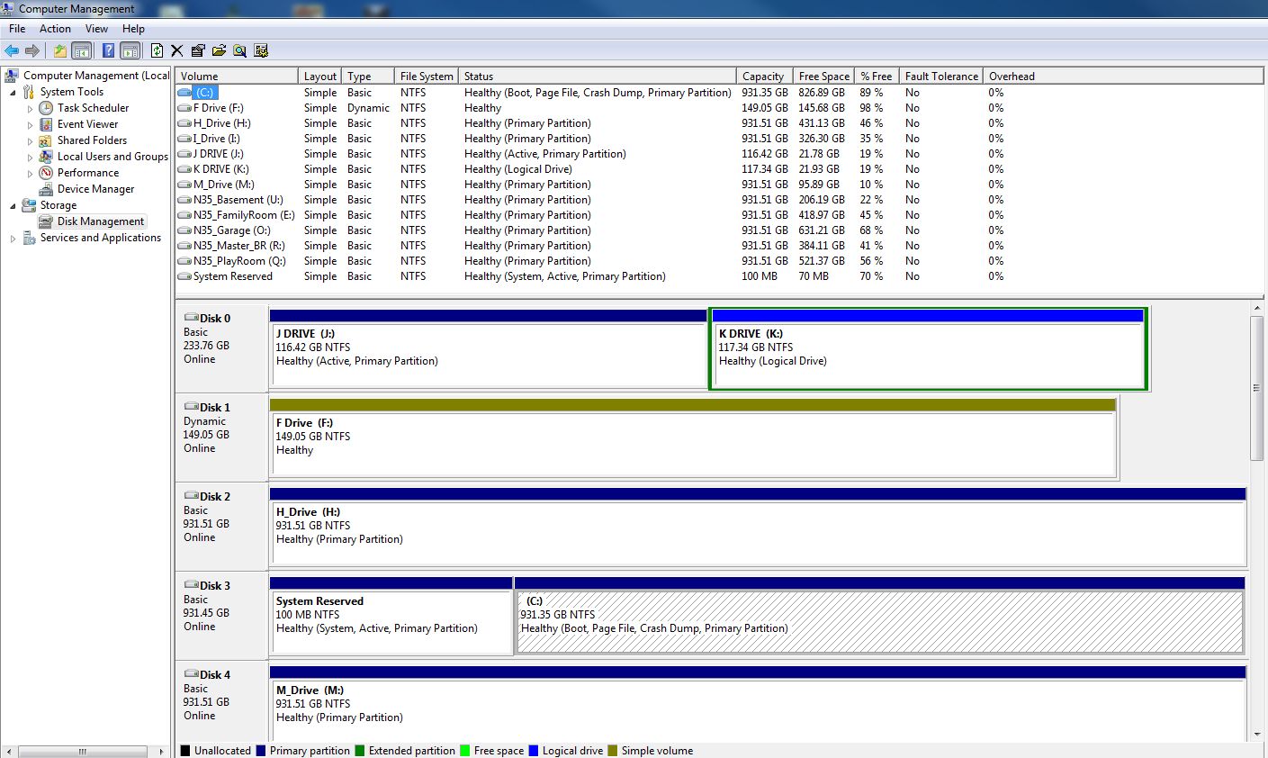

click on the start orb...type in..computer management...select it from the box above..
then on the left side under storage click on disk management...get a screenshot..
#82
MSC2
MSC2
  • 82 posts
OK, here it is:

If I clone the disk will I be copying the physical drive or the virtual drive? and will it copy the windows system file partion as well?
cloning the C drive will be a bit for bit clone...it will be exactly like the old physical drive...after you have cloned the drive just unplug the old drive and plug the new drive to the same controller that the old one was connected to then boot up...play with the system for awhile...happy...then go into the bios to remove the RAID array...you can then wipe the other drive (drive 8 I think) and use it to store backups
