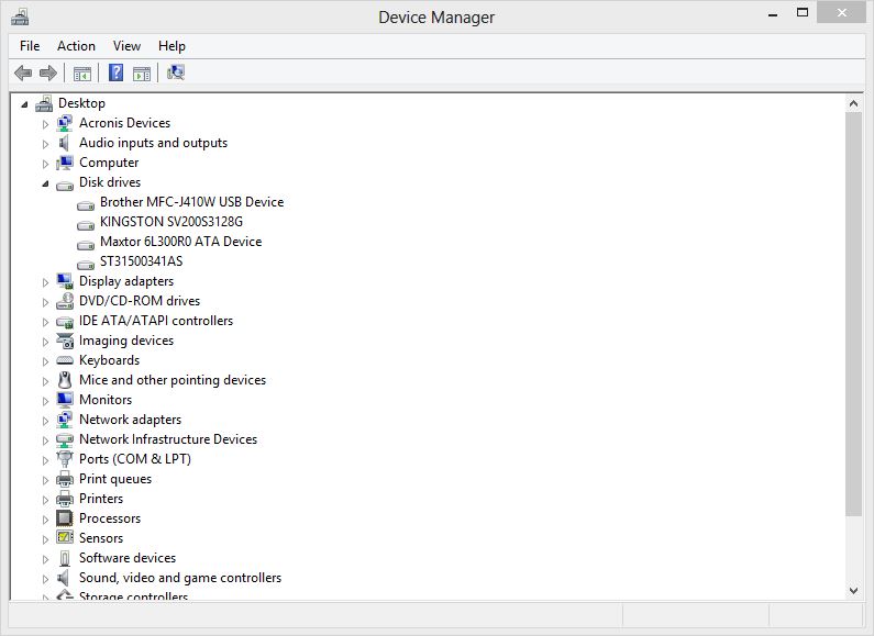

Check Device Manager to make sure:
Press Windows Key (next to left Ctrl key) + the R key.
Type devmgmt.msc and press Enter.
Expand Disk Drives.
That should tell you for sure what kind o hard drive you have.
For instance, mine looks like this:
I have 3 hard drives. Kingston SSD, Maxtor 300GB SATA and a Seagate 1.5TB SATA.

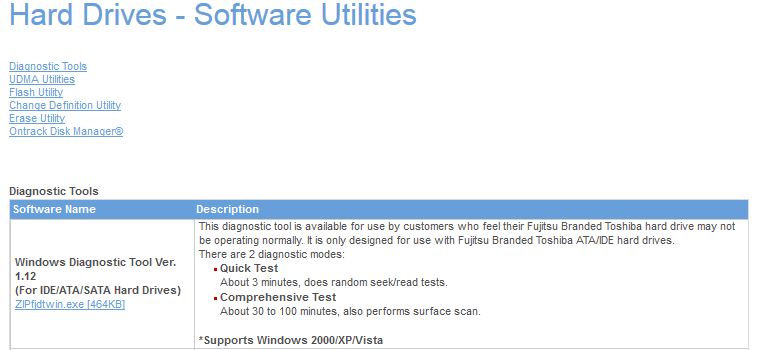

FOr Toshiba, I think you need this: Hard Drives - Software Utilities

I cant bôot into Windows for me to check by device manager. But my bios' default has the first booting order listed as HDD/SSD : Toshiba mk5076gsxn(s1). Lastly how do I use the diagnostic tool? and does it support windows 7? Sorry if i'm asking too much, I frankly know nothing about computers... :/

I don't see any iso files that would allow you to create a bootable CD/Flash drive so I don't think there is any way to check a Toshiba drive if you can't boot Windows.
