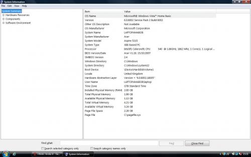

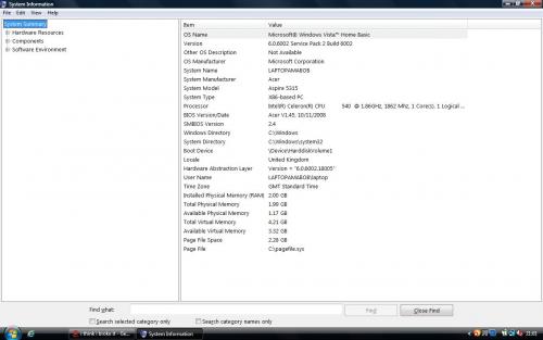

Can you find the BIOS version you have? The information should be presented when the computer starts before loading windows (sometimes you have to press ESC to close the brand logo on screen to see what is behind the image) in some machines the bios version is listed on some information screen inside the BIOS (usually you need to press F1, F2 or Delete to enter the BIOS after power on)
