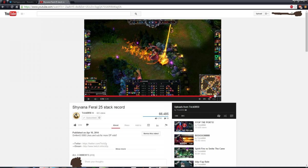

Hey guys so i have this problem. The thing is when i watch youtube videos i can see that the video is a bit blurry and when i crank up the video quality and if there is any text in that video the letters are jagged and hardly readable, the better quality i put on , the worse it gets. The games are also blurry it feels like its on FXAA or something. For example im playing WoW and it doesnt feel the same anymore the graphics with 4x or 8x AA are crisp clean, no jagged edges , no blur etc... Now its hurting my eyes after 10mins of playing. And i have a feeling that my entire Windows might be on a FXAA or similar effect. Cuz the fonts everywhere are slightly messed up. Everything was perfect last week. Can my video card be dying or something?  Ive got the latest video drivers(reinstalled 3 times), running my monitor with an HDMI. I hope this post made sense and pardon my English.

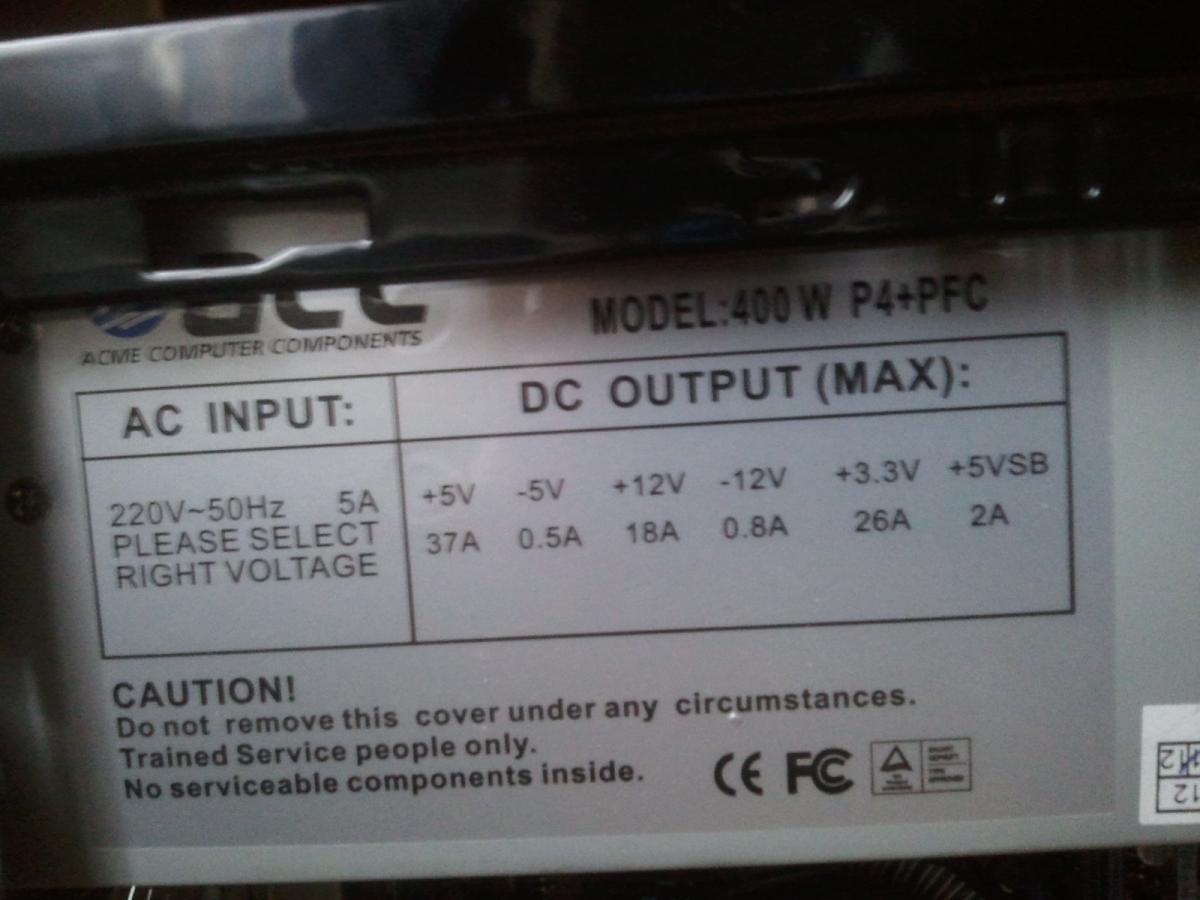

it is important that we know the PSU details, can you take off the side of the case and make a note of what is on the PSU, see the example below.

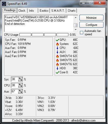

Download Speedfan and install it. Once it's installed, run the program and post here the information it shows. The information I want you to post is the stuff that is circled in the example picture I have attached.

Ok, i have some results , here i go. PSU: ACC 400W Things are hard to see in the screenshots , quality got worse when i uploaded them here :(

So here you can see how messed up my videos are with the text fonts and video quality itself. This video is running at 1080p ive tried 720p looks almost the same. I am forced to watch in fullscreen because its a bit better. But i never needed to watch in fullscreen before.

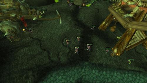

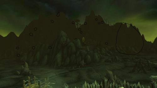

And in here there are some weird dots in this game which ive never seen before, when i move the screen they change too, they appear on textures edges, plus the game is a bit blurry , jagged edges everywhere ,i know Anti-aliasing can blur out the screen, but  i am running 4x AA and the graphics were crisp clean last week, same thing with x8 AA. Disabling AA doesnt help, same blur, same dots, same jagged edges.

It looks like your card is starting to artifact and this is something that can be caused by a poor/underpowered PSU and/or overheating.
You have told us that you have a 400W PSU but not provided a brand  name, this is a major concern as we have no way of checking the reliability or performance of the PSU and this is most likely damaging not just your GPU but also the rest of your hardware.
For a system using a single GeForce GTX 550 Ti graphics card NVIDIA specifies a minimum of a 400 Watt or greater power supply that has a combined +12 Volt continuous current rating of 24 Amps or greater and that has at least one 6-pin PCI Express supplementary power connector.
Total continuous amperage available on the combined +12V Rail(s) is the most important factor here, Antec and Corsair which are two of the best quality PSUs both provide 400W PSUs that produce 30A on the +12V rail whereas cheap no name brands will at best only put out between 15 and 17A, this will slowly but surely destroy your hardware and starting with the item that requires the most power which is the GPU.

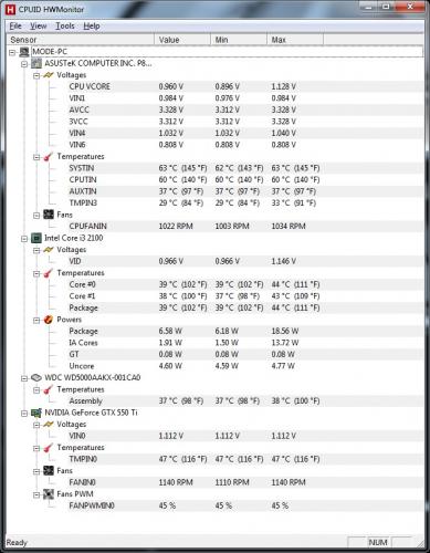

Run HWMonitor and post a screenshot so that we have a comparison to Speedfan, this because the results show high temps and voltages that are out of wack.

Gonna take and upload a photo of the side of my PSU in the morning since it has more info written on it , but for now im going to upload HWMonitor. Cheers and good night.

The HWMonitor results report the same high temperatures of 62C for System, SMIOVT (4, 5 and 6) in Speedfan and SYSTIN + CPUTIN in HWMonitor, these sensor readings all pertain to the same thing which is your MB overheating, this is possibly the Northbridge and Southbridge chips.
What is not helping is the fact that we are not getting the full PSU voltage readings that we need.
Please restart your computer and check the temperatures/voltages in the BIOS, no screenshot is required just make a note of the temperatures and the +3.3V, +5V and the +12V and post them with your next reply.

I also took a picture of my PSU's side , maybe it will clear up some things.

Please note that there is one thing that is possibly worse than using a known poor quality brand of PSU and that is using one that is unheard of, for brands of PSU to trust and brands to avoid please refer to the attached links http://www.10stripe.com/featured/psu/brand.php and http://www.pcmech.com/forum/showthread.php?t=208143
