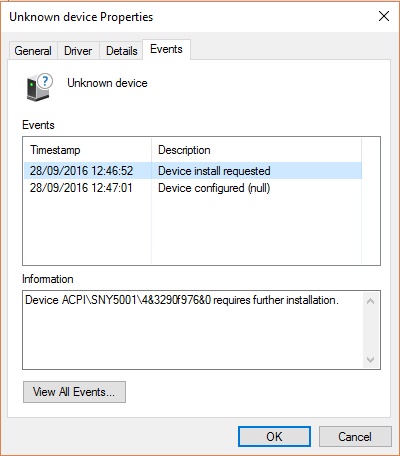

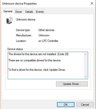

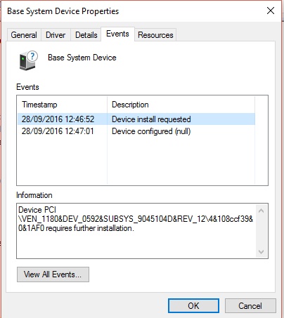

I was tring to solve a problem with an SDHC card purchased for my Android phone (see http://www.geekstogo...t-detected/)andtried inserting the SDHC card into my Windows 10 notebook. The notebook wouldn't recognise the card, but when I went into device manager I noticed that there are 2 devices in there which are showing up as having no drivers. I do not know which devices this relates to, but I will post screenshots  at the end of this message.
My notebook is a Sony Vaio vgn ns20e on which I did a clean install of Windows 10 a few months ago (it was previously running Vista). It seems that wherever the problem lies, it has apparently existed since the date of the upgrade.
Some screenshots to follow: -
Any ideas what these refer to, or what can be done to remedy the situation?

"Ricoh® PCIe Memory Stick® Host Controller Driver"

This driver will install the originally shipped version of the Ricoh PCIe Memory Stick Host Controller for the Sony VAIO computers.
*** The Ricoh PCIe Memory Stick Host Controller is for the yellow exclamation showed as a name "Base System Device" in Device Manager window if the driver is uninstalled.
After installing this driver you can use your SDHC card.

I tried installing the driver from your link, but it told me it could not be installed on my system.
I tried a driver from Dell which rather strangely actually did install on my system (I think it mentioned compatibility mode) .... although I still cannot get the SDHC card to be recognised.
Device Manager now only shows the unknown device as needing a driver. (There is no mention of the Base System Device now).

Please right click the Unknown device and from Details tap copy and paste Hardware Ids to your next post.

I think this is the info you wanted.
ACPI\VEN_SNY&DEV_5001
ACPI\SNY5001
*SNY5001

You already said you have installed the memory card reader driver. Windows 10 compatible with Windows 7 and later versions of device drivers. Please visit your laptop manufacturer website to download latest device drivers. The Unknown Device is: Sony Firmware Extension Parser Device.

I cannot found drivers for your laptop are you sure about the model number?
I would not advice installing device drivers other then computer or device manufacturer  website.
Try below driver.
"Sony Firmware Extension Parser Device Driver (Windows 7 32bit/64bit)"
https://www.sony.co....nloads/Z0005155

Ah success.... that one has worked! :thumbsup:
The daft thing is that I tried that one before and wasn't quite sure what to do with it as there were a few files included with it and I wasn't sure what to do with them - and at that stage, I thought they wouldn't be any good anyway as they were for Windows 7. :( This time I took more time finding out what to do! :
