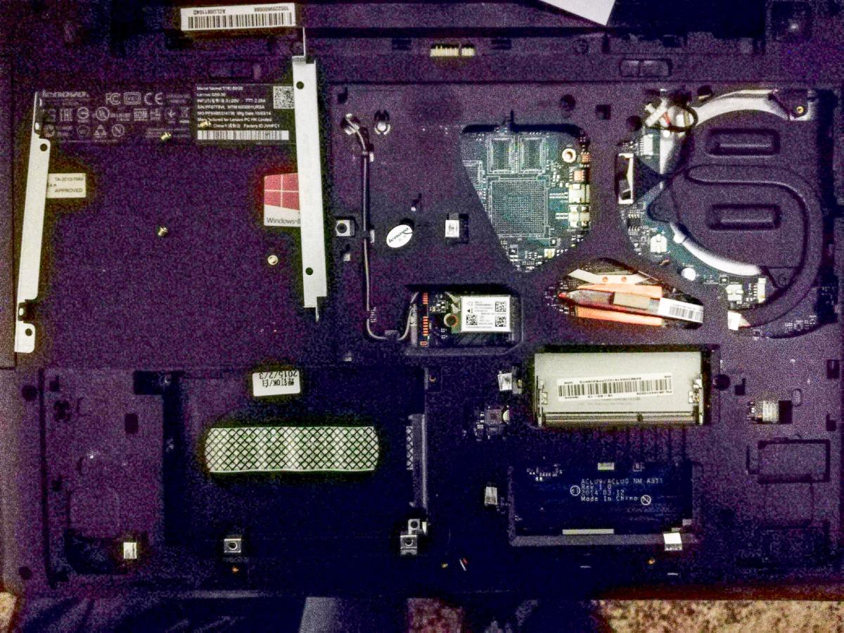

I just removed the RAM
Sanelleh
Sanelleh
  • 9 posts
I took out the RAM and the hard drive

With the RAM still removed from the notebook, connect only the AC adaptor, press the power on button and let us know if there is any change in the previous behaviour.
No need to have taken out the HDD btw  :thumbsup:
