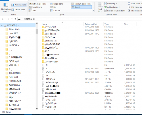

I have a brand new external H/D Intenso 4TB Memory Center USB3.0 compatible USB 2.0- I am running windows 10 installed on an HP Compaq 64 bits o/s.   I copied a lot of files (coreldraw, excel, pdf,word, images,etc)as  I wanted to keep all my files on this drive as they were on 5 diferent keys and H/D before that. For a few days all was well but then , one morning,  all folders bar 1 have been renamed with weird symbols and characters. The drive was nearly full  and I tried to delete some files but not possible.
I would like to recover as much a possible  and tried recovery software to no avail.

Corrupted NTFS file system could be the cause of the problem.  Please open the Command Prompt by simply holding down the BxVxp04.png + X keys and select the option “Command Prompt (Admin)” from the menu.
Execute following command to locates bad sectors and recovers readable information:
Chkdsk  X:  /r
Replace X: drive letter with external HDD drive letter.

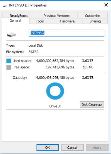

Now  property shows it isFAT32 with both used and free space at 0.
If all is lost , so be it but what do I need to do in order to use the H/D  from now on?
Many thanks for your help
