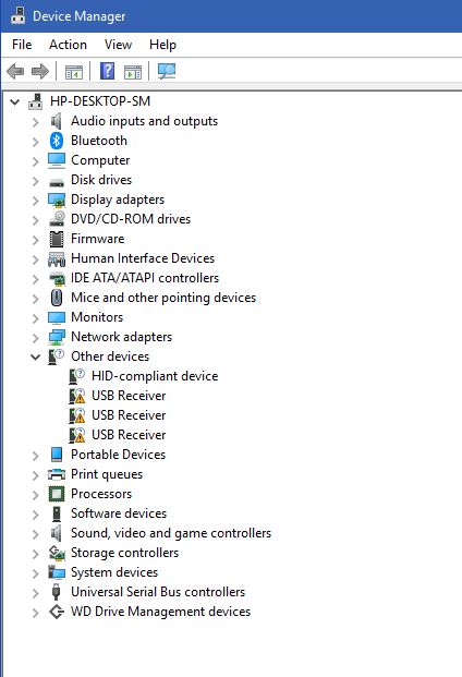

I am running windows 10.  I updated iTunes and once I rebooted after the update my keyboard stopped working.  I bought a new wireless keyboard with dongle as my previous one was and it still does not work or show up in device manager.  Tried to delete the low filter item in the keyboard registry but did not help.  Mouse works fine and using on-screen keyboard to type this.
Screenshot of device manager is attached

Did you also recently install any updates for Windows 10? Probably the easiest method for you without a keyboard is as follows:

There is a known issue that windows update KB4074588 is causing issue with mouse, keyboard and USB ports not working. Please try the following steps.
Windows Key + R
appwiz.cpl
View installed updates
Look for update KB4074588 (OS Build 16299.248)
Right Click it. Uninstall it.
Reboot and test.
