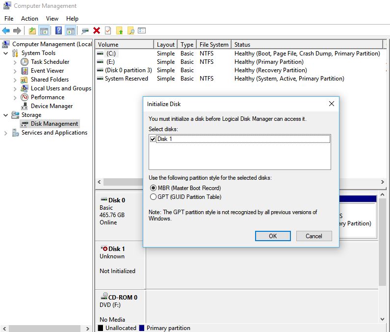

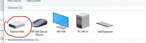

 External Hard drive WD1600BEVS/160GB unknown, not initialised and no space showing in windows 10
How can i solve and safely get all the data?
Please kindly help, Tank you in advance
In devices & printer i troubleshoot
There are problems with some PnP devices. Windows will take additional steps to further troubleshoot these device

Based on this first should i initialise the disk OR try to remove drive from case and use with another enclosure/ adaptor , which should be do first ?
