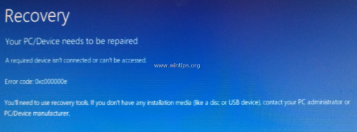

Hello, i recently built my own PC , I installed my OS via a USB and my main boot drive is my SSD (C:) drive. I sometimes get a blue screen while booting with a message of "A required device isn't connected or cannot be accessed " or something similar to this. It's around 40-50% of the times i boot my PC that this happens, and i thought it was odd that it was only sometimes and not every time. The only thing i really read is using the windows repair function with the boot device but i unfortunately don't have that, but i can re-download the same OS onto the USB and attempt this? i was wondering if anybody here would have any input re-guarding this before i attempted that.
What you described in your OP suggests a possible loose cable to the boot device, is the SSD out of the box new and have you checked that both the SATA and the power connections are secure.

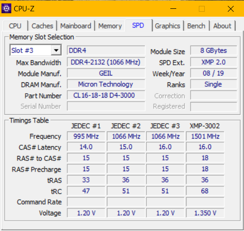

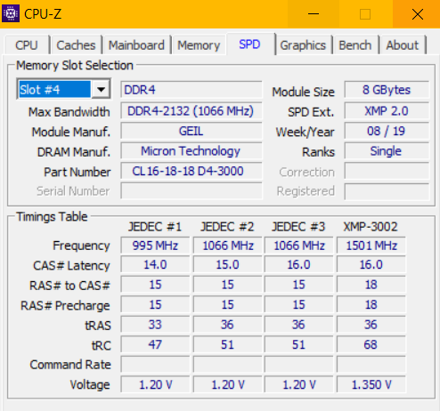

Also, not to knock speccy, but i used CPU-Z (CPUID) and got results for SPD.
As an asides, you are right as Speccy does not always get it spot on, one should keep in mind though that CPU-Z is specifically designed for hardware detection whereas Speccy checks for and reports whatever it can find for all hardware and all software, AV, drivers, OS (including updates) and any third party software that is installed, not bad for a free program imo.
