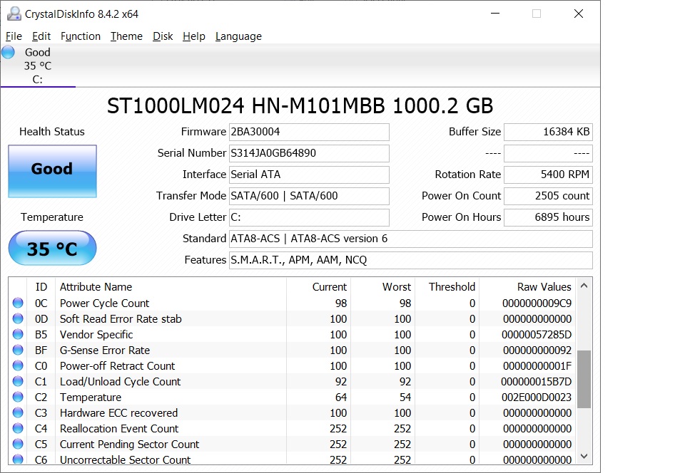

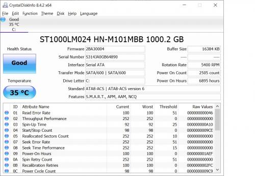

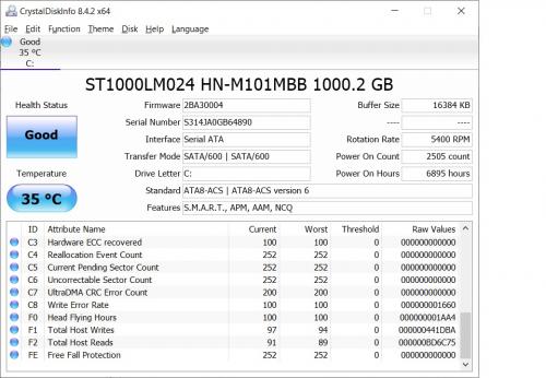

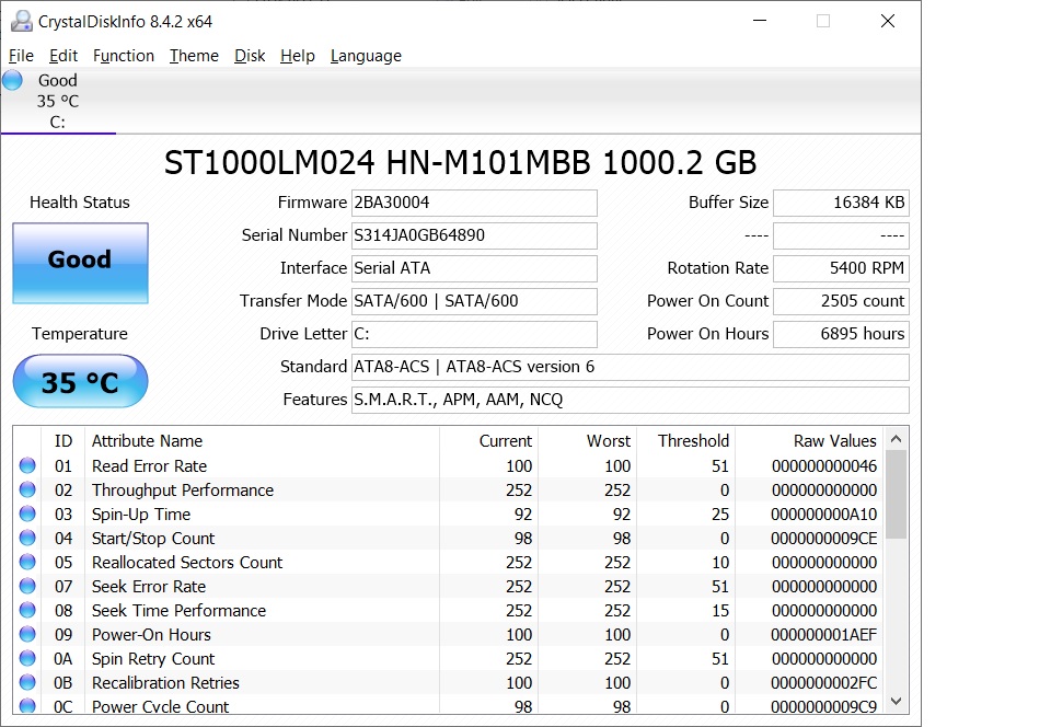

  • 40 posts
Thank you for the instructions.  Here are the CrystalDisk results.
Again, thank you so much for your help.

  • 24,334 posts
No problems at all with the HDD.
