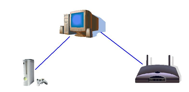

Hey all I’m having trouble connecting my XBOX 360 to my PC. My setup is as follows:
I have a router with an inbuilt ADSL modem this is connected to my phone line to allow me to connect to the internet (This is in a separate room to where my Xbox 360 is)
My PC is connected to my Router using a wireless PCI card
My Xbox is connected to my computer using a CAT-5 cross over cable (My Xbox 360 is in the same room as my PC).
I have media player 11 installed on my PC
When I try to connect to my PC using my Xbox to share media files it can’t detect my PC I get the following:
TEST MEDIA CONNETION
Network Adapter ----- Wired
IP Address ------------- Confirmed
PC selected ------------ Failed
I try and search for my XBOX using Windows Media Player 11 but it can’t detect it can anyone help
P.S.
I CAN connect to XBOX live and play online games but that’s about it

In order for XBOX 360 to see the Windows XP's Windows Media Player shared media, you need to verify:
1. The "IPSEC Services" service is set to start as "Manual" (is what Microsoft states, though i have a Laptop working fine with it on Automatic).
2. XBOX 360 scans its subnet trying to reach TCP port 10243, make sure port 10243 is open in your Windows Firewall.
3. Port 10243 is started by the application WMPNetwk.exe, verify with netstat or Active Ports that TCP 10243 is actually OPENED when WMP11 should be sharing the media, sometimes things get messed up in the System, and WMP11 will just not open that port, even if everything is setup as it should.
The issue could be related to the activation of IPv6 under Windows XP Professional (is when mine stopped working).
Still have not found any solution.
Oblivionon360
Oblivionon360
  • 261 posts
Also to add to what has been said already, I recently had the same problem untill i realized it was my after market firewall. I currently use norton 360, and it provides me with an option to allow a certain Ip to access my computer. it was an option under the firewall settings. So i had to create a static ip for the xbox and once i did i allowed that ip access to my laptop at all times and it fixed my problem.
