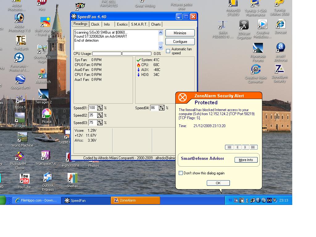

#249
Posted 21 December 2009 - 05:17 PM
#250
Posted 21 December 2009 - 05:22 PM
Hello rshaffer61
Hope you got screen shot.Hope there was nothing nasty in the download as I told it to run.I usually save to desktop and then run virus checker before running.Zone Alarm threw up two alerts.
With best regards,
Dave.
With best regards,
Dave.
#251
Posted 21 December 2009 - 05:30 PM
oK CPU seems to eb running alittle warm.
I see no fan speeds running and the fan speeds are running at less the 100%.
Can you click on the left fan speed controls and boost them up to 100% and see if that helps with CPU temps.
Run it for a minute or two and get new readings for me please.

#253
Posted 21 December 2009 - 05:49 PM
Hello rshaffer61,
OK gotPC running and raised all fan speeds up to 100%.System at 40C,CPU at 65C, AUX at .48C,HDO at 37C.
Still no fan speeds showing but they are running for sure.
I notice no CPU usage.
With best regards,
Dave.
With best regards,
Dave.
