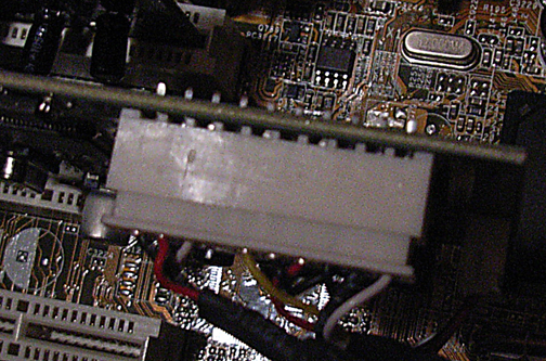

Attached is photo of the troublemaker,as you can see I have managed to raise up the right hand end a fraction but gave up as I do not want to use too much force and end up breaking it.

What is this card?

Hello rschaffer61
On the back of the computer it says TV in.If I want to I can connect to a TV aerial and take in analog signals and they get converted to digial or I can take in digital directly and watch on the computer.I have never bothersd to use it as we have TV in the lounge.

Ahh a tv tuner card. I figured it is probably wedged in good then if it has been there for a long time.
As long as you don't grab the silver part and try to pull it out you should be ok. If you don't ever plan on using it I see no reason to put it back in the system. We may be able to uninstall some programs that are associated with it and then open more space on your drive.
Take a good look at it and make sure there is nothing else holding the card in place other then the same as the other cards.

Hello rschaffer61
I will have to disconect it to remove the card, there is no other way to do it.

Can you tell what the silver box is? I would hate to see you destroy the card even if it is not going to be put back in to the system.

Hello rschaffer61
I do no know what the silver box does except to say that the TV plug in point emerges from it.I must undo these connectors so that I can pull to one side the thick cables that run to them otherwise taking out the motherboard will be impossible.
