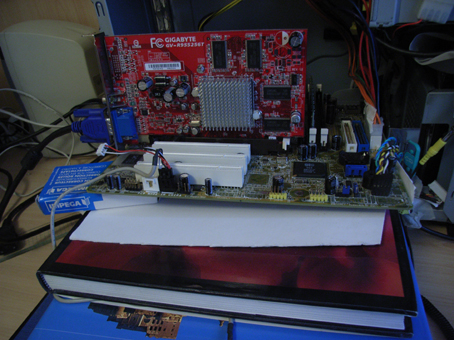

When you start the system it will be as if the motherboard was inside the system but we're taking out the posibility there is a short between the motherboard and the case.

I understand the idea of running the mother board ouside the case but unless the IDE cable is plugged in then I will never be able to check the mouse.The problem all along has been freezing at various stages right from the momment the computer is turned on to the point when Windows has loaded along with all of the other progammes that load on sart up.Sometimes it would run for minutes,hours or for a whole day but eventually it would freze the sympton being that the mouse would freeze usually at the screen centre.Obviously the feeze ups occured when the mother board shorted out on to the case.
Should I now start up the computer and the monitor?

Did you connect the ide as I instructed in post # 118?
I forgot about the issue only happens in windows so you will need the hard drive to be connected and make sure there is power going to it. Then yes monitor and system turned on

You would connect the one going to your hard drive and it would go to the connector on the motherboard marked IDE0

I have identified the ribbon cable going to the hard drive and can see that it will only fit one way round What does the other IDE cable do?
I will have to plug the mouse into a USB port on the front of the machine because there is no room with mother board in its present position, nor will I be able to plug in the keyboard.

The other IDE cable most likely goes to your DVD\cDrom drive
Is you Mouse and Keyboard USB?
Can you get a pic of the setup as it sits right now?

OK the reason I aksed is because the front USB probably will not work since you unhooked everything from the motherboard. So you will have to connect everything to the motherboard to work properly.

I am suspending operations for today because on studying my set up I have thought of a much better spatial arragement.I am going to turn the computer on its side again and I am going to bridge the opening with a piece of plywood.This will be stiff enough to withstand any down force when connectig the IDE cable and it will be easier to plug all the connectors in without having the cables at full stretch.Also It will enable the keyboard and mouse to be plugged into the mother board.I will of course put a piece of soft cardboard on top of the plywood.So it's off to the timber yard tomorrow morning.

At last after a day of domestic duties I am back at it. My idea of putting the case on its side and spanning the opening with a piece of plywood has worked.I glued 2 layers of card board on top of the ply to act as a buffer as ply is quite hard.It was a close run thing once again as cables are just not long enough for this kind of thing.I've had to elevate the mother board bottom left because the metal plate on the graphics card kept pushing the card up at one end.Also the IDE and P1 multi power conector block took quite a bit of pushing to get them seated.I will now list what I have done to see if I have got every thing,
Computer main power supply plugged in and switched on at wall power outlet point,
Keyboard PS2 plugged in,
Mouse PS2 type plugged in,
Small Pentium 4 power connector plugged in,
IDE ribbon cable plugged in,
P1 multi power connector in place,
Computer start/ reset plug is connected,
Monitor connected and turned on at wall power outlet.
I think I have got it all set up to go.
Would you like photo of set up? I do not think it shows any thing different to my last photo except this time I have been able to plug in Key board and the PS2 mouse.

Nope now you just need to start it and see if the mouse freezes now since everything is outside of the case. Good luck and I will await your results. Run the system for at least a hour to see if the issue returns. If it doens't then I think we may finally be able to figure this out.
