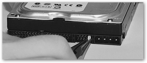

I got it out of the gateway finally, how do I change it to slave? Model GH15F

The jumper will be on the rear of the drive near the power connector. It will be a small plastic block that connects a pair of pins and should be set to the Master position now. There should be a diagram on the drive's label that shows the jumper positions for Slave, Master, or CS (Cable Select). You'll want it jumpered as a slave. When you install it in the Dell, install it to the center connector on the same ribbon (IDE cable) as the Dell's hard drive.

I see where the cable select, slave, master is on the Dell Hard drive... but not on the gateway... it's way different

Is it a SATA drive? If it is, you'll probably have to get an enclosure in order to connect it to the Dell.
In the Gateway, was the drive connected with a small cable while the Dell drive connects with a wide, flat ribbon cable?

yeah, different connections. In the gateway it is a real tiny connector, and a small connector with 4 other wires. In the dell it is the big grey ribbon connectors and a 4 wire connector. scroll up, I posted pics.
