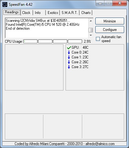

Downloaded it, installed it, run it twice. It does not show as much information as yours. Here's the screenshot.
and here is whatever in the white box.
Win9x:NO 64Bit:YES GiveIO:NO SpeedFan:YES
I/O properly initialized
Linked ISA BUS at $0290
No active display found!
Found nVidia GeForce GT 335M
Linked nVidiaI2C0 SMBUS at $3D403E3F
Linked nVidiaI2C1 SMBUS at $3D403637
Linked nVidiaI2C2 SMBUS at $3D405051
Scanning ISA BUS at $0290...
Scanning I2CNVidia SMBus at $3D403E3F...
Scanning I2CNVidia SMBus at $3D403637...
Scanning I2CNVidia SMBus at $3D405051...
Found Intel® Core™ i5 CPU M 520 @ 2.40GHz
End of detection
Edited by dragonthrone, 06 November 2010 - 08:51 AM.
OK that didn't show me much except your temps seem to be good.
