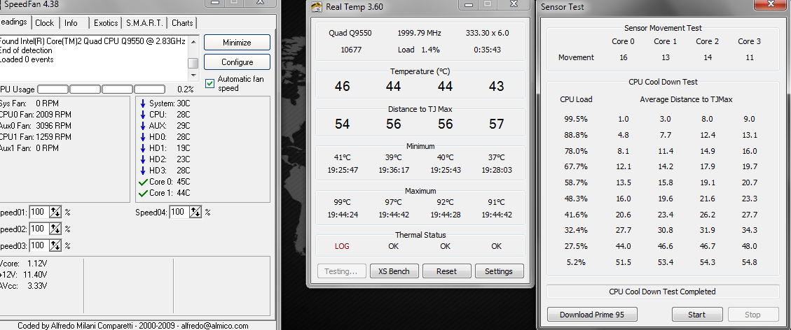

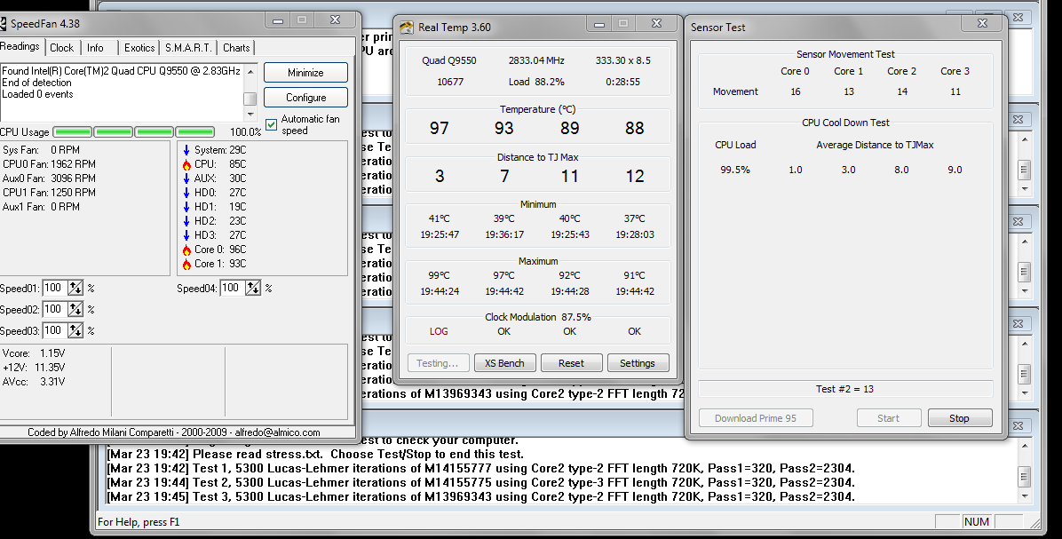

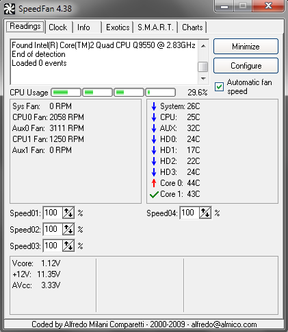

When I was using UBCD it would only crashed when I ever I was doing a test. So I went to the store and bought a fan so it can bring in air, an while I was plugin it in I saw that one of the cpu screws was lose so I removed just to see if anything happen and the paste was mostly dried out and the paste on the heat sink was partially burnt so i clean and reapply and did another senser test to see if that fixed the problem. it did, an i would like to say thank you for helping me out.

Nice detective work and if the fan was loose and the TIM or Thermal Paste was burnt that bad then it would answer for the abnormal testing results.
Great catch and please let me know what happens with playing a game.
