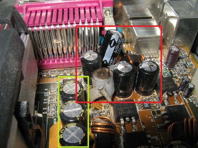

The blue screens you're getting can be caused by a number of things, including the issues we'll test for in these next steps. There is more we can do after this, if you're still willing, but this is a good start.
  • First a physical examination. Take the side off of the computer (on yours, should be the left side as you're facing the front of the machine) and peer inside, but don't touch anything. Look at the capacitors, which look like little cans on the large board (motherboard) inside. They should be perfectly flat across the top, perhaps with a small X shaped pattern on the top. Any bulging or leaking of a normally tan-colored material is very undesirable.
    This is an example of blown capacitors - the one that's unwrapping is an extreme situation. Normally I see ones swollen like the two to the right of the unwrapping one. They're still quite bad.
    The ones in the green box look good. The ones in the red box look bad.
    Also look for heat sinks that might be clogged with dust. Clean that with canned air, and take care not to over-spin the fans. If the fan you're directing air at whines, it's going too fast.
    When you're done with the physical examination, post back with your findings.

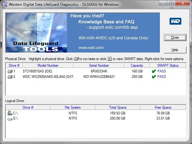

  • Lastly, a hard drive test.
    Download Data Lifeguard Diagnostic for Windows. Extract the files from the .zip file into a folder on your desktop. Double click the WinDlg.exe file (you don't have to run the setup file), and follow the instructions below:
    Accept the license agreement, press Next.
    The software will detect your drives, and present you with the main screen:
    Highlight your WD400BB drive (should be the only one in the list), and right-click on it. Choose "Run Diagnostics". Run a Quick Test, then run an Extended Test when the Quick Test is done.
    If both tests pass, we're done with hard drive testing. If either one fails, please let me know right away.
Please post back with the results of your physical examination, the RAM test, and the hard drive tests.
