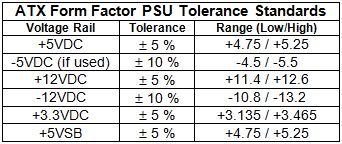

If that doesn't work then check if you have a faulty RAM by using MemTest86+.It is an ISO file which you should burn to a disc and boot and start the memory test.It must pass atleast 7 tests.Also check if your PSU/SMPS is fine.You must get yourself HWMonitor and check/compare against the standard values provided with the attachment.

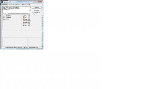

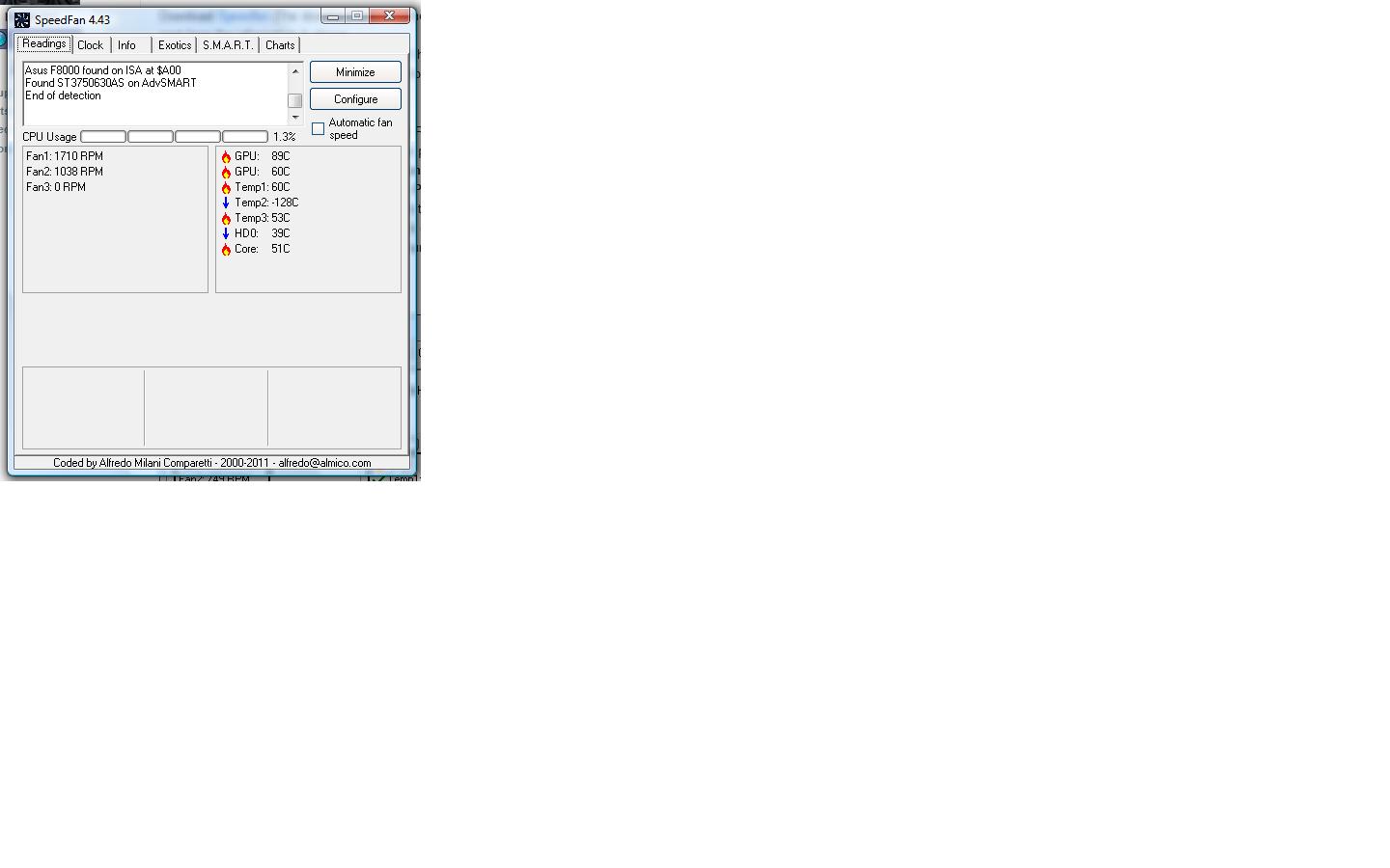

Here is the speed fan window - it did not have the info in the lower section per the example:
OK since it showed nothing then we can try Hardware Monitor

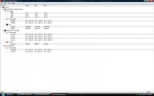

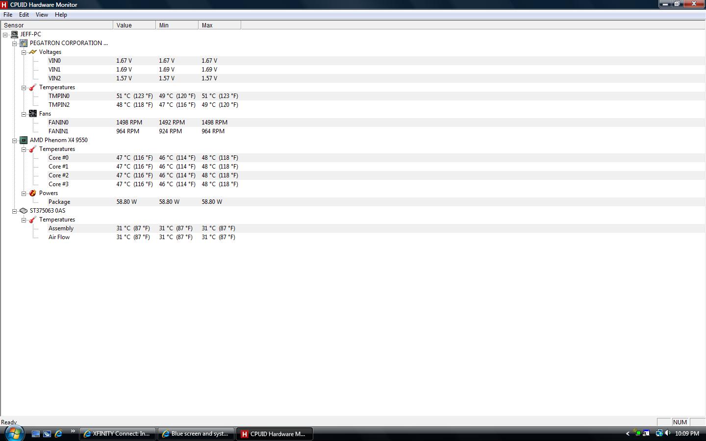

Here is thhwmonitor.jpg e HWmonitior screen:
Ok that isn't showing voltages either.
So next step is to check in the bios itself and see if it shows the voltages in there.
