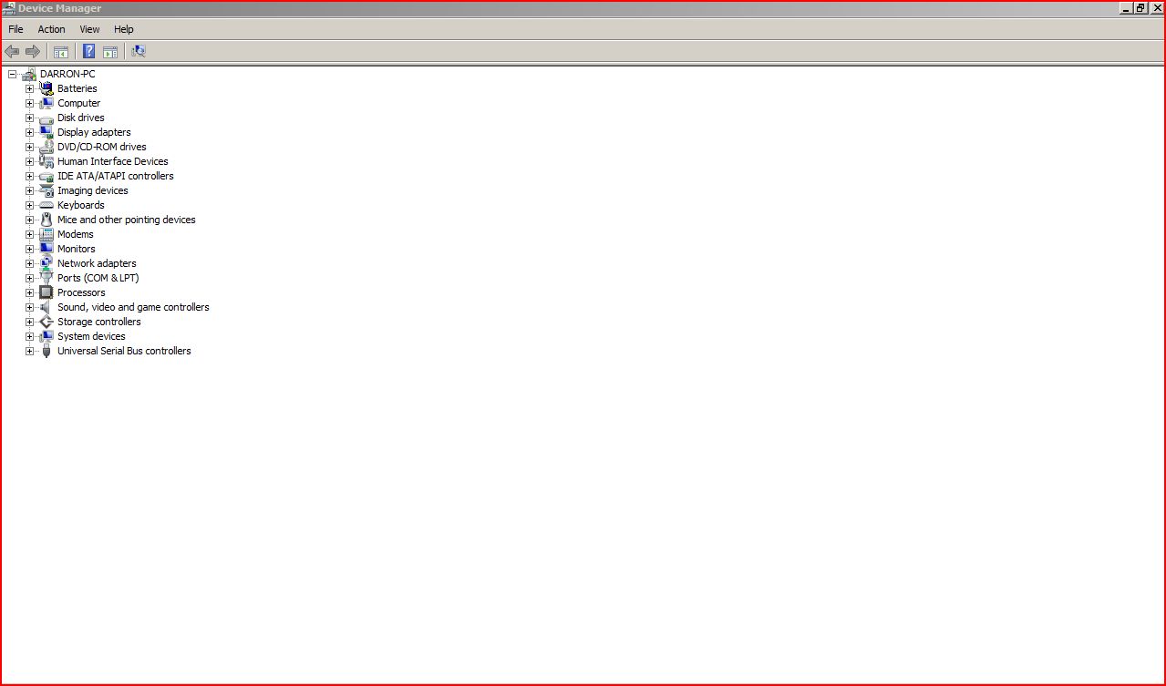

Hello
I'm afraid you have a bad Hard Drive. I'll tell about this on the techs to see what they suggest. For now follow this:
1. Open the Start Menu.
2. Click on All Programs and Accessories, then right click on Command Prompt and click on Run as administrator. (See screenshot below)
3. In the elevated command prompt, type:
chkdsk /f /r
It will ask you to run chkdsk at the next boot type Y and press enter.
4.Reboot and don't touch any key, let chkdsk scan your Drive.
5.When it finishes, read here on how to find the chkdsk log and copy it and paste it in your next post.
Next:
Open Device Manager by clicking the Start button, clicking Control Panel, clicking System and Maintenance, and then clicking Device Manager.‌ If you are prompted for an administrator password or confirmation, type the password or provide confirmation.
Expand the window so all the devices appear and take a screenshot of it and post it here.

Hello
Windows replaced bad clusters in file 220986
of name \Windows\winsxs\X817D6~1.228\mstsc.exe.
You may want to retry a scan to see if it still stalls, however it's not required. Your drive is most probably failing:
Read failure with status 0xc0000010 at offset 0x2a0b555000 for 0x10000 bytes.
Read failure with status 0xc0000010 at offset 0x2a0b561000 for 0x1000 bytes.
I can't help with this as I'm a malware tech. Your computer is clean, so here is the speech to remove the tools we have used and security measurements to stay clean. After this, you can post a new topic at the hardware forum and include the link to this topic in the post as well as a description of the problem. :thumbsup:
