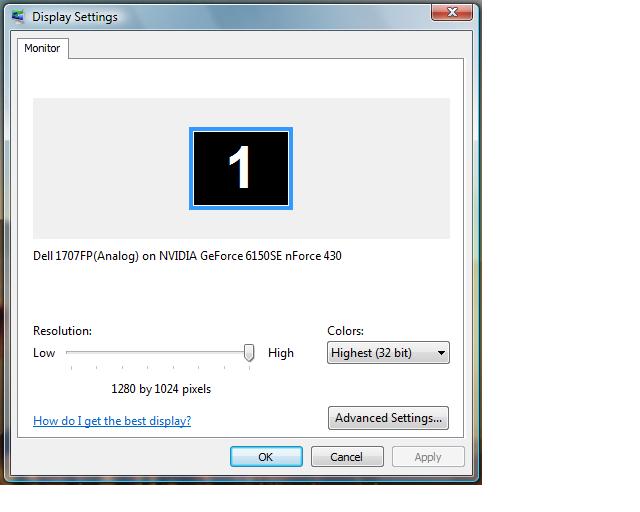

Posted 15 January 2012 - 10:49 AM
This looks very much like a hardware problem - video
What resolution is your screen set to ?
The two ini files are system files and we will rehide them later

Posted 15 January 2012 - 11:42 AM
which disc check should i run, the one which fixes or the one with just a report.
i have adjusted the resolution down a bit. may be a bit of track but i do have an nvidia grforce 320, i could install if you think its a card issue?
Posted 15 January 2012 - 11:44 AM
If you have another video card and the drivers then yes use that
Get check disc to repair errors
