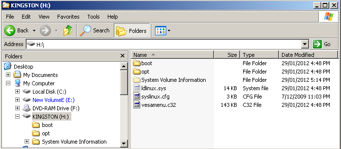

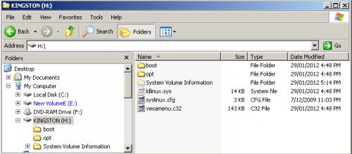

  • 37 posts
Hi maliprog
Tried to follow your instructions as closely as possible.
Formatted a USB drive, ran exe file & made sure that I used the correct iso file.
ZoneAlarm warned me that unetbootin was trying to access the internet so I stopped that access as I assumed that was installer trying to get linux from the internet.
The procedure appeared to run OK & I closed it down as per your instructions. I've included a screen shot to show what files are on the USB stick. I noticed that there is a linux.cfg file there.
When I inserted the USB into my sick PC & constsntly pressed f12 it wouldn't show me the USB but just booted up as per normal.
I tried a number of times - pressing f12 constantly from when I turned the PC on uptil it booted.
I tried a different USB stick in case there was a problem with the USB but to no avail.
Is it possible that there is something not set in the BIOS which prevents it booting from a USB or removable device - just me clutching at straws.
thanks for your patience.

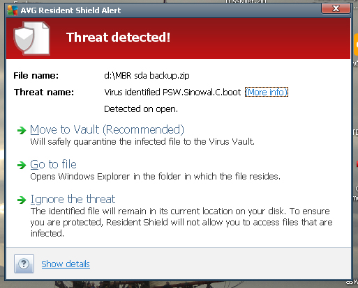

  • 37 posts
Booted up from the USB & xPUD ran as per your directions
where the folder list appeared my HDDs appeared as sdb1 & sdb2, the USB was sdc1
I typed in the script as per your instructions & then wondered if "=/dev/sda" referred to the HDDs so reran it & substituted sdb for sda.
Tried to attach MBR sda backup.zip & AVG wouldn't allow it - said it contained a virus, see attached jpg.
MBR sdb backup.zip attached OK
If MBRsdb should be sda, I'll rerun the process.
thanks
#40
maliprog
maliprog

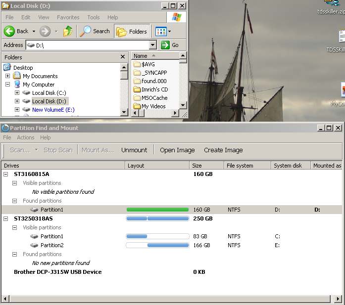

  • 6,172 posts
You did good job. AVG reported this file but it's false positive.
Can you try Partition Find and Mount. Please read Quick guide and see if you can get your files back with this Free tool. It's very easy and safe tool. Try both your HDD and see if you can get your lost D partition.
#41
me4ever3131
me4ever3131
  • 37 posts
Maliprog - that seems to have worked beautifully. See the attached screenshot.
I've opened the folders on the restored D drive & everything seems to be OK.
Can I ask some final questions?
1 - I'm interpreting the screen shot as showing C & E as one physical HDD & D as a seperate physical HDD, is that correct because if it is I've mislead you earlier. I was very definite that the E drive was a physically seperate drive.
2 - I've been using AVG as my antivirus software, do you thing AVAST is better? - perhaps you aren't supposed to comment on different programs.
3 - These antivirus programs you got me to download & run - can they just be used generally every so often to keep my system clean
Thank you so much for your time & effort it is really appreciated.find&mount2.jpg
#42
maliprog
maliprog
  • 6,172 posts
I asked you specifically about this. In Disk Management I saw this and that was very misleading to us. You give us a lot of had headache :). Do you confirm now that D drive is separate HDD on your system?
My personal favorite between these two is Avast.
NO. This is really delicate programs and all output from them need to be double checked. You can only use VRT once a while on your own. It's stand alone antivirus solution and you can use it to double check your system.
We are not done yet with your D drive. This is only recovery step for your data. Your partition is lost and you'll need to reformat this drive again.
Please backup your data now. After that get back and I'll prepare initialize and reformat step for your drive.
