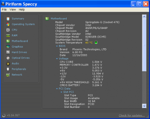

A good way to find out the motherboard model is to download CPU-Z:
You ever use Speccy? It too will provide details on every piece of hardware in your computer. I totally forgot about this program. I installed both and came up with the following:
Springdale -G
I've included a snip from Speccy so you can visualize what/how the program displays the info retrieved.
Edited by DonnaB, 14 May 2012 - 06:17 AM.

Ok, so it's an Intel board.
Hold on a minute.
