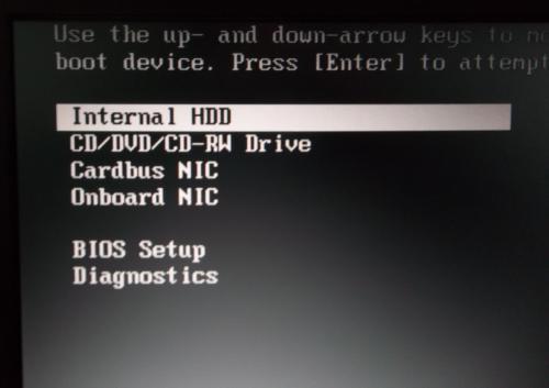

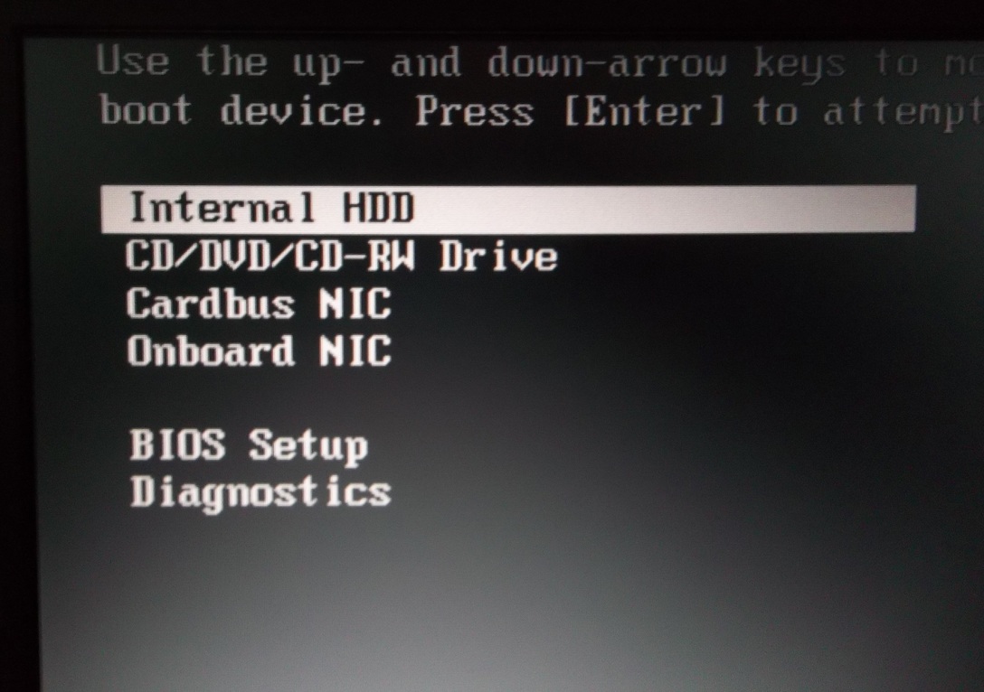

OK then we need to find out what manufacturer your hd is then for sure.
You can get the model number from the bios if you know how to enter it.
I know that you hit F12 at startup to enter the menu but am not sure where to go from here(2nd pic)
#77
What you want to is to highlight the Bios Setup and then click Enter.

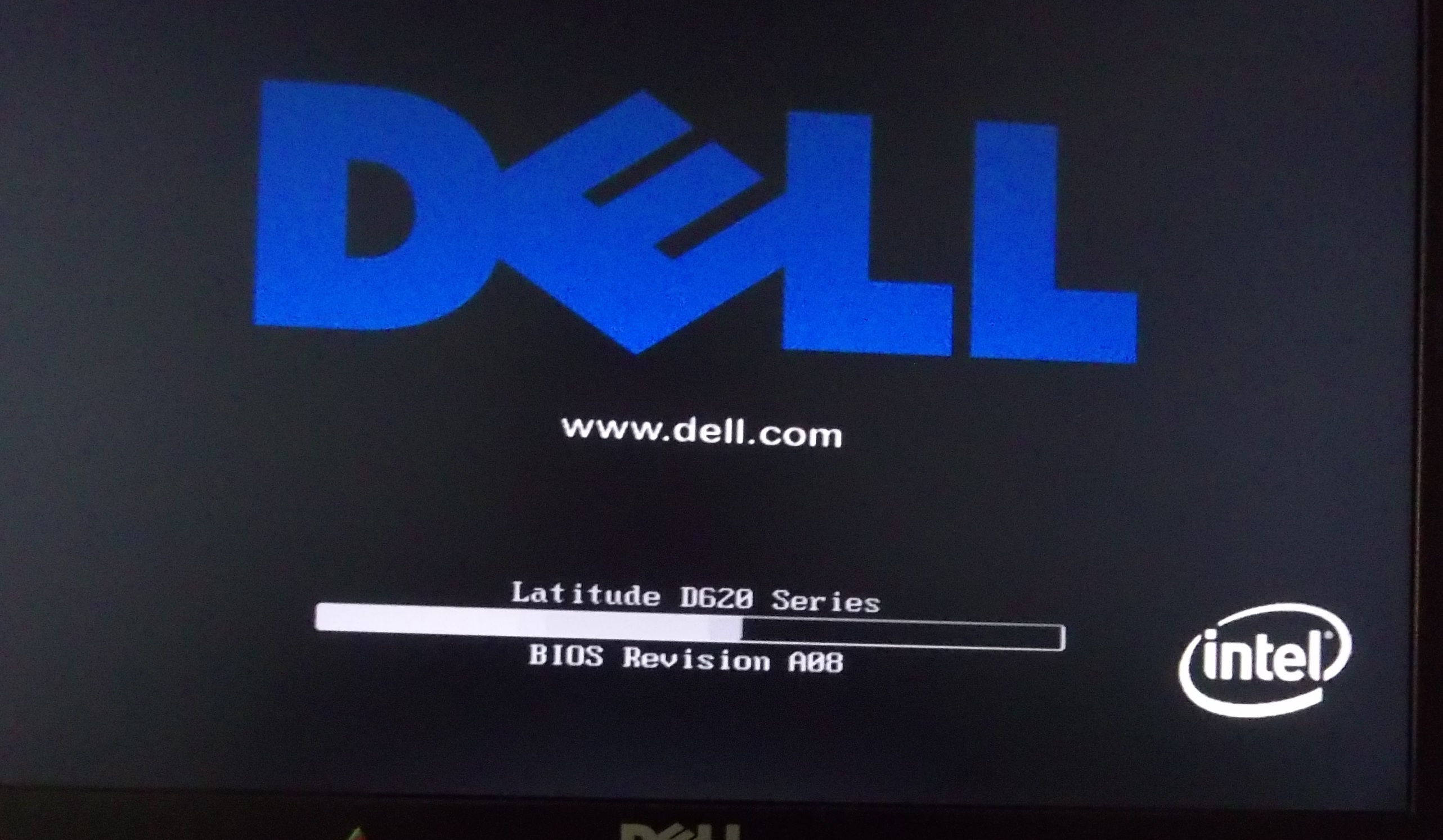

Other then finding the service tag # and finding out what I already know (that my PC is a Dell Latitude D620) and some other info. I'm not sure I found what you need, So can you please tell me what I should look for in the BIOS setup menu?
#79
Look for the Hardware tab at the top or look through the different areas to find where it identifies your drives.

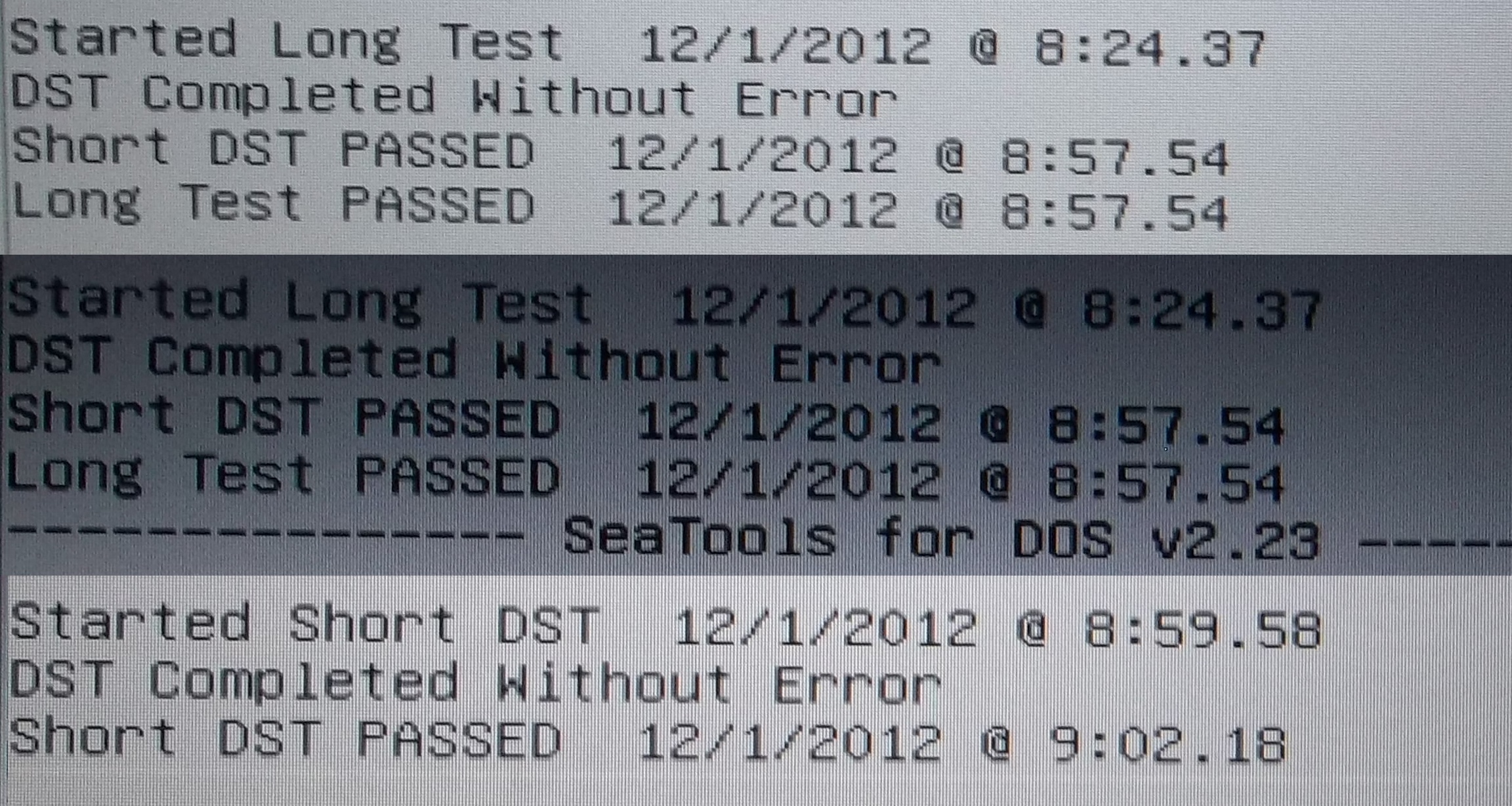

ok I got it downloaded to a disk and ran it on my PC...
#83
Did it find any problems?
#84
LptpUser13
LptpUser13
  • 74 posts
This is what the end showed(the first is the long test & the other 2 are from the short test), I have the rest of the results if you need them.
#85
OK it looks like the hard drive is good then.
