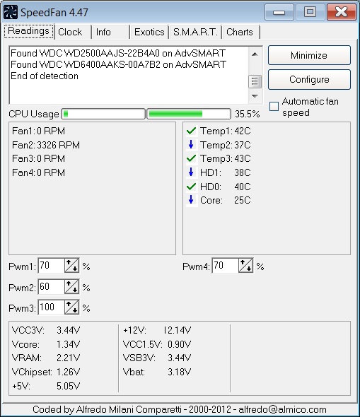

Download Speedfan and install it. Once it's installed, run the program and post here the information it shows. The information I want you to post is the stuff that is circled in the example picture I have attached.

Temps are good in Speedfan but the volt reading are inconclusive. So Phillpower2 has more info, do please run HWM, and post the results.

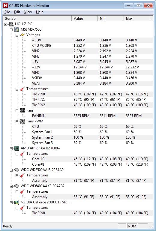

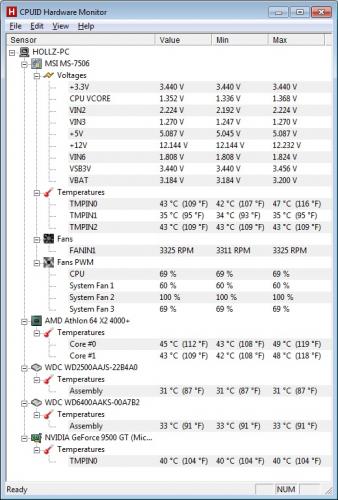

As requested, here is a screenshot of HWM and the url to speccy (neat program, it's so detailed!)

  • 25,130 posts
Sorry for the delay getting back to you Hollz.
Thanks for providing the information requested by colleague iammyky (thanks for stepping in Michael :thumbsup: )
Temps and voltages are as they should be but something is going on with core #1 of your CPU as is shown in the CPU usage panel of your Speedfan screenshot, there are various reasons why this may happen and it can be hardware, software and sometimes malware, if it looks like it could be the latter you may need the assistance of the experts over on the malware forums but hopefully not.

And just a question, what exactly was giving you warning signs in the SpeedFan SS I posted? Just curious as to what number you were looking at exactly, I wasn't sure. And yes, I do believe that was idle. I did another test and the numbers were similar (wasn't sure if I was running the windows essentials virus scan at the time, that would have been the only thing).

If you look at the two CPU usage bars core #0 is showing minimal usage but core #1 is suggesting that it is very busy.
