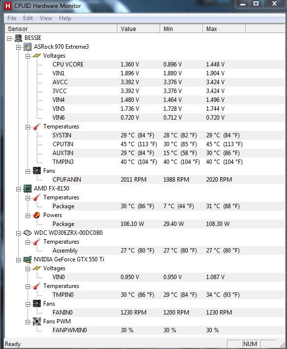

Here is a screenshot as requested after about 4 minutes of a re-encode.

Hi.
Thanks for the update. When downloading programs, please decline any bundled software or add ons like search bars. Do not use any offered auto fixes.
Checking first for your temps and correct stable voltage.
HWMonitor results are not very conclusive, not all the volt readings have been detected.. Please download Speedfan. run the same as for HWMonitor and post a screen shot of the main window.

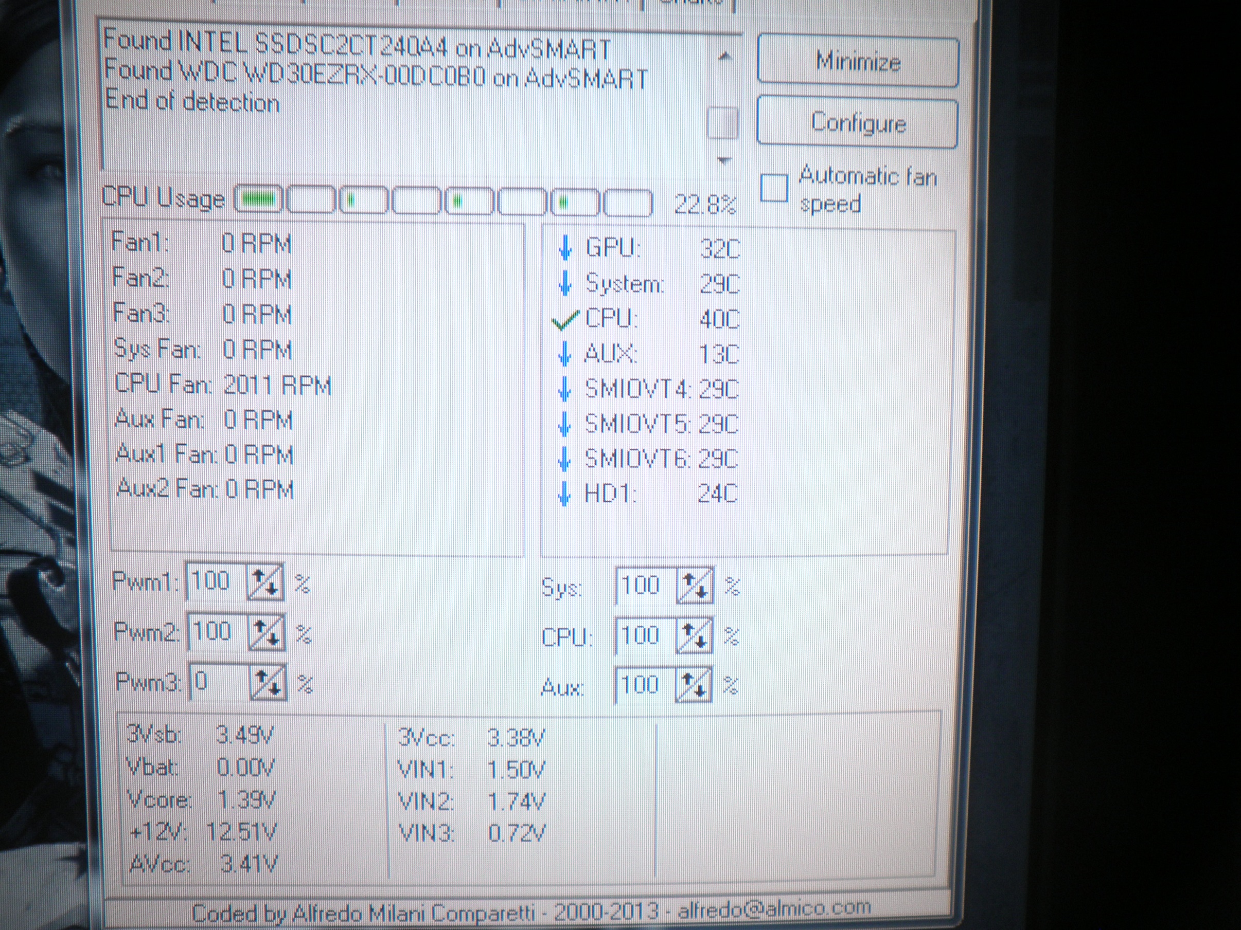

Also this I had to take a photo on a separate camera as it had frozen again

Hi.
Sorry for the long delay. Thanks for the update. My questions and instructions may be rather basic but this is only to ensure that beginners can follow along.
Your temps and PSU appear to be OK. Other most likely hardware causing the freezing are the GPU and Ram. You also have a lot of programs starting with windows, also services, auto updates and the SSD has not been optimized.
