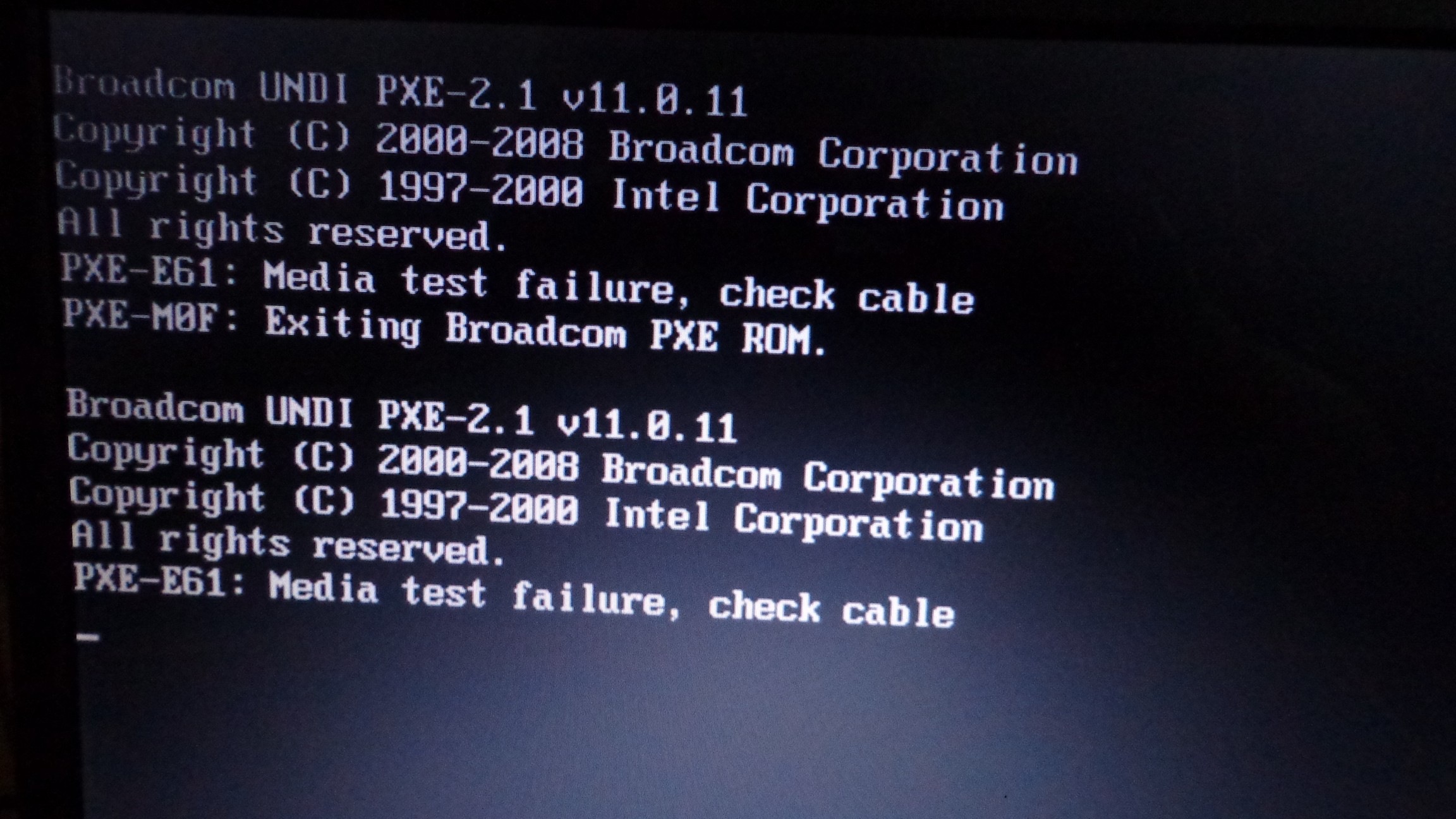

I got this result when I tried to boot from a CD i burned. I mistakenly burned the .iso file as well into the disk. Had this something to do with that?? :(
Jasmyne
Jasmyne
  • 2,010 posts
Let's make sure the network booting is disabled in BIOS as it can cause the PXE errors.
  • Enter BIOS setup on start up by pressing the F2 key repeatedly at Lenovo screen.
  • Under Boot tab in BIOS setup, set PXE Boot to Disabled by highlighting it using arrow keys, press Enter, use arrow key to highlight Disabled, press Enter, then under the Save and Exit tab, highlight Save and Restart, press Enter.

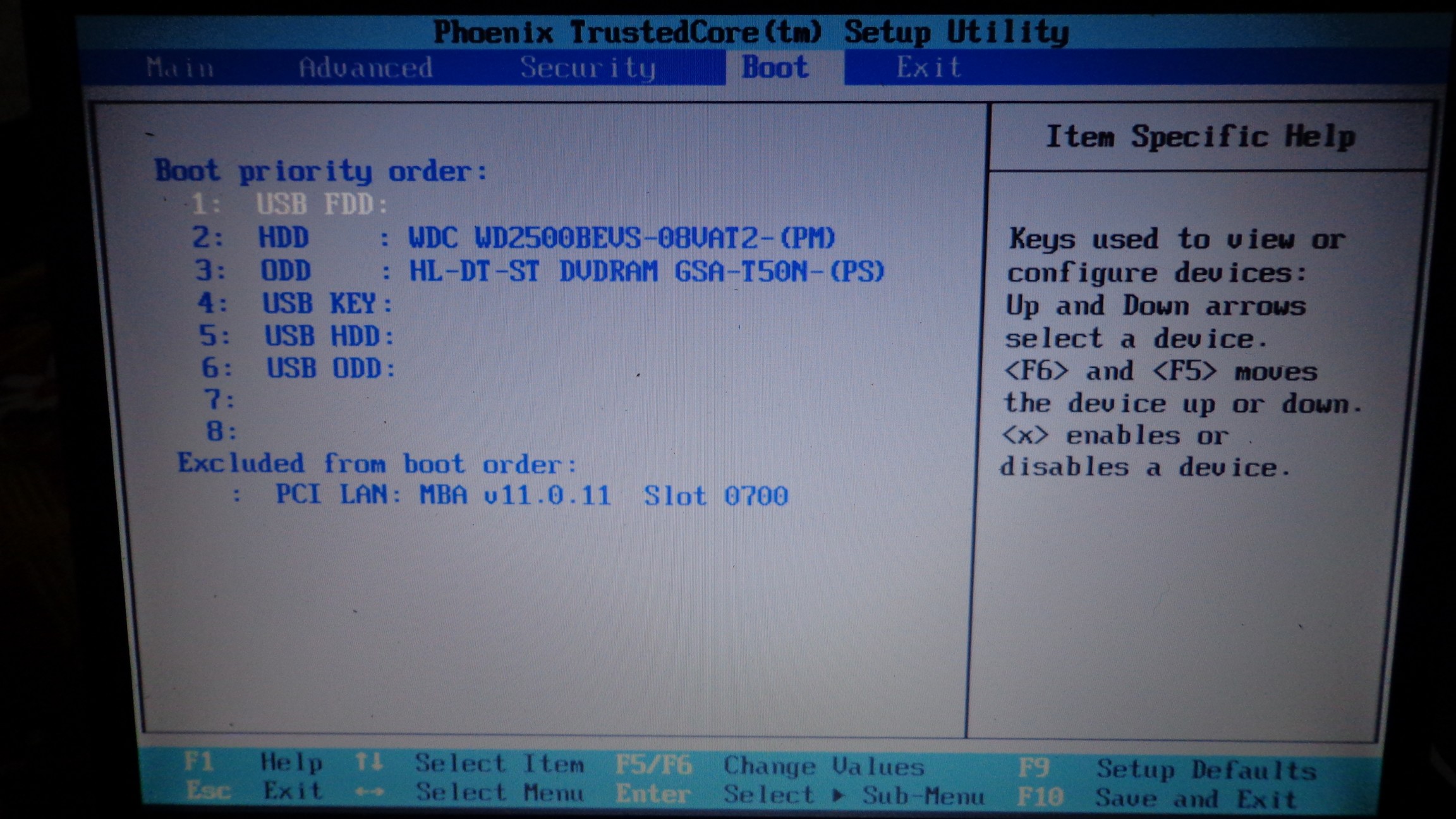

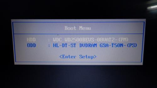

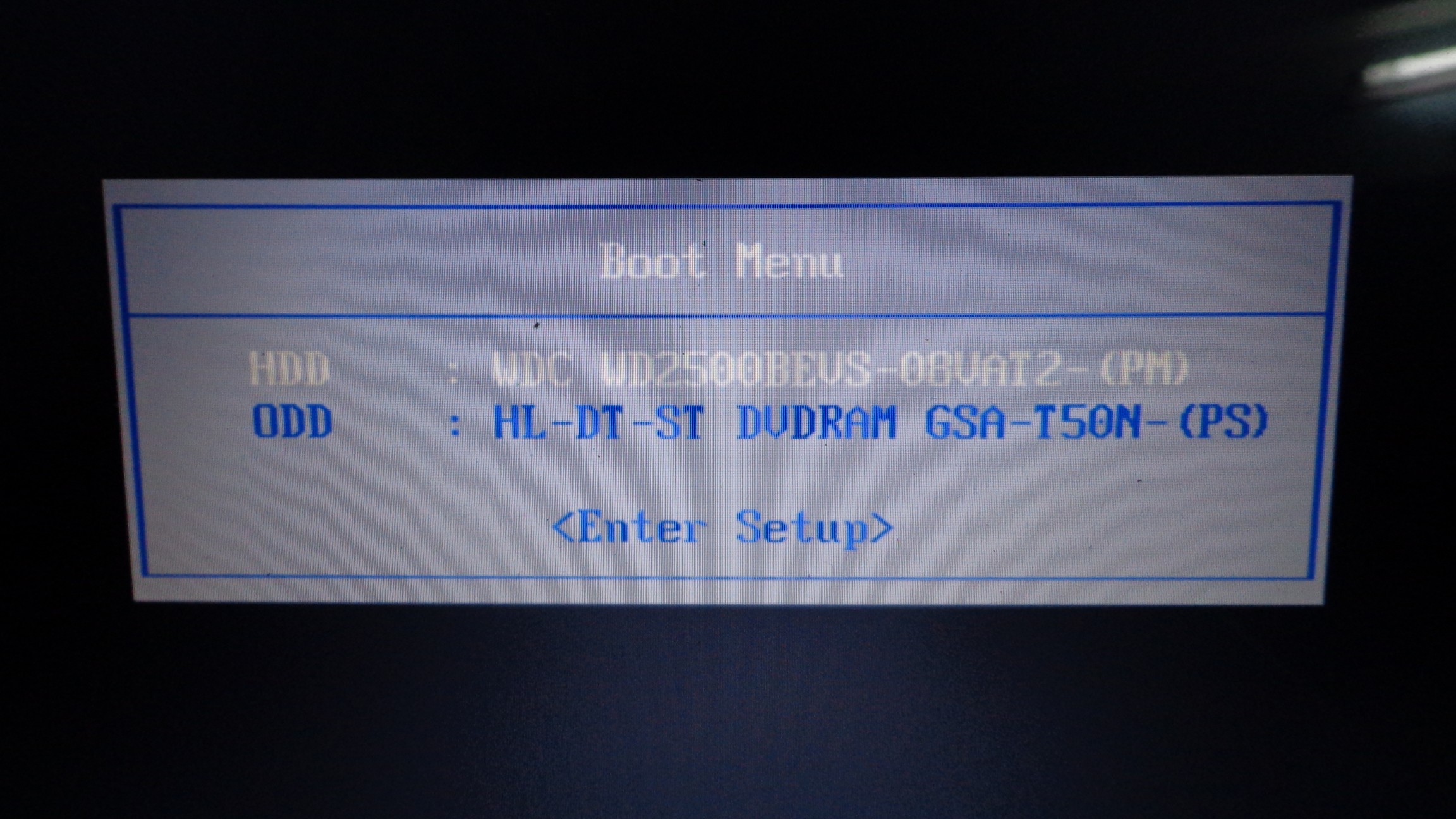

qwerty321
qwerty321
  • 48 posts
I removed PCI LAN from the boot list as you can see in one of the screenshots
Jasmyne
Jasmyne
  • 2,010 posts
In the boot order, ODD needs to be first to boot from a CD. Please move it to first in the list and try to boot from the Recovery Console CD again.
