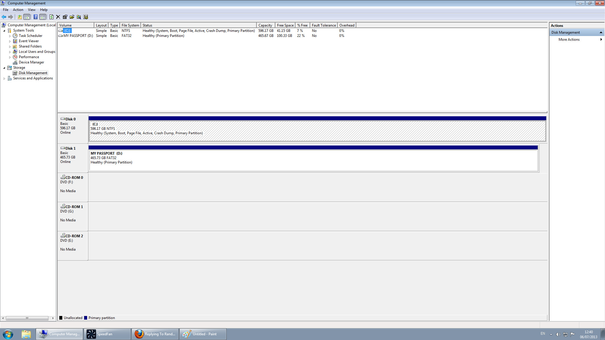

Here are the screenshots

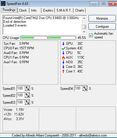

*NOTE* i run a corsair Hydro series water cooling system, this may effect the speedfan readings

Things of note are high CPU usage, incomplete voltage readings, odd temp readings and low free storage space on the HDD, please see my canned text below, can you run HWMonitor for us so that we have a comparison to Speedfan, I suggest that if you don`t uninstall Speedfan right away that you uncheck the Auto fan speed box http://www.cpuid.com.../hwmonitor.html
Please note that you must always have a minimum of between 15 and 20% of a HDDs overall storage capacity available as free space or you risk the data on the drive becoming corrupt or in a worst case scenario mechanical failure of the HDD itself.
The above can render a computer inoperable if the HDD concerned has the OS on it due to the MBR (Master Boot Record) becoming damaged/corrupt, please see information @ http://pcsupport.abo...sterbootrec.htm

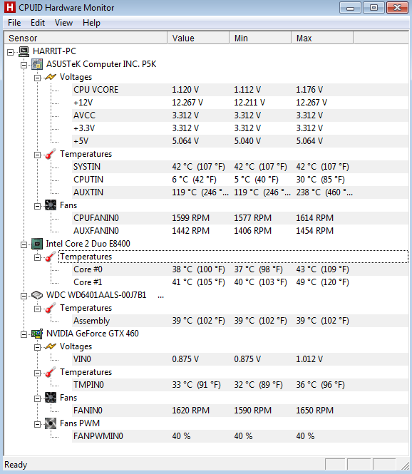

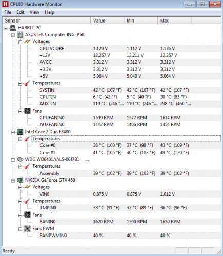

Heres the HWmonitor results.

There is just the high AUX temp reading looking untoward in HWMonitor and that could be an anomalous reading caused by the MBs own monitoring software, we can double check later, did you uncheck the Auto fan speed control box or uninstall Speedfan.
Good idea to free up space on the HDD right away, be sure to use any uninstallers provided for any relevant program as this helps avoid stray files being left, post back when you are done and I will provide details to help you tidy and free up further space on the HDD.

Can you post an updated Disk Management screenshot for us please.
